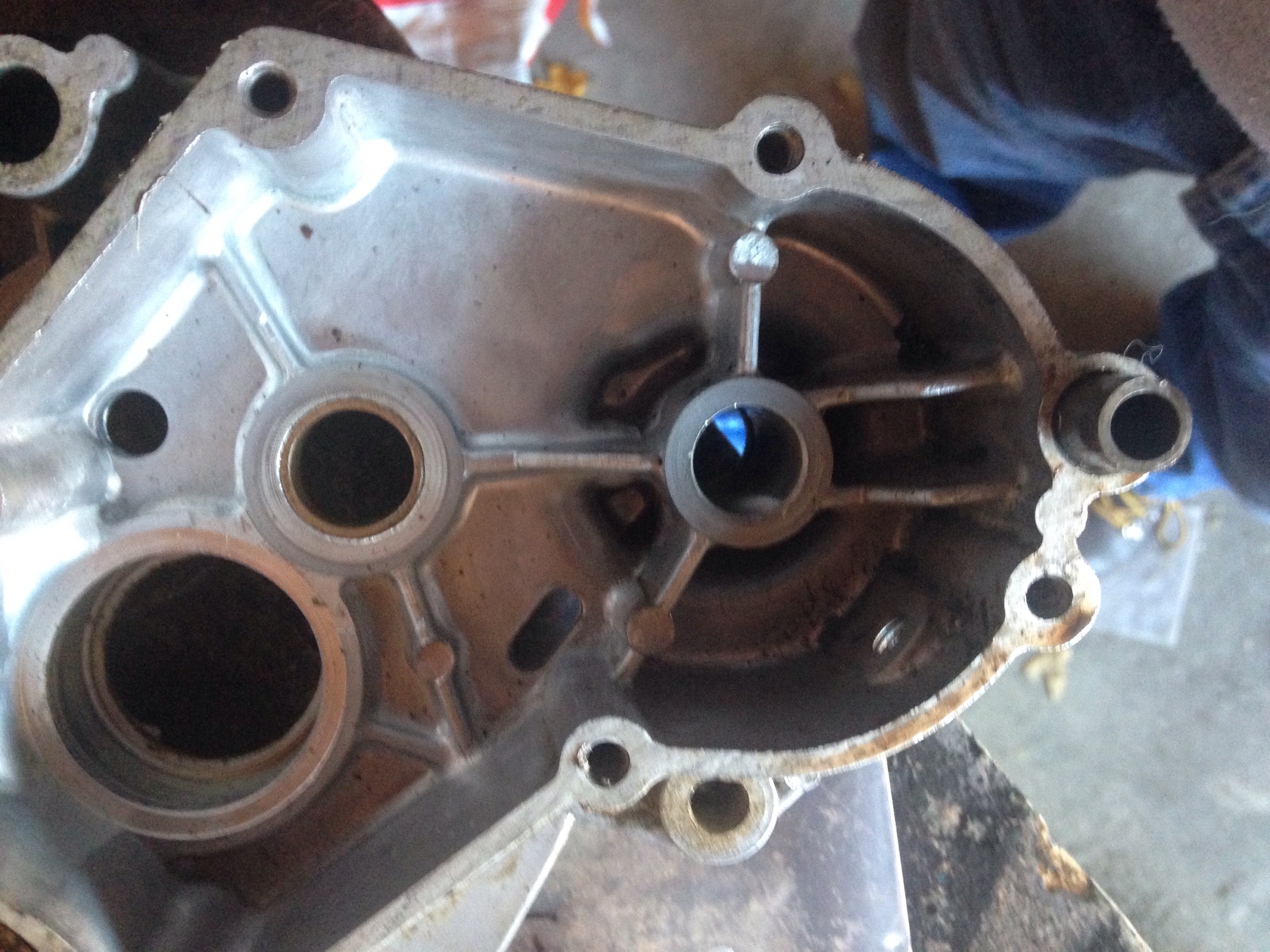

OK. Went out and got my second set of cases & another kick shaft. I saw on the second shaft where the clip is mounted over the narrow end of the retainer. also noticed a space, which looks basically like two ridges, at the back end of the right case. This space is just a little bit wider than the loop end of the clip. Is this where it is supposed to be inserted? If so, I've been missing that all along! It's closest to the back casing bushing, close to the 6:00 position in this photo. Is that where it goes?

I think you finally figured it out. Without the loop between the 2 ridges running out from the dowel alignment locator pin, it does what you describe. It works once and thats it. I made the same error on a 250 engine once and had to tear it out. Much more work than a Wombat engine removal.
Re: Totally Frustrated!!!
Yes, I think so! Boy I hate being stupid! I went back and read thru my manual again and it said exactly the same thing! I was just reading thru it too fast, a bad habit I've never been able to correct! If I would just slow down and take my time and read more carefully/accurately, I wouldn't get myself into nearly as many jams! Oh well, live & learn, live & learn! I will let you all know how it turns out. One thing's for sure. I should be able to do it in record time this time! ; ) Victor
