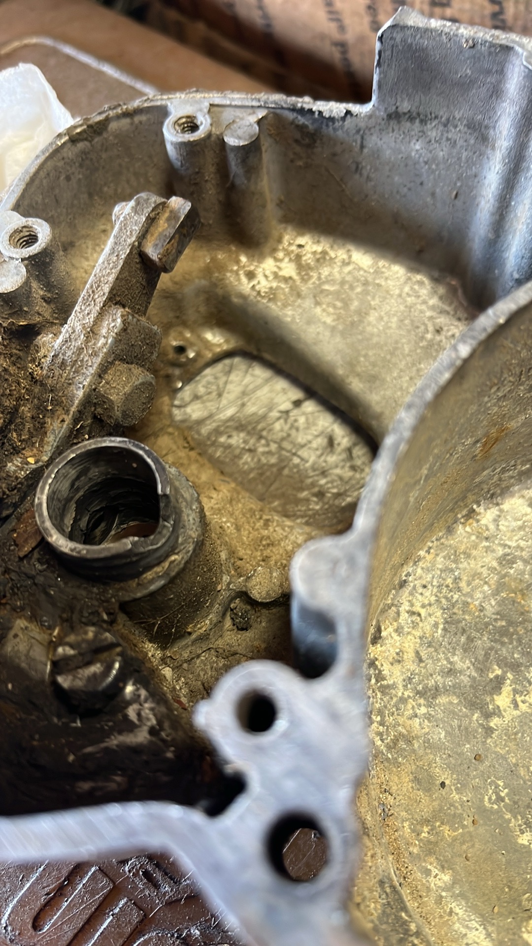

You guys! It was the shift cover!!! I substituted a different Wombat shift cover and no more gear slippage in any gear! I was really beating a dead horse with this one!!!
A great big Thank you to Captain Ed and Olddogs for pointing me in the right direction! I hope I can rebuild this shift cover properly so it can still be used! As in the words to an old Barry Manilow song, “….somewhere down the road…” :ugeek: Victor

Now I have my Blue Wombat. This one won’t shift at all, won’t even go into gear. First thing I will do is remove the shifter cover and try another known good. If that solves it, I will then try a shift cover rebuild. I have all the parts needed.

Ed, I figured it out today. The foot change ratchet plunger spring washer fell out when I was putting things back together. So the plunger spring wasn’t making the plunger maintain pressure against the ratchet.
I found another washer and installed it between the spring & the zurk fitting. That was all it took. That washer is so small I just missed it falling out. I’ve ordered a couple of new plunger springs and 5 new washers for spares. That will hold me over for a while! :ugeek: Victor
