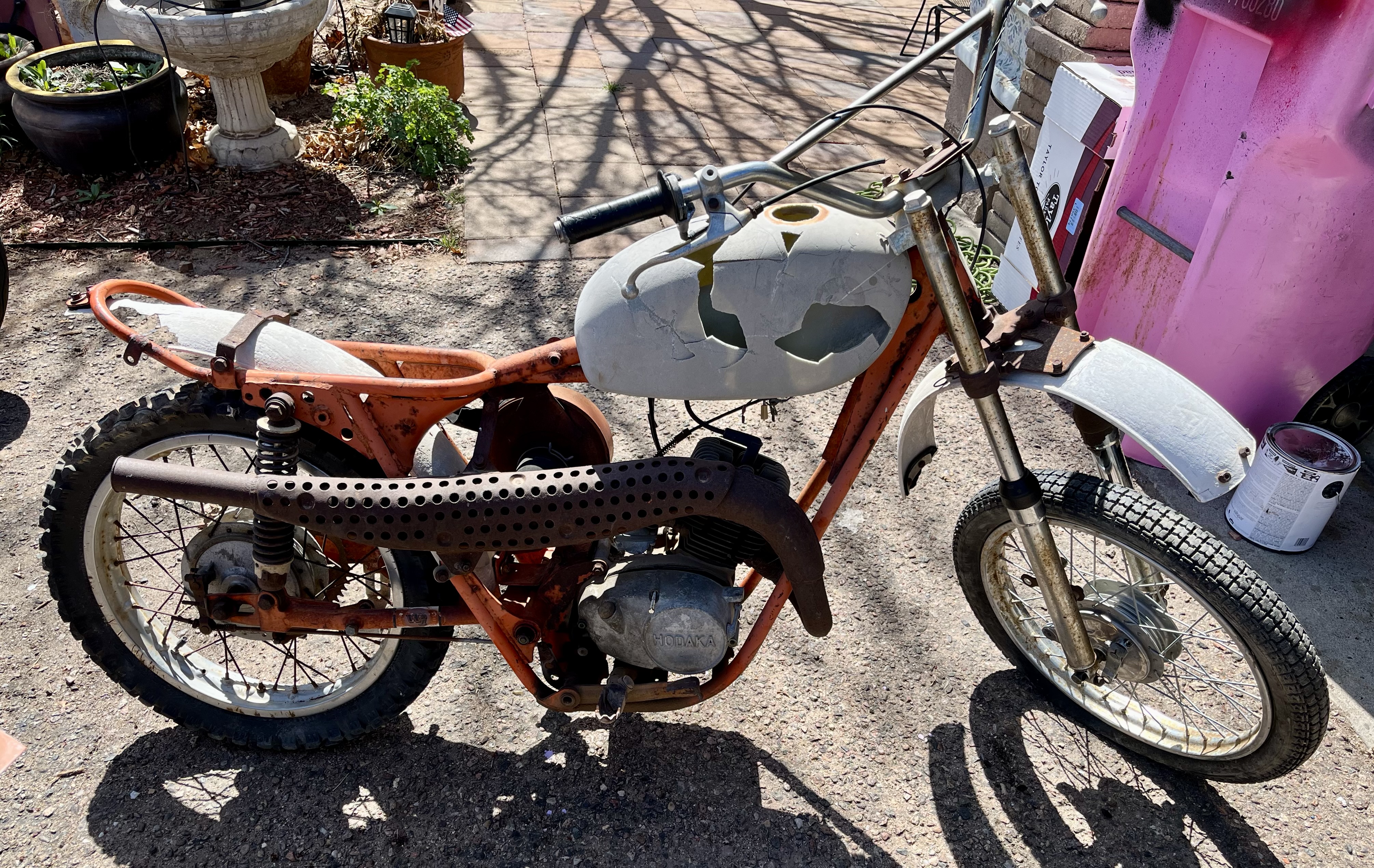

I picked up a 96 Dirt Squirt at Hodaka Days and l’m getting ready to get her fixed up.
It got it as shown in the picture. Pretty complete except missing cylinder, head and carburetor. I picked up a good head and cylinder at Hodaka Days.
The engine number that came with the bike is P-53289. According to Hodaka Parts, Inc. the starting engine number for the model 96 is P-62366. So it looks like I have an Ace 100 engine?
My question is; what are the differences in the Ace and Dirt Squirt engines?
Thanks.
Thanks.

Re: 96 Dirt Squirt engine questions
Thanks dirty-rat
I was able to confirm from the info you posted that the gears 1-5 are ace 100.
What puzzles me is the primary gears, I’m counting 17-63.
Thanks guys.
I think I will use the gears I have. I will be taking the engine to Hodaka Ron in the next few days for him to work his magic. Ron has a set of cases with the correct Dirt Squirt numbers that we will use.
In the meantime I have started cleaning up parts and preparing for painting.
This is my winter project. It should be ready for next Hodaka Days.
