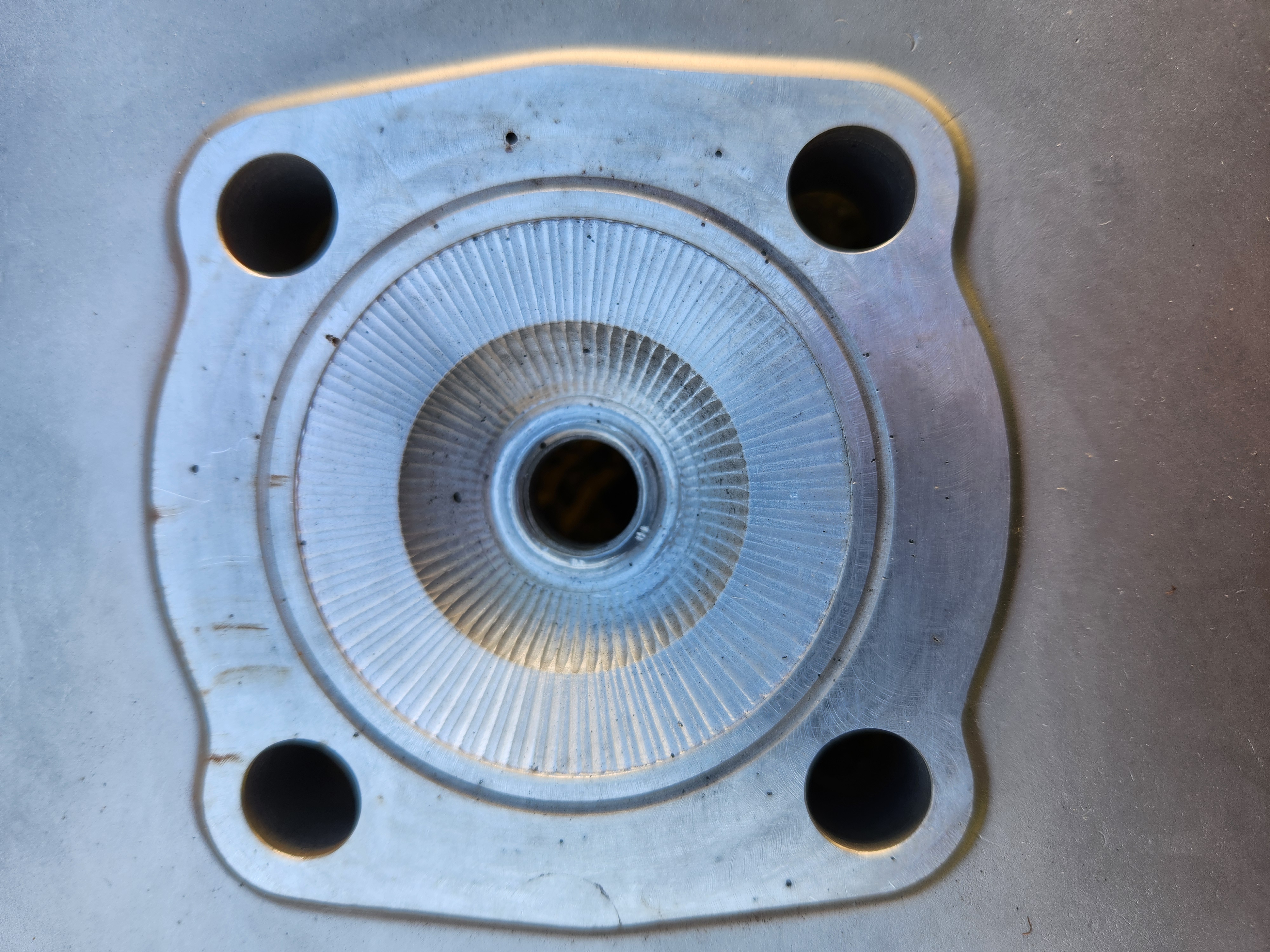

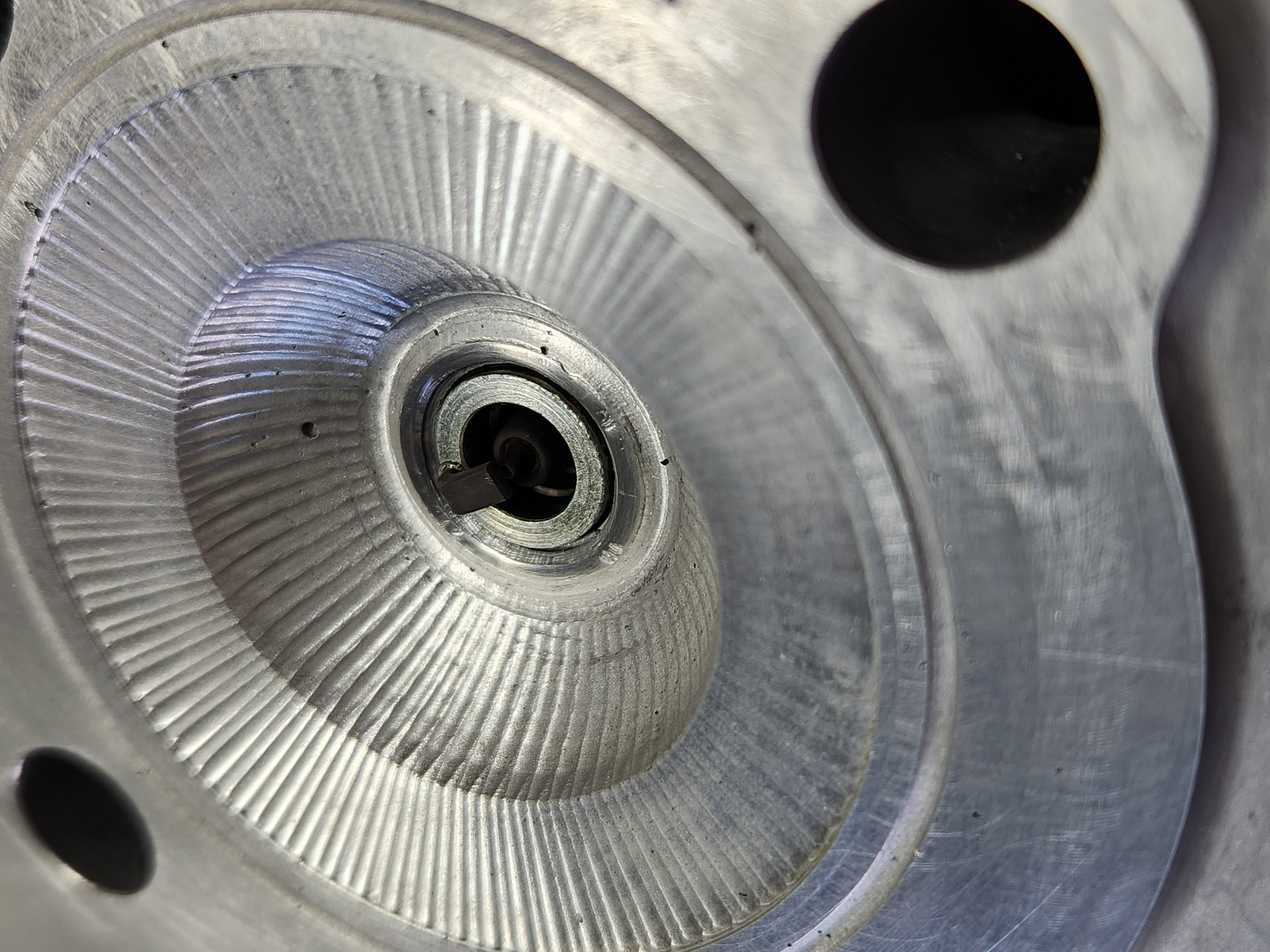

Re cutting the combustion chamber to a more modern design yields great results at modest cost.
Re: All opinions welcomed
That looks like the Singh Groove modification upped to the Nth degree. Singh Grooving would typically be four kerfs placed like compass points (centered bowl chamber) and their function would be to increase flow of compressed gases into the squish band for more complete combustion,
With an offset combustion chamber grooving would likely only be effective on the exhaust port side of the combustion chamber,
In the example shown in the photo I suspect that the total surface grooving would soon be rendered ineffective by carbon buildup. Post modification compression ratio would be a tad lower too. Also the grooving within the combustion chamber bowl doesn't appear to have a purpose if it's expected to direct flow to the squish band at any rate, although it might have a function that I'm not realizing.
100cc Road Toad head. Combustion chamber re-designed and machined for 125cc Combat / Super Combat engine. Late model 100cc heads share the same bolt pattern and casting as the Combat / Super Combat Wombat. The 100cc combustion chamber is much smaller and leaves more material for machining and remaining mass. Super Combat heads can be modified this way but less mass will remain. Modern squish with .8mm piston to head clearance. Total combustion chamber volume more centrally concentrated. Combustion chamber volume a few cc's less than Super Combat head. Chamber designed for premium pump gas. Chamber design less detonation potential and more efficient combustion.
I have two of these heads and the machining is impressive. Chamber volumes are exactly the same. You can barely feel the "groves" when running your finger over the chamber. Not sure what purpose they serve .. it is a secret. One installed on a reeded Combat Wombat. Engine runs cleaner / crisper. More torque and able to run in higher gear where before would have to down shift more. Operates better all the way around. Running a little less timing as combustion process is more efficient. RK Tek performed these modifications and well worth the expense....$150ish. Even Harry Taylor's instructions included cylinder head modifications.
