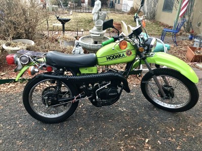

Victor ..... our tanks are different, mine is a 76, maybe a newer style? Also different are the kick starters, mine does not have the loop in it, just a straight arm. For some reason I can't figure out how to post a photo. When I click on the add a photo icon, I just get an [img] showing up. I often think it could use more stroke on the down kick, starting engagement point seems a bit low.
Re: Road Toad contact points setting puzzle .....
To add a photo go to "Full Editor & Preview" box on bottom of Reply. Click on it and write your post. Then go to the bottom and you will see a box with "Options" and "Attachments". Select Attachments and it gives you a box that says "Add files" Click on that and then locate and select the file (photograph) you want to add and select it. The file should then show as loaded. To verify, hit Preview.
As for your tank, the later Road Toads had a more hard edged tank. If you go to hodaka-parts.com and go to the library section it gives the specifications for all the Hodaka models, which includes a good photo of each.
Yes. The 1976 is a Model 02 Road Toad, while mine are 1975 Model 99 Toads. 1976 was a tank change year for the Hodakas, leaving the toaster tanks behind and going to a more coffin shaped tank. The 02 Road Toad specs for the carb are what I use for jetting & tuning. This was recommended to me in the past.
