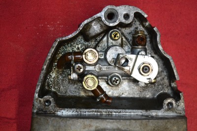

Re: 03 Wombat Injection Pump
Here are a couple of photos of the one I have.

We all like pictures, so here is a follow up to my oil pump topic. The pictures are of the pump that is leaking injector oil. I didn't take the pump fully apart as I just wanted to get the cam shaft out. In order to do this the bottom plate has to be removed and then the cylinder and spring as well. Then the cam comes straight out without having to remove the cable return spring or the part that cable connects to. I did find a rubber O ring as you can see, and I suspect that is where the leak originates. After some googling I found that partzilla lists and has parts for injector pumps from the 70s. So I took a chance and ordered an expensive o ring to test my theory. I would like to thank Dirty Rat for going out of his way to ship a replacement pump from Florida to Washington state. Thanks again !
