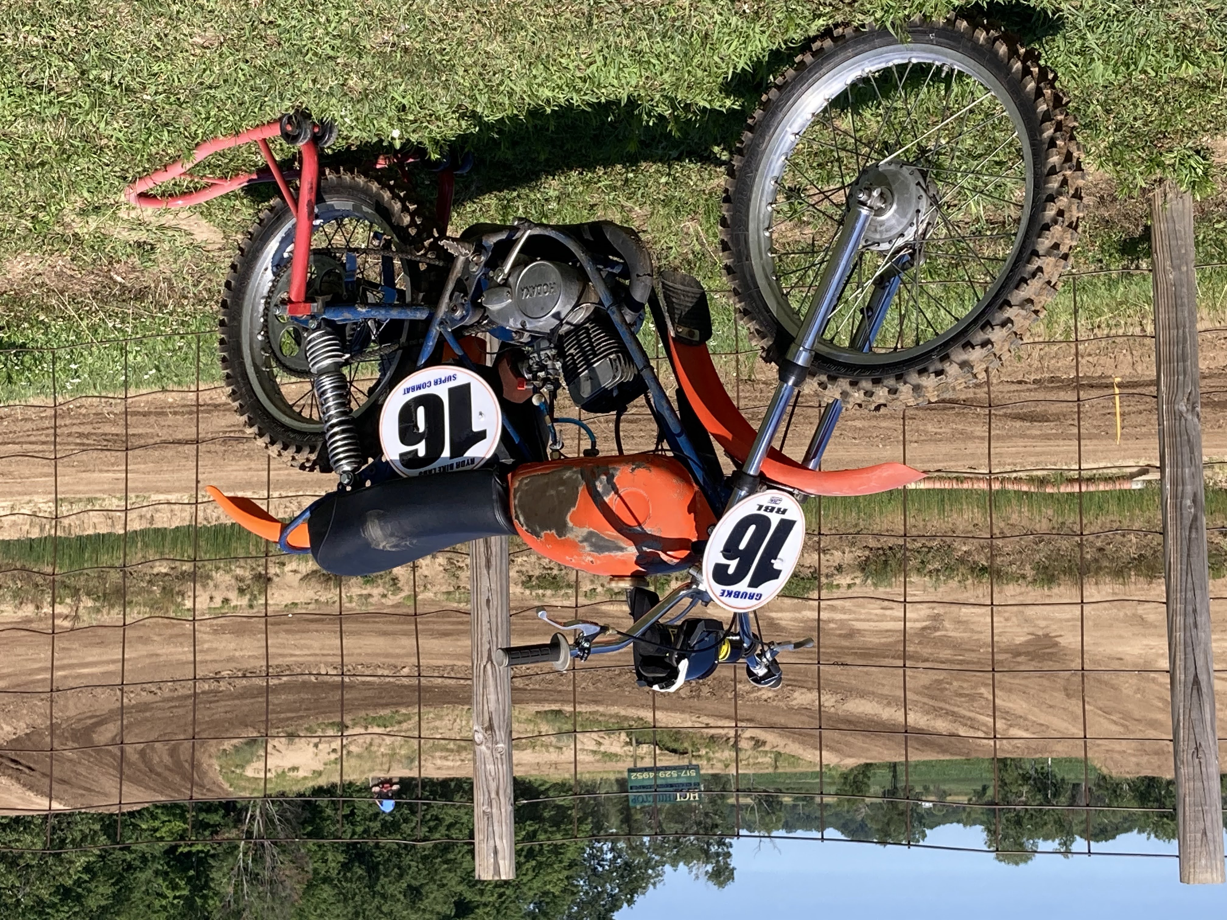

Hello fellow Hodaka friends! New member here. Thanks for having me. I am in search of a Super Combat motor or Super Rat motor. I have a 97 Super Combat chassis, but the PO installed an ACE 100 motor. My son and I are having a blast racing VMX with our older bikes, but the ACE 100 motor is way out-gunned on the track, to say the least! Thank you all for your help!! -Rick
Sorry about the photo being rotated upside down. Even when importing a rotated photo to correct this, the image is still upside down. I must be doing something wrong :-(

Photo shows properly when ttouched to show separately.

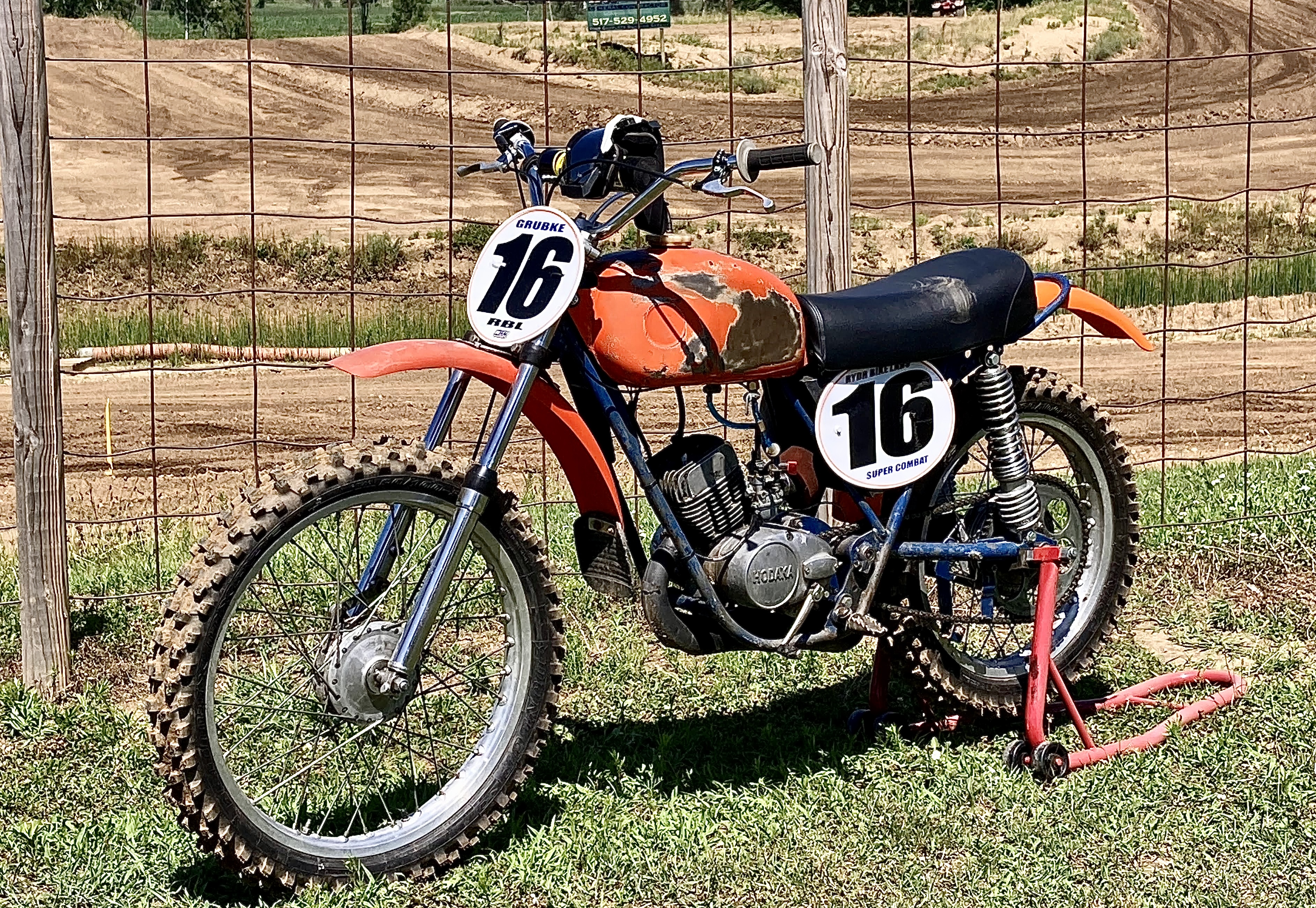

The model 98 rat motor used in the model of the bike in the photo is entirely different from the early model 93 SR based on the Ace 100 motor. The later 100 had a CDI ignition, reed valve and a close ration transmission and was more closely related to the 97 Super Combat engine. Both 100 engines will fit, but your local racing organization may have rules that dictate what model you can use. I have raced both 100cc models and the late model is far superior.

Your bike frame is either a G or F model as they are almost identical. Yes the L motor is the later model. Your pipe has been modified to fit an Ace motor so an early Rat motor is a direct fit. A 93 top end is a direct bolt on and with the bigger carb and porting can be made very competitive. The Ace lower end is not much different. The 98 Rat and 97 SC used a flange mount pipe held on with springs versus the big nut. You would need a late model pipe or the skills to modify the one you have. These pipe are pricey when you find one. You could probably do a 93 Super Rat conversion of your existing motor for the price of a late model pipe. HPI has the parts available to support any engine you choose.

I copied you photo, cropped it a bit and added it back into this post. :ugeek: Victor
