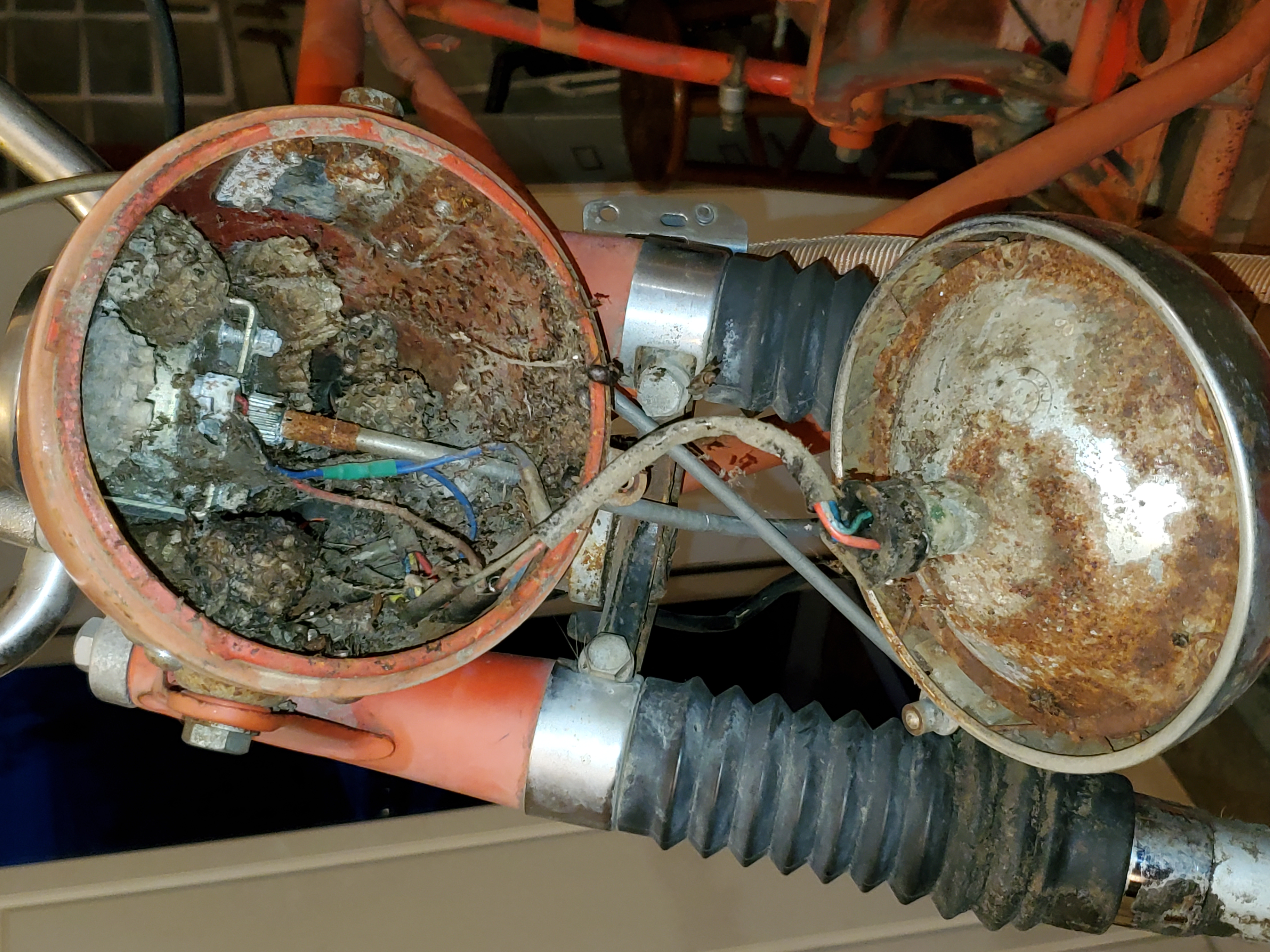

This is what i found when i opened up the headlight bucket. I hooked the light up to a 6 v batt and it still worked! High and low beam!
