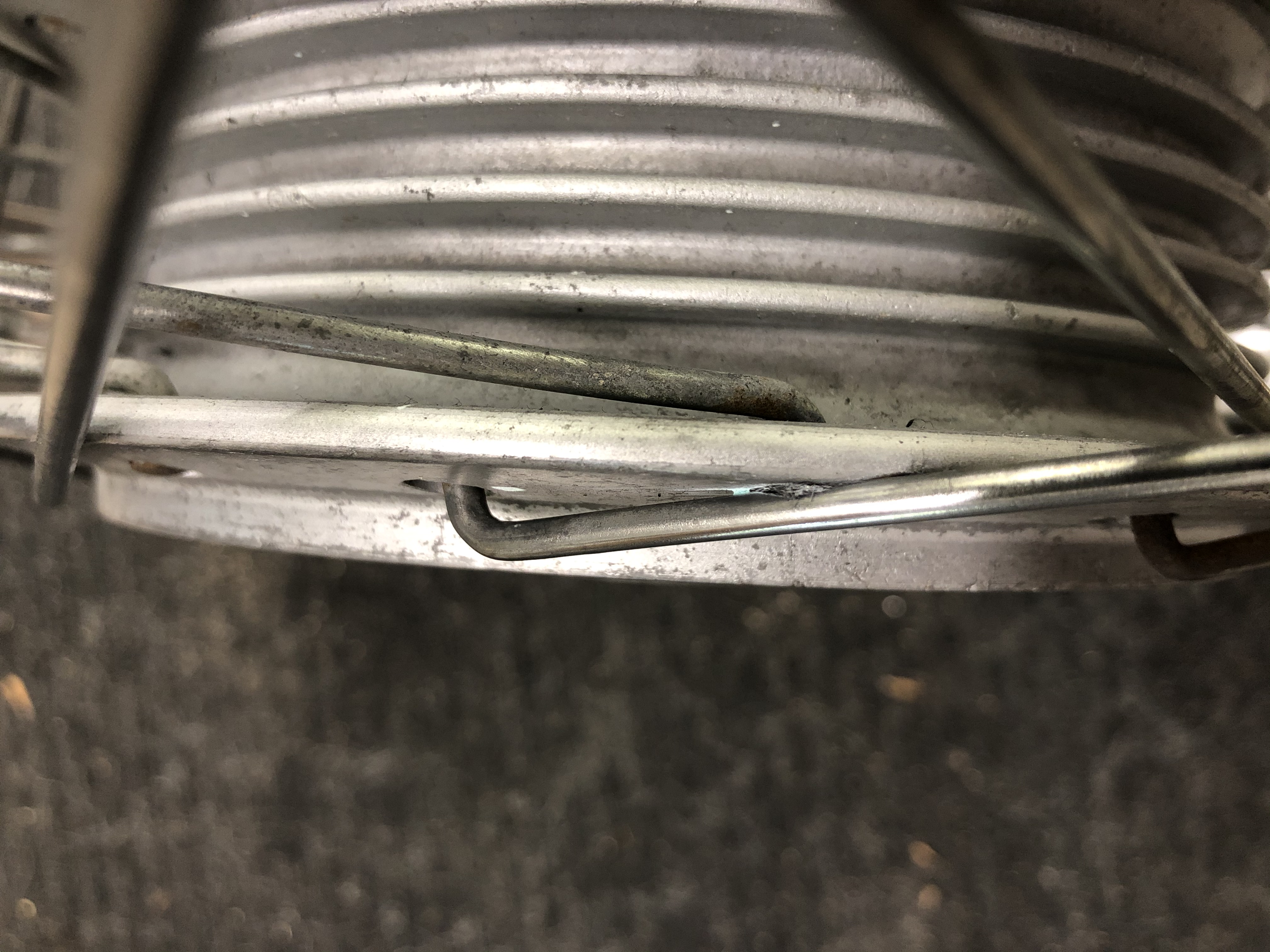

I had 1 broken spoke. It’s an outside spoke with a 90 degree bend. A friend sent me combat spokes. They didn’t work. Terry sent me one and they were the same. The rusty spoke in pic is the one I need. Has anyone run into this?

While I don't have a solution for your situation . . . it is clear that the two spokes in the photo are for different uses.
The old spoke has a slightly open bend AND a "long reach" at the head.
The newer spoke has a slightly closed bend and a "short reach" at the head.
One thing to keep in mind is that a given spoke removed from a half-century old wheel may not be the same as the spoke the factory installed at that location. (Not saying that is the situation here . . . but it would be good to review that possibility.)
Re: Rear spokes puzzler for Combat
. . . and, um, Hodaka spokes were stainless steel. Another point to ponder.

I can not run that short spoke thru the hub. It acts like the hub is too thick and it won’t make the bend.
What I did was try an inside spoke with a angled bend. Like roughly a 45 degree bend.
I was able to fish it thru hub and get nipple on. But there is no gap by hub like it supposed to. It lays on hub tight. I’m having a hard time explaining this so look at the pics that I’m sending. First one With blue tape is the one I put in, second picture is what it supposed to look like.
I’m wondering if I’d be OK running it that way.
