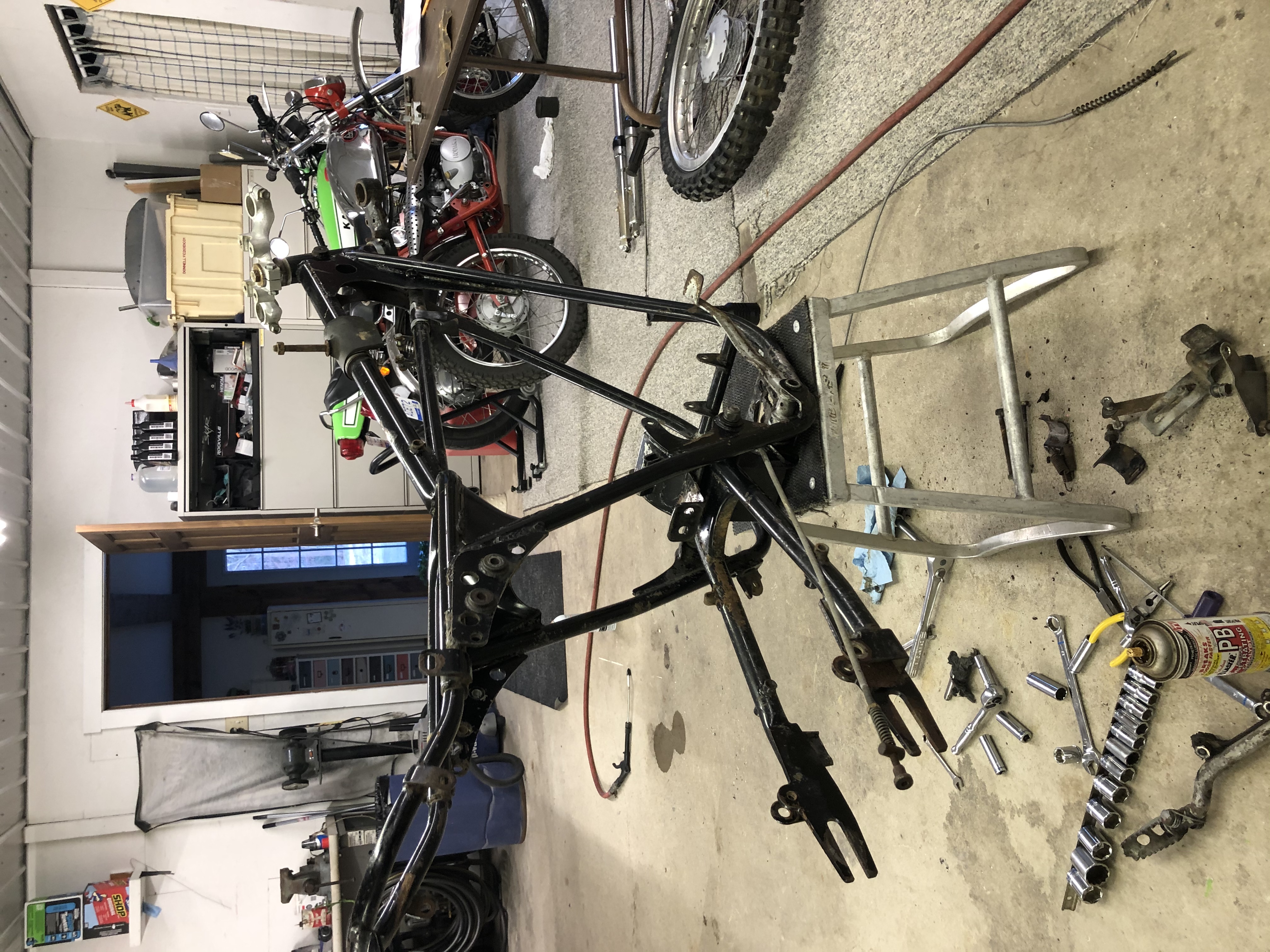

Had some time this weekend for tear down.
By the lack of response, are combats hard to get parts for??
Tank, fenders, bars, chain guard, kickstand.
Question...can the cushions in rear hub wear out?? I have some slop when I grab sprocket and rock it back and forth

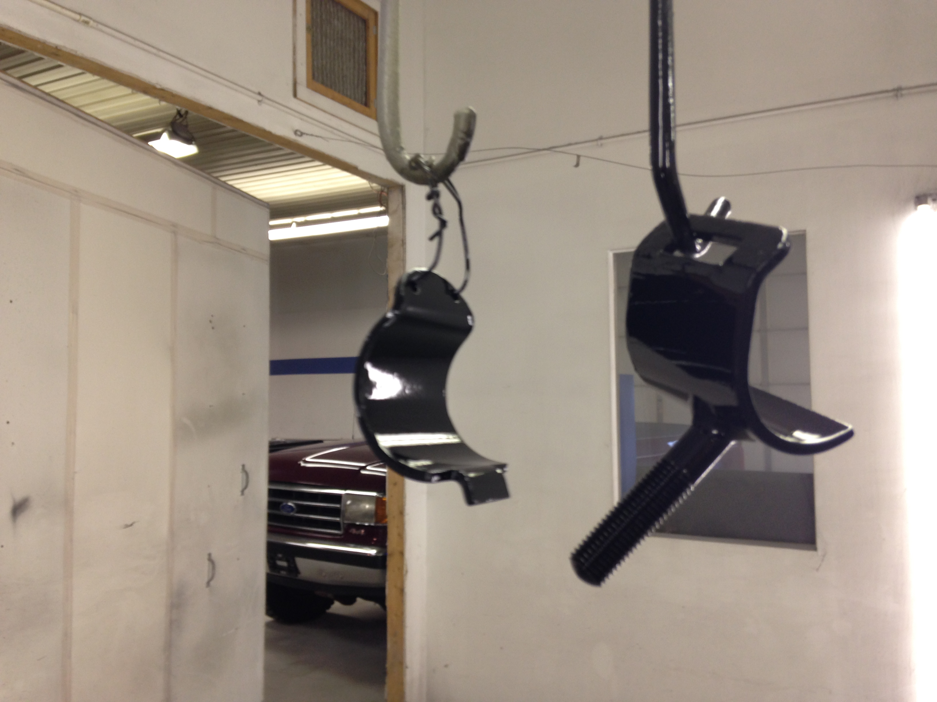

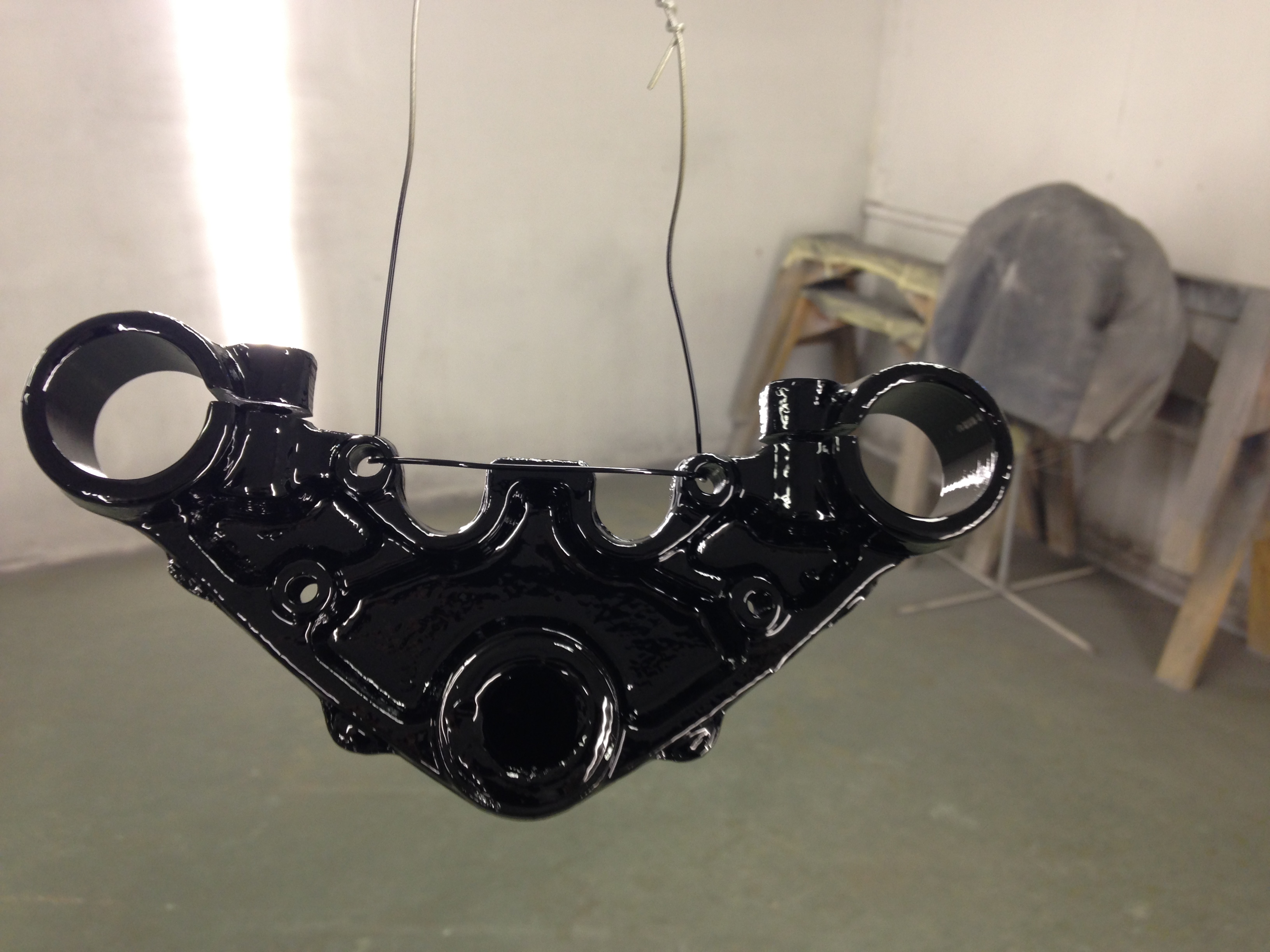

Off to sandblaster Wednesday. It’s getting painted with a single stage urethane paint.

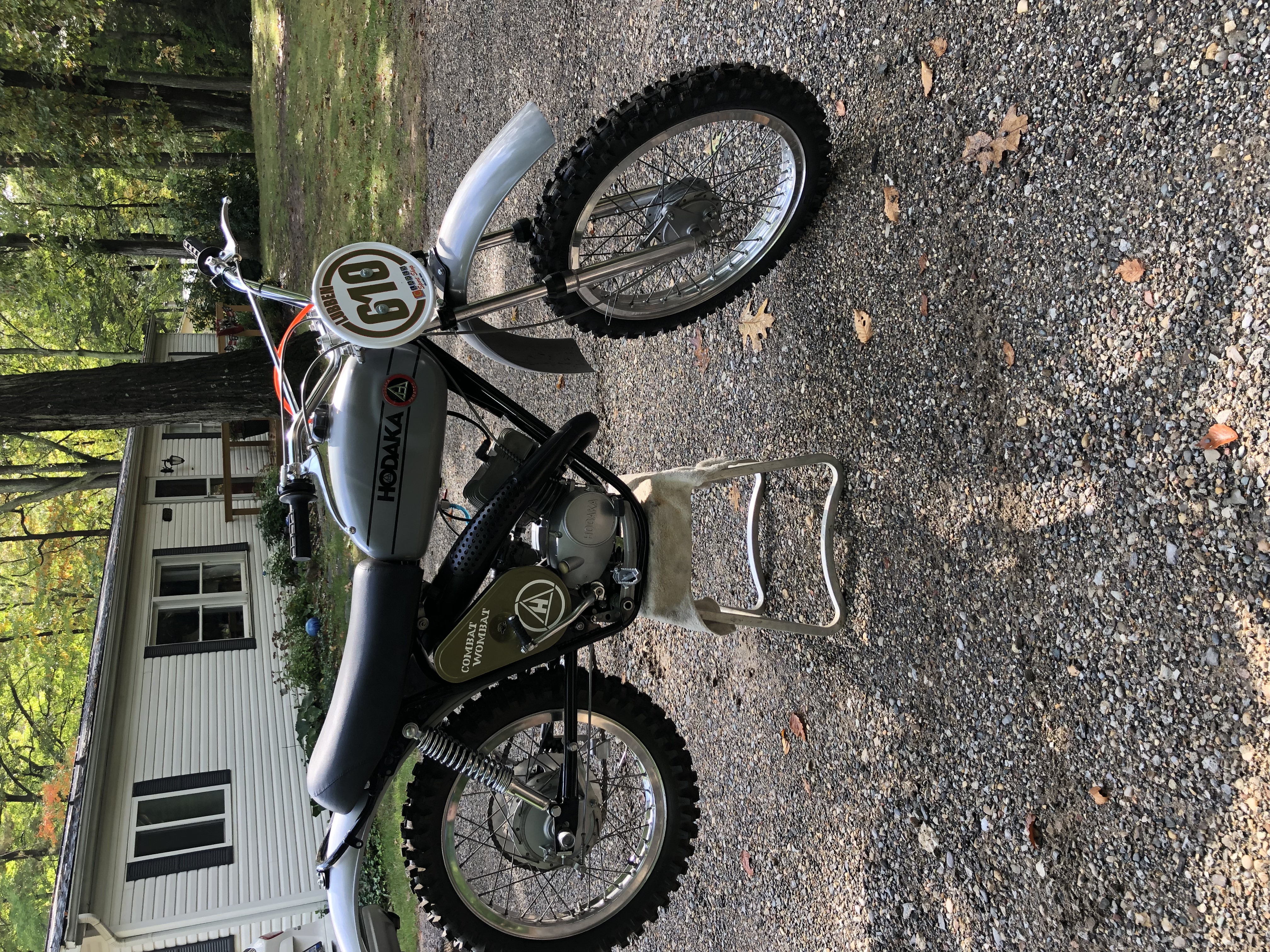

Getting close to being finished. Need to work out a few things.
1. Fouling plugs regularly. Running B9HS plugs. 32:1 fuel mixture. Stock jetting. I’m considering going to hotter plug. Yes or no??
2. Forks clunk hard at full extension. I added extra oz. of fork oil. So now at 6oz. Of 15WT. Still clunks. Stock Combat forks have a short spring on cylinder (dampener). Mine do not. Looks like someone removed spring and added as a preload spring on top of regular spring. Maybe trying to get more travel?? I was thinking of tearing apart a putting short spring where schematic shows.
Question…why do other models not have short spring on cylinder??
Re: Combat project
B8HS plug will be fine . . . BUT be SURE your jetting is OK . . . AND that your engine doesn't have any air leaks. A pressure test would be highly recommended. "9" was factory heat range selection - but even Harry Taylor thought "9" was too cold.
Back in the day, another inch of travel was often considered more important than some "measely" topping out clank issue. (😉) 20 wt is the minimum I ever ran in CW forks. Feel free to try 30 or even 40 wt.

I picked up some “8”plugs. I’ll try them. I’m going to put some heavier oil in the forks before I make any other internal changes.
Re: Combat project
On the forks, there was an article in the original "Resonator" that described how to improve the fork action on those forks (and the forks on the other Hodaka's that used the same forks). It involved blocking the small oil hole in the bottom of the upper fork tube (just below the snap ring) and drilling three new holes in the tube a little higher up (1/4", 1/2" and 3/4" above the snap ring). The top out spring was then removed from the damper rods. I have done this modification on a few of my bikes and have never had a problem with the clunking at top out.
