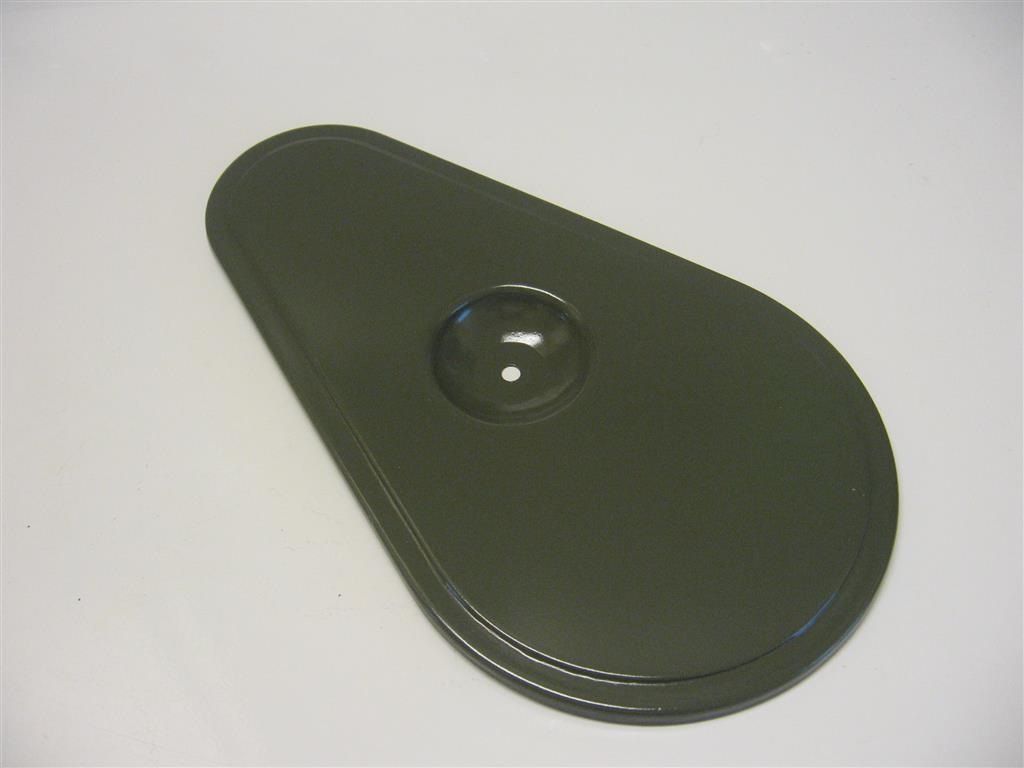

Found something that is close and am using it. It is a Dupli-Color green primer and I am finishing with several coats of clear.
It is Part Number DAP 1690 and UPC 26916946904 just in case anyone else wants to try it. As Richard said still no cigar but it is close enough for a rider. Need to get decals ordered now.

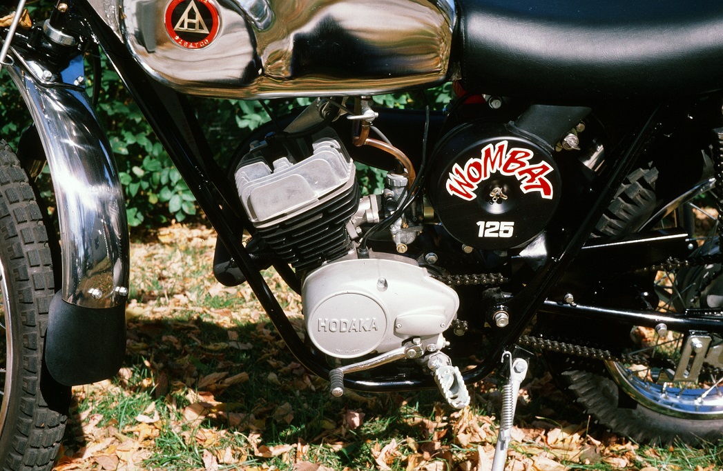

Re: Combat Wombat Paint
Some Hodaka restoration expert should correct me if I'm wrong here . . . but Wombat air cleaner covers were neither matte nor flat black. They were the same paint as the frame (gloss black). Right?
Scribbler
Posts: 50
Joined: Wed Jul 02, 2014 7:39 am
Post by Scribbler »
As you can see on this picture of my new Wombat 94A just after I bought it, the air filter was a matte black. Other items matte black were the turn signal indicator and the speedo body. The headlight and mounts, chainguard, battery box and frame were the glossy black.
My model 94 Wombat also came with a matte black air cleaner cover, as was the exhaust pipe.
So I stand corrected - twice. Matte or satin black it is.
