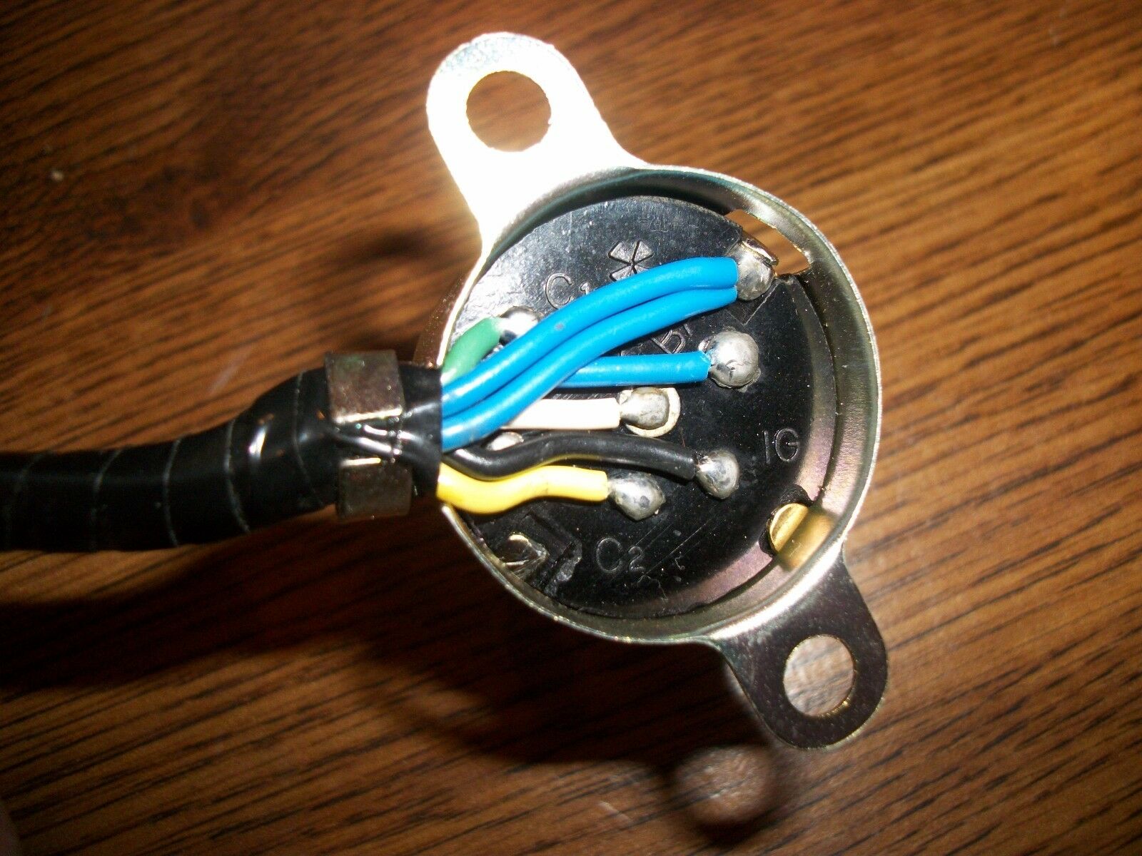

So, today I was working on the lighting on my bike, and as I made progress I noticed some weird behaviors when it came to the taillight and when it does/doesn't turn on.
For context, I have an Ace 100 B+ with a Wombat engine.
My keyswitch, as far as I'm aware, has these positions from left to right:
Off/Daylight/Night mode
The weird thing about the bike is that in the "daylight" position, when I use the front brake (the only one with a switch, at least at the moment), the taillight doesn't come on. Well, it does, but it is extremely dim. Is there something wrong with my taillight or was using a 12v bulb just a bad choice? It's odd because when I switch to "night mode," the taillight is VERY bright when I use the front brake. So it clearly gets enough power then.
Other question. Is the Ace 100 B+ supposed to have a brake switch on the front and back? In my owner's manual (in the pictures I could find) there was no brake switch visible on the hubs. Plus, my front brake switch looks aftermarket, so it seems like there wasn't anything there before. The back hub on my bike has no spot that looks like a clear mounting hole either.
Any info about the bike would help.

Not Hodaka specific, but your post triggered a memory.
I recall from my long ago days as a mechanic in a large Kawasaki shop that we would see an occasional problem with a key switch that would not work in one position, or the bike would have odd or intermittent electrical problems. It sometimes turned out that a soldered connection on the base of the switch was loose or detached. I think the problem was pretty much on ’76 model KZ400s. Anyway, it just took a few minutes to re-solder it correctly. I would re-solder each joint for good measure.
I don't have an Ace, but I think that the wire connections on the base of the Ace switch are made the same way, the end of the wire is simply soldered to a contact. You might want to check them, after so many years one could be corroded or loose, causing a loss of current flow.

When you use Night you switch on the other half of the lighting coil. The lighting is AC but the battery and brake light are DC with both systems interconnected but independent. As long as everything is connected properly it works, but you need to follow the official system. On Day you've only got half the lighting coil connected and that isn't enough to get much out of a 12v bulb.

By the way, if anyone could help me understand the meaning of the layout of the keyswitch on this diagram,
http://hodakapartsidaho.com/wp-content/ ... SCAN-4.pdf
it would be greatly appreciated. I can only understand the simple parts of the diagram, and whatever is going on with the keyswitch there isn't making much sense to me. Some of these wiring things are a bit overwhelming for me since I'm a beginner.
Re: Key Position/Brake Switch Question
In OFF the IG is connected to ground; essentially a kill switch. In first or DAY position the BAT terminal is connected to ground. This activates the DC system and makes things connected to the battery work such as brake light and horn.
The second position Night then connects HL and C2 to feed the alternator output to the headlight and taillight. C1 is always connected to the battery DC red wire system through the rectifier. SE doesn't go anywhere; may do something on another bike.
The 15W headlight plus the 5W taillight plus the 20W brake light add up to 35W which pretty much pins the alternator at redline so you won't get much but dim at idle. Hence the battery.
Page 89 of the manual shows this, but doesn't really explain what's going on.

The lighting coil has a centre tap which goes to ground. It acts like two coils with a common ground. One side is used for the battery charging and the DC brake light and horn. The emergency switch just combines the output of the two sides together, which works if you aren't running a battery but won't give you much at idle. If you are running a battery it will drain it faster than the battery can charge unless you're running full revs all the time.TheAceWombat wrote: ↑Tue Dec 22, 2020 8:31 pm Thank you guys for the help once again.

Thank you for the explanation Jpark. Now that I got a better look at the stator from some pictures (I haven't opened up my engine) I am understanding better. When is the switch combining the output of the two coils together? In the DC or AC position? I'd think the AC because, of course, the DC position is for when the bike isn't running. What is confusing about this is it makes me think that then the battery wouldn't be charging if both coils' outputs were combined.
Believe it or not, the 12v will probably work. It has been able to light pretty bright. Regardless, I can keep using them for testing. And yes, I understand the wattage has to all add up. If it works, great. If it doesn't, new plan. I'll get finished either way.
So, in the daylight position, what is the stator feeding? Just charging the battery and lighting the headlight? If I'm remembering right, the brake light does not work in the daylight position for me. This makes perfect sense of course since I don't have battery. Also worth mentioning, in this position the taillight doesn't light either. I'm guessing that's normal since it's supposed to be used during the day.
What is the C1 terminal responsible for? I'm curious if it's just charging or if it does more. Overall though, knowing these things is really giving me a clearer picture of what's going on. I think it'd basically function like normal if I added a battery.
