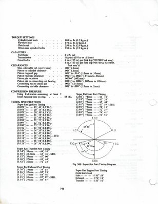

so after all this time I finally got my leak down system? made, lost pressure about as fast as pumped in. Leaking on seal on clutch side of crank. I'm so glad I did that! So I took cylinder off after that. Does anyone have a port drawing of a 93Acylinder or is there another way to tell if its the correct cylinder?

Al Harpster
Posts: 308
Re: 93a super rat
Post by Al Harpster »
This is from the Super Rat Workshop Manual Supplement.
I expect the port dimensions are all taken from the top of the cylinder.
The Dimensions Marked STANDARD are most likely the 'factory' target dimensions.
I have ZERO idea what the tolerances might be. For a casting there can be some considerable variations.
