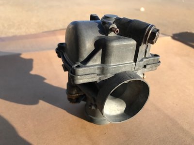

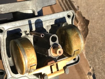

Help please, Just got a Super Rat and took carb apart. From the outside it looks correct.On the inside it has a second main jet, the jet in bowl is a 140, jet in carb is a 95. Is this correct? Is it a Super rat carb?
Re: 93 super rat carb
No that’s not right, that should be just a tube like piece with a O-Ring that the needle slides down into. I guess a Jet may be able to fit. Check out my SR carb video and you can see the part.

You can see the Jetting specs in the HPI Library. The Super Rat carb has a 1/4 inch inlet nipple and 24 millimeter Venturi. The Yamaha AT1 and CT1 used the identical carb BUT the fuel inlet is 5/16 inch.Some AT1 CTI carbs were 26mm. You can install the main jet as shown in your photo. I do. Once you have it jetted, you can screw the Main Jet in as shown in the Photo. I prefer it that way because the Factory position of the main Jet is at the lowest point and ANY grit plugs up the Main Jet really easy. I have a 180 Main jet in my Super Rat ( Stock Engine). It`s been that way for the past 45 plus years . They came Jetted way too rich on the Main Jet. Never seized a Piston. Ever! Joe Ormonde.

Looks like maybe you might have a Rat carb top half with a Wombat bowl? Just a guess. But I would run the bowl jet holder empty & go with the main jet mounted in the top half of the carb as shown in your picture. Just my 2 cents. :ugeek: Victor
Victor, that’s the right bowl. I’ve never tried it but it looks like maybe a main Jet thread is the same as the inlet. So looks like someone screwed a jet into it.

Thanks everyone for the help. I watched all the socalhodaka super rat videos. I didn't realize that the oring part screwed out. A quick look at Hodaka parts inc and there it is! can be bought! I noticed same oring for model 93 and 95, just happen to have a model 95 flanged carb for parts! Think I'll do like Joe said, jet from bowl jet and then put in other position, gets rid of that leaking oring that causes problems. Thanks All.

That`s one reason I install the Main Jet under the Needle Jet. Once your bike is jetted, it`s jetted. What you can do is screw what they call the Needle Jet Bolt into the Banjo Bolt or as I call it the main jet holder so it doesn`t get lost. Anyhow, that`s how I do it. Joe.

So ... I got the Super Rat to start, ran really rich, main jet screwed in where oring usually is. I think gas is still getting by jet. Is this carb worth buying all the parts to rebuild? Would I be better off to purchase a new carb and convert to spigot mount?
It’s worth the rebuild. They are getting harder & harder to find, flange mounts that is. So if the body is still good, it’s worth the rebuild kit! :ugeek: Victor
budpat - I believe you are on the right track. Having the main jet installed in the bottom end of the needle jet is not right for that carb. It is quite likely that restoring the proper pieces with the O-ring will also restore proper operation.

I thought that too until I relocated the Main Jet under the Needle Jet. My carb in my 93A Has been that way for 40+ years with no trouble. My Jetting specs are as follows: Pilot #30. Throttle Valve(Slide) #2.0 Needle Jet #N8. Jet Needle # 4D3 ( In The Center Position). Main Jet #180. If any one wants to find out what a Super Rat is supposed to run like COME ON OVER TO MY PLACE AND RIDE MINE !!! A weak Ignition is USUALLY the culprit . Once again, that Factory Installed cap! Check it first. Joe Ormonde.
