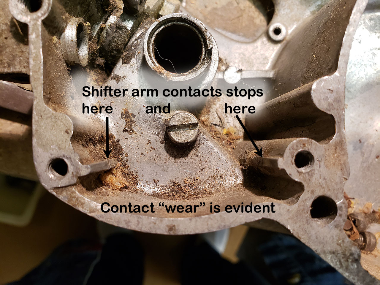

Kev,
Yeah, the description of the "stop" was not particularly good. Actually, it was pretty bad - so here is a photo of the "stops" which provide a "limit" on the movement of the shifter arm which is integral with the foot change shaft whether up-shifting or down-shifting. If these "stops" are hammered out, then the shifter arm will "over-travel" (and so will the control shaft) - and that could easily lead to the problem you have experienced in 5th gear. I'm guessing that Al is going to get back to us with what he found, but one of his posts strongly hinted that installing shims under the snap ring at the outer end of the foot change shaft (to limit end play of the foot change shaft) was the "magic bullet".

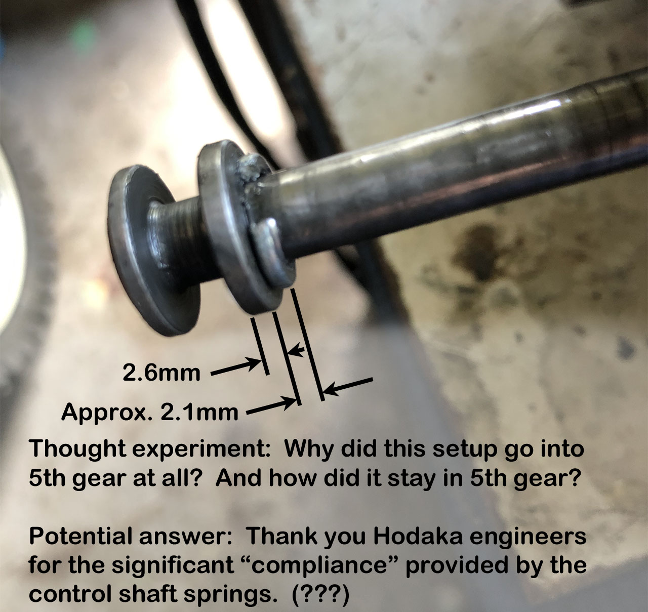

Finally, I want to look into this whole situation in a "wholistic" way because there are a myriad of related questions:
1. Since a quick look at a countershaft/control shaft assembly on the bench suggests that the spool of the control shaft normally travels to a point less than 1mm from the end of the countershaft . . . how the heck to did you even get into 5th with a spacer which prevented the control shaft from getting anywhere near that close to the end of the countershaft? (see photo below) 2. Did MTrat have to adjust the shifter after taking off the inner cover to get shifting right.

Thinking about this way too much when on holidays but I think we are there.
The worn case stops will cause the ratchet to over travel and that is when the knuckle could fall out of the ratchet gear. The plunger pin ultimately locates the ratchet gear and thus the sliding position and that does not change with case stops wearing. It’s likely that the knuckle falls out due to over travel before the plunger pin is in place.
How did the washer stop the problem and still allow engagement? I have known idea.

Yes, the Magic Bullet for me was just as stated by Bullfrog:

I cannot help but join in on this discussion, as I too have suffered from this malady. I'm sure not all cases have the same root cause, but here's what happened to my model 95 Combat in about 2008.
Stuck in fifth gear while racing. Added o ring between motos, and it worked for the rest of the day. Not long after that, Ed came to visit, and we took it apart, and Ed analyzed the wear on the parts. Mind you that the shift shaft was re-bushed perfectly, and was set with no end play, and not loose in the case, when the problem occurred.
Ed found the culprit was the index gear was worn oblong where it rides on the shift shaft, and that in turn had also worn a step into the shift shaft where it rides. In my case the fix was to replace the shift shaft and the index gear, then re-assemble with all the same other parts. For those who are rebuilding shift cases, I recommend that you try the index gear on the shift shaft and really check it close for looseness. It doesn't take much to cause this problem. It was not obvious.

Kev, I don't think that last test was definitive. Removing the inner cover "moves" the whole shift cover inboard about 1mm - which significantly changes the geometry of the 5th gear shift. I think you'd need to put equivalent thickness washers on the mount screws (with the inner cover removed) to have a true test.
