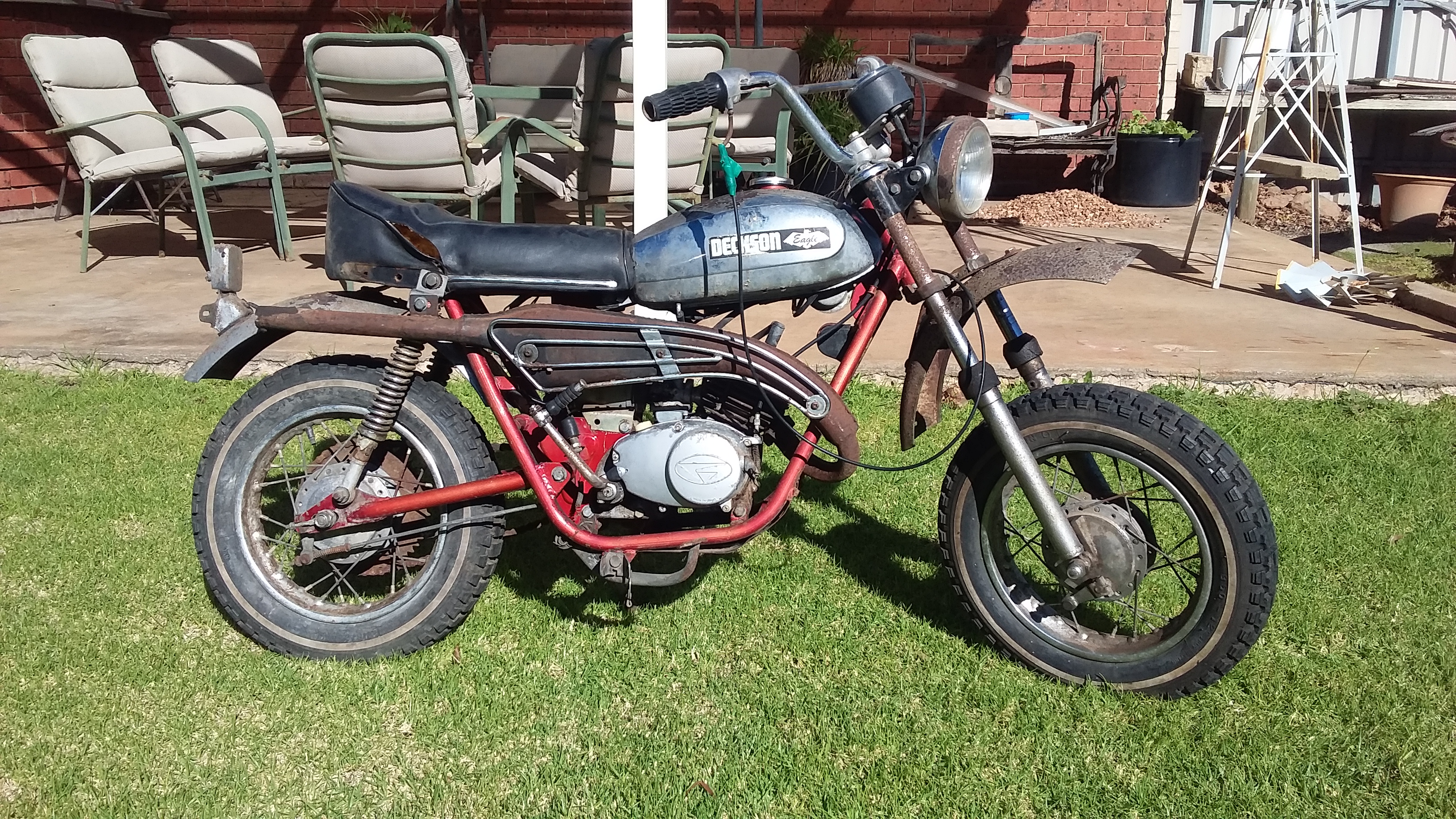

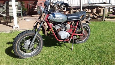

Re: Fuji motors??
Just an update on this little project, all is going very well and I am pretty pleased so far.
-When I got her she was locked in gear, pulled the side cover and found a pull shaft exactly like the bigger Hodaka's, the bike cycled thru the gears nicely.
-Pulled the shift mechanism apart which was once again exactly like the Hodaka's, cleaned and greased all that, and that also clicks thru the gears with no sign of wear, I now have 4 speeds available!
-Cleaned the carby out, surprisingly clean and fortunately was full of oil, no water in sight.
-Pulled the head and the bore is good, no excess piston slap but can't see the rings, I know it has pretty good compression.
-Checked for spark, voila, a great spark.
-Drained the oil and it was pretty clear, no filings but it had sedimented in the crank case base so flushed that out.
-Been trying to find a replacement fuel tap with little success, and one was right under my nose! the 250ED tap is exactly the same I need, so till I get another tap I will use the Thunderdogs tap!
So this weekend I will repair the throttle cable and rig up a kill switch as the ignition switch is cactus and see if it will start, I am quietly confident. I also gained a Dirt Squirt for the stable last weekend so the Hody's will have to line up for a family photo!
Full restoration is still some way of yet.
Wayne from Oz
