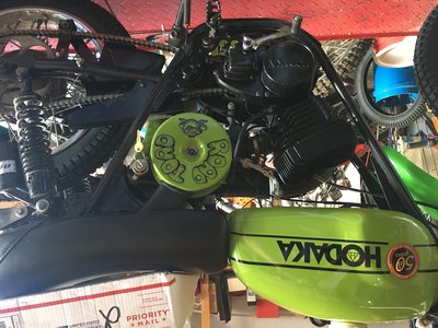

Well I’ve fiddled and faddled and worked on just about everything I could!
Finished re-terminating the connectors on the wire harness.
Put the spacer back in the rear wheel where it belonged.
Chain issues worked out and chain properly tensioned. (Pic taken before chain adjusted).
Replaced the brake rod instead of trying to weld another tab on. All brake switches & Springs connected.
Put new tube in the front tire & remounted front wheel.
22 ounces of tranny oil in the tranny.
New lamp in headlight.
All she needs is to come off the rack, add fuel, bleed the fuel system and kick her over, tomorrow! :ugeek: Victor

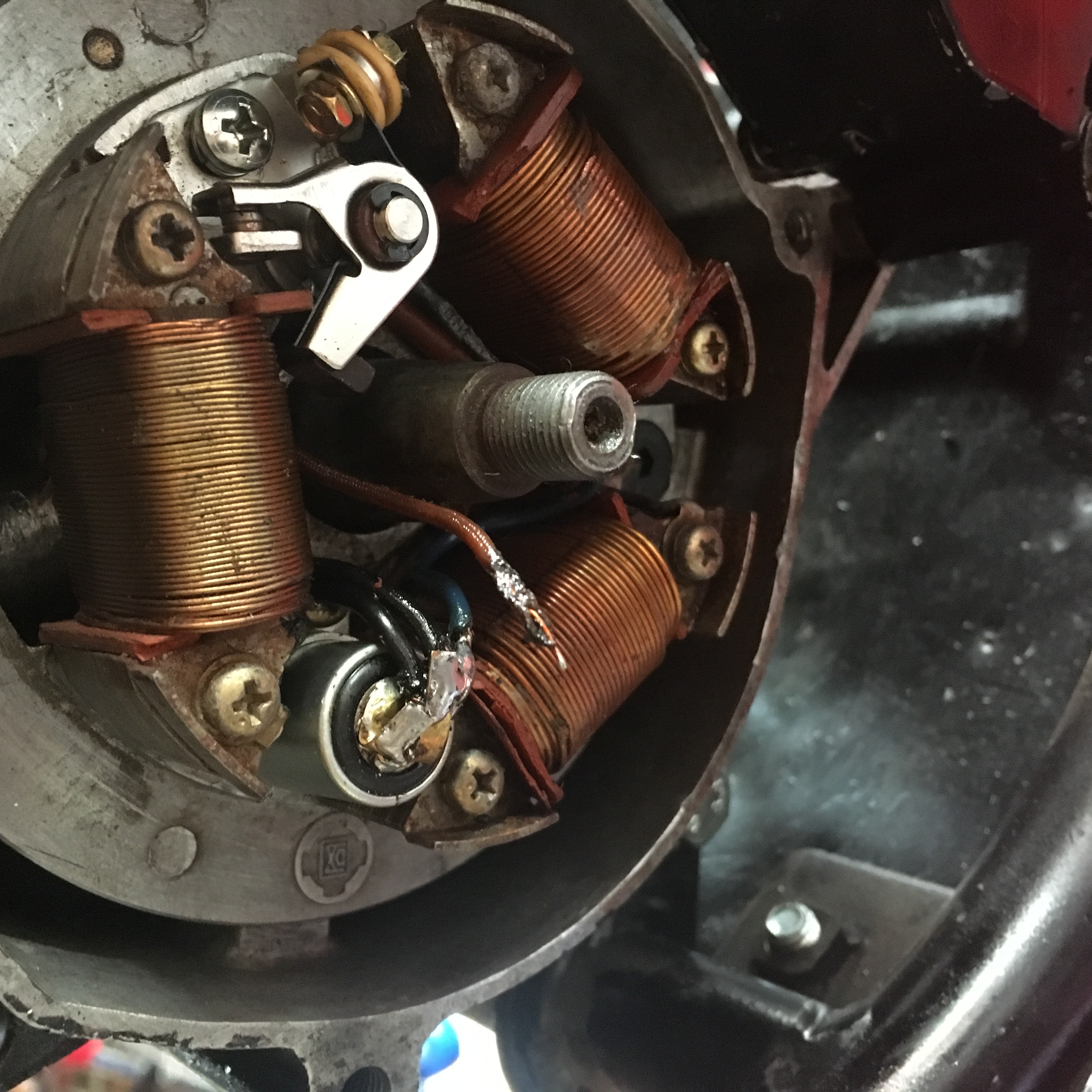

Hi! Back at it again. After reassembly I’m finding that I’m not getting spark. I’m wondering how to tell IF the coil needs to be rebuilt?
I pulled the spark pkug, turned on the key, and disconnected the kill switch to take it out of the situation. Regapped the points, even changing out the screw which holds the points in place with a new screw & lock washer & set the gap at .013.
When we kick the bike we do not get the faintest spark on when plug with it pulled & grounded against the head fins. So I’m at least suspect it may be the plug wire on the coil.
The plug wire is not stiff and/or brittle. But I can’t say whether or not it’s loosened up where it is soldered.
So, I’m going to see if I have a different coil to test with. If I get spark, then I guess I’ll know I need to do the SoCalHodaka coil repair.
Stay tuned! :ugeek: Victor

OK. I just tested now. Results, with ignition disconnected shows no spark with either coil. So, does this mean it may be my exciting coil on the stator? Is there a way to test?
I guess I should also test my capacitor, be a non-working capacitor would also mean no spark. I have one or 2 spare capacitors. I’ll try changing out for a known good. Thought this one was good. Any other ideas??? :ugeek: Victor
Re: Green 1975 Road Toad Ready!!!

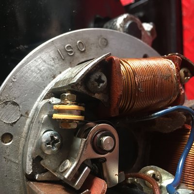

Spark. No spark. Checking condenser, it’s new. Haven’t changed out yet. Wires connected to condenser are as follows, 2 black, 1 red (brown?) from exciter, 1 blue from points. Yes? No?
You can see the stator. I don’t believe there is any solder making contact with the metal exterior of the condenser. It also appears the nut on the points, holding the blue wire to points, may be making contact with one of the ends of the upper right lighting coil. Could this cause a short circuit? I don’t really know, but I could pull and reverse but and bolt to create space. See pic of the nut to which I’m referring. :ugeek: Victor

When mounting the stator back on the motor, it appears the red wire was not adequately attached to the condenser. There was premix on it & it came loose. Going to try resoldering and test again.
Fingers crossed!!! :ugeek: Victor
