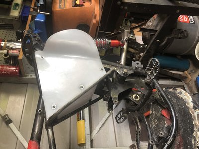

I have some side plates in progress to seal off the airbox and provide a number plate. I tried this last year with 3 mm Acrylic plastic but it was too brittle, it cracked. I have this other plastic HDPE 3 mm . It’s a lot more flexible and super easy to heat form. I’ll see how it goes.

Re: Case Reed 125 Hodaka Project
Post by thirdstone »
One side done.
That is looking really good Kevin.
What are your fasteners tied into? To the other sides of the plastic airbox or did you add tabs to the frame?
Hi yes correct , I welded metal tabs to the frame that I welded nuts on. On a previous attempt at this I had pop riveted tabs to the the plastic as I didn’t have the down tubes. Those tabs worked loose over time .

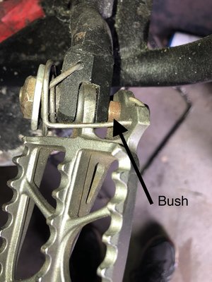

What footpegs do you have on your bike? They look good and wide, would making jump landings easier on the feet.
dirty_rat wrote:What footpegs do you have on your bike? They look good and wide, would making jump landings easier on the feet.
They are Honda CRF 450 pegs. They are not a straight swap over. Quite a bit of fabrication went into making them work,I had a lot of spare time..
Pkay, thanks Thirdstone, I will check them out. I have a couple of other ones to look at also, just wanted to see if what you used didn't take too much re-working. Thanks
I had to make a Bushing and ground a lot off the peg stops. I used the original Hodaka springs . It looks a bit back yard ( and it is ) but they work remarkably well.

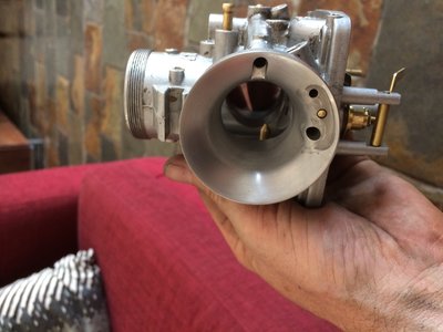

Here is a picture of the Carby inlet all smoothed out. It’s a 30mm , I know everyone else is sticking much bigger carby’s in but I wanted to try something else. Full disclosure, I run. 34mm on my race bike.

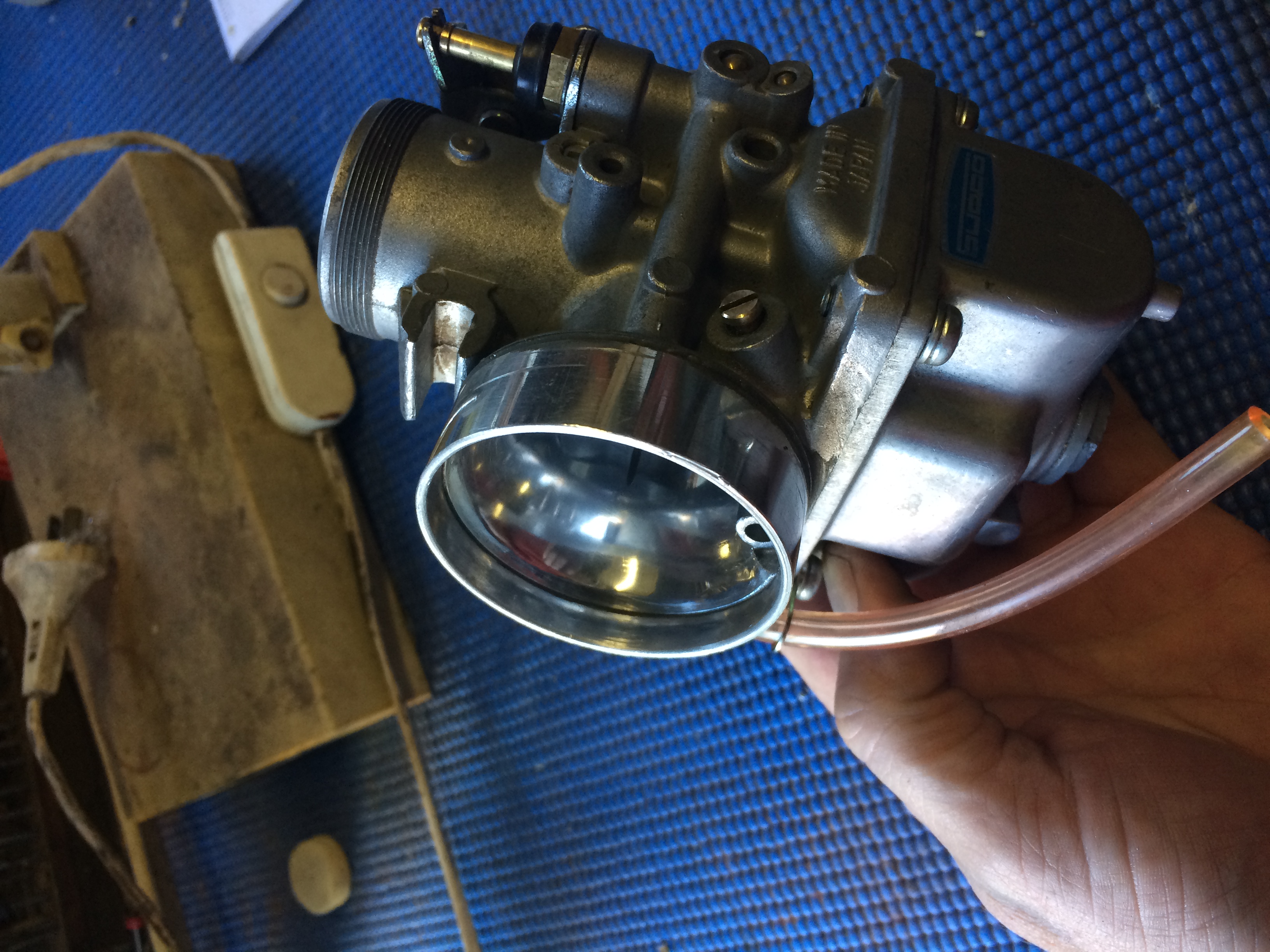

This is the 34mm off the race bike. I turned down the inlet to add the extension ring to give the filter boot more area to bite down on.

I’m done with the AirBox now. As good as I had hoped for. The new plastic much more resilient than the stiff Acrylic. This is just mocked up for now.
Great build, Third. Love watching it come together. That air box turned out sweet.

Yes! Nice looking build! . . . and nice "bell mouth" work on the 30mm carb too!

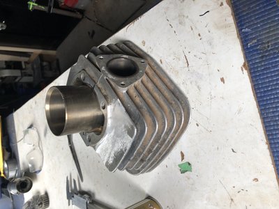

Resleeve done , now the real work starts.
Bottom of that sleeve looks a bit long?
thrownchain wrote:Bottom of that sleeve looks a bit long?
Nah it`ll fit
Get a bigger hammer? ;)
I'm guessing that a considerable amount of work will be involved to shape the bottom end of the spigot to match the case reed induction system.
