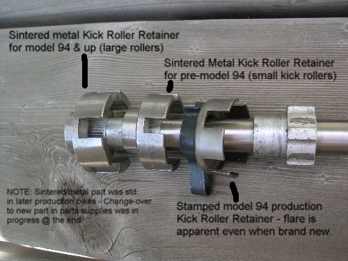

I don't have have an upgrade for the kickroller retainer. I'd rather not wait for one
- I'll look for wear. Is that a common issue? Rather not be kicking myself later - ha, pun intended!

I'd recommend waiting on the improved kick roller retainer, the original stamped item could have easily been "worn out"/flared the day the engine was originally assembled. Flared "legs" of the kick roller retainer will result in kick start slipping. Also be sure to check (with a magnifier) for cracks in the corners of the cut-outs in the kick roller retainer, if there are cracks there now - failure is imminent.

It’s a good idea to order that upgraded kick shaft retainer. The OEMs were very thin and prone to cracking. Check yours very closely for cracks, swelling or other damage. No sense in putting it all back together, only to have the retainer fail just a ways down the road. Then you’ll be splitting the cases again, just to do that work, and need new gaskets forceverything as well. Why not do it now while you have it open? Here’s a link!

Agreed, the OEM kick shaft retainers are inferior but kicking method is often the culprit which causes them to fail. Easing the engine up to near TDC and taking up slack in the kick starter before a brisk down stroke to start engine is easier on the system than the frequently seen vigorous repeated cranking tactic.

It`s just good insurance to install the Heavy Duty kick Roller Retainer. Terry at HPI sells them for $41.00. Not only are they brutally strong, but it keeps the 5 needles spinning true: especially on the earlier models with the tiny needles. I rebuilt my Super Rat with all stock parts with exception of the kick roller retainer and Poppy Piston ring. I even stuck with the fiber clutch discs. Why? The fiber discs will shear before the gears fail. I sheared the clutch discs twice, upgraded to a Barnettes clutch kit then broke gears. In short, the factory clutch is weaker than the trans. It`s easier to fix the clutch than the transmission. If you race that`s a different story: By all means beef up the clutch too. The Model 94 is a GREAT Engine! Joe Ormonde.

I'll order the kick retainer
