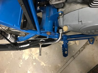

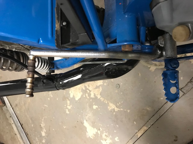

Restoring a 97 basket case and discovered a weird kick start shaft problem. It appears to protrude 1.5" from case. The previous owner tried to bend the original straight kick lever but that wouldn't clear the frame , then he tried a bend kick lever and that hit the pipe. So he beat the crap out of the pipe to help clear. The shaft part numbers appear to be all the same .

Neither of the 2 you show pictures of are Model 97 kickers. One may be Wombat or Ace and the other is a Road Toad/Dirt Squirt or late model 03 Wombat.
Re: 97 Kick Start shaft

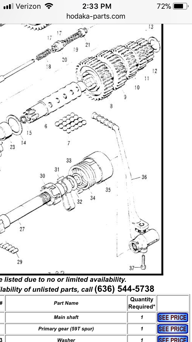

Kick start shafts and kick start levers are two different things. And as mentioned, neither of the kick start levers shown in the photos are the right one for the Super Combat. You can look up the proper part number on the Strictly Hodaka web site (look for model identification stuff and then you'll find Illustrated Parts Lists by model).

Here’s a photo of the fiche showing the Model 97 kick lever. Looks like the 2nd picture is the correct one, but does it appear to be bent, or is it just camera distortion? Also it’s closeness to the frame may indicate it’s not the correct one, unless it’s just bent. :ugeek: Victor
It’s not a Road Toad kick shaft. Those do not have a straight kick shaft. :ugeek: Victor
