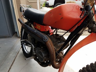

I received a phone call from a stranger Friday night asking if I would be interested in a Hodaka motorcycle. I agreed to meet up with him on Saturday to take a look. He knew nothing of the bikes history. Purchased it on a whim to try make a few bucks. I believed its a 76 Wombat, and it is frame# M31689, engine# Q15024. After I purchased it and he asked me if I planned on restoring it? Good question!
Since we'll be working on fully restoring the STEEN I think I'll slowly do a save on this one. Purchasing replacement/missing parts as I find them.
How do you guys make your decision on a save or restore?

For the most part restoring it is saving it, just at a higher level. If you're gonna do a restore on the Steen, and gather parts as you find them for the Wombat, when you get to the point you're ready to restore the Wombat you should have most if not all the parts you need. That and the insight you gather doing the Steen will make the next rebuild a lot easier. (and quicker). As to personal choice on save or restore, to me it's the end use. Don't do a museum quality restore if you're gonna ride it hard, you'll end up redoing it again, or you may make it too nice to ride.

There are four basic categories to consider. Which you choose depends on your ultimate plans for the bike. 1) Parting out - in my opinion the worst option by far although I understand its necessity and have benefited from bike salvage operations and other folks who do this. Its particularly sad when this is done to a nearly complete bike (like yours) with great restoration potential. Certain hard to find parts sell immediately for big bucks but stripping them off and selling them makes the bike as a whole less desirable for someone who wants to restore the entire bike. That's why there are thousands of bare Hodaka frames laying around. 2) Preservation - basically halting the process of deterioration so that the bike can be salvaged one day. Getting the bike out of the elements, filling the engine cases with kerosene, de-rusting, blocking off openings, covering entire bike with a rust inhibitor will keep the bike in a restorable condition for future restoration effort. 3) Rider restoration (my personal favorite) - this refers to restoring the bike to a functional and dependable machine that can safely be put back into service while preserving the patina that has evolved over the past 40-50 years. All operating systems are brought up to mechanical and functional spec. In many instances, stripping the frame is required to inspect and repair welds and rustproof. I like to leave the frame as is if it can be determined that it is structurally sound. 4) "Sky's the limit" restoration - This can be the concourse restoration of a bike to showroom fresh condition or a highly customized, purpose built racing machine with many hand-crafted parts and custom designed operating systems (See "Day 1" project and "2 the Max" project on this forum and the Racerclam bikes which are truly "Works bike" builds for examples). Like Thrownchain says, determine your goal for the bike then build accordingly.

Thats perfect, just a good cleaning and ride it. Patina is good

Looks like a Model 03 Wombat to me! Seems you’re lacking the lighting package if you go full on restore. Does it have a main harness? It also appears to still have the dual cable throttle assembly which means the oil tank/pump may still be in use. Can’t tell from the picture ifvit has the correct perch for the brake.

The Wombat has no spark. Wiring is in kind of a cluster to say the least. The engine has great compression and seems to shift well. The oil tank is still intact and doesn't appear to be cracked. There are mismatched foot pegs and to me the roughest part may be the exhaust pipe. It's rusted completely through on lower bend. I was so excited the exhaust was all original and then.. it'll take some work. :lol:

That is definitely a Model 03 Wombat. Nifty scooter. Very good suspension and primary kick start. Probably the best "all around" power for an every day street/trail bike that Hodaka ever made. Note that automotive exhaust "U bends" can be found at local muffler shops to do the head pipe replacement . . . a relatively straight-forward repair.

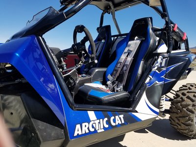

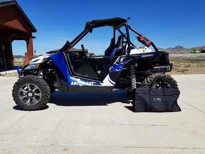

I believe Emerson was the one to coin "life is a journey, not a destination." It's the same with restoring the motorcycles. Or in my case building a hand controled Arctic Cat Wildcat 1000 X. Rest assured I'm still out there playing with the young ones. Now the toys just happen to have a cage. Over the years I've helped several others in my situation build their UTV's as well. It's very rewarding to open the doors to adventure for an individual that thought it was lost forever. Thus proving life is a journey if you keep living it. I'll attach a few picturs of the Wildcat sporting a portable personal lift. It was requested by a wife of a disabled Veteran.
The door is lifted off and the lift is ready to be set up.
The lift is attached and ready.
A shot of the hand controls. Note the steering has been extended back 6".
The lift is in the bag leaning against the tire.
