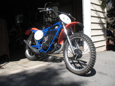

The manual for the model 97 Super Combat calls for an NGK B - 9HV. I tried to look these plugs up on an NGK site, but couldn't find them. Is a B 9HS the same or similar? Meanwhile, here's a pic of my 97 project, having just installed a new kill switch and rubber intake boot from Terry Larson.

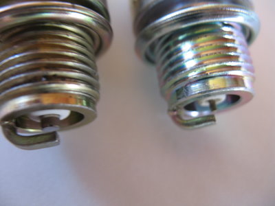

Thanks, Matt. I found a "V" type on ebay and will post a pic of it and the S type side by side when it arrives.
Re: Spark Plug Question : NGK B-9HV or B9HS Super Combat
Cool. That would be interesting to see the side-by-side comparison.
Side by side pic of two NGK spark plugs. The B9HS on the left has a bigger electrode than the B9HV. By the way, does anyone know the resistance values of the primary and secondary coil on the 97 Super Combat or 98 Super Rat?
