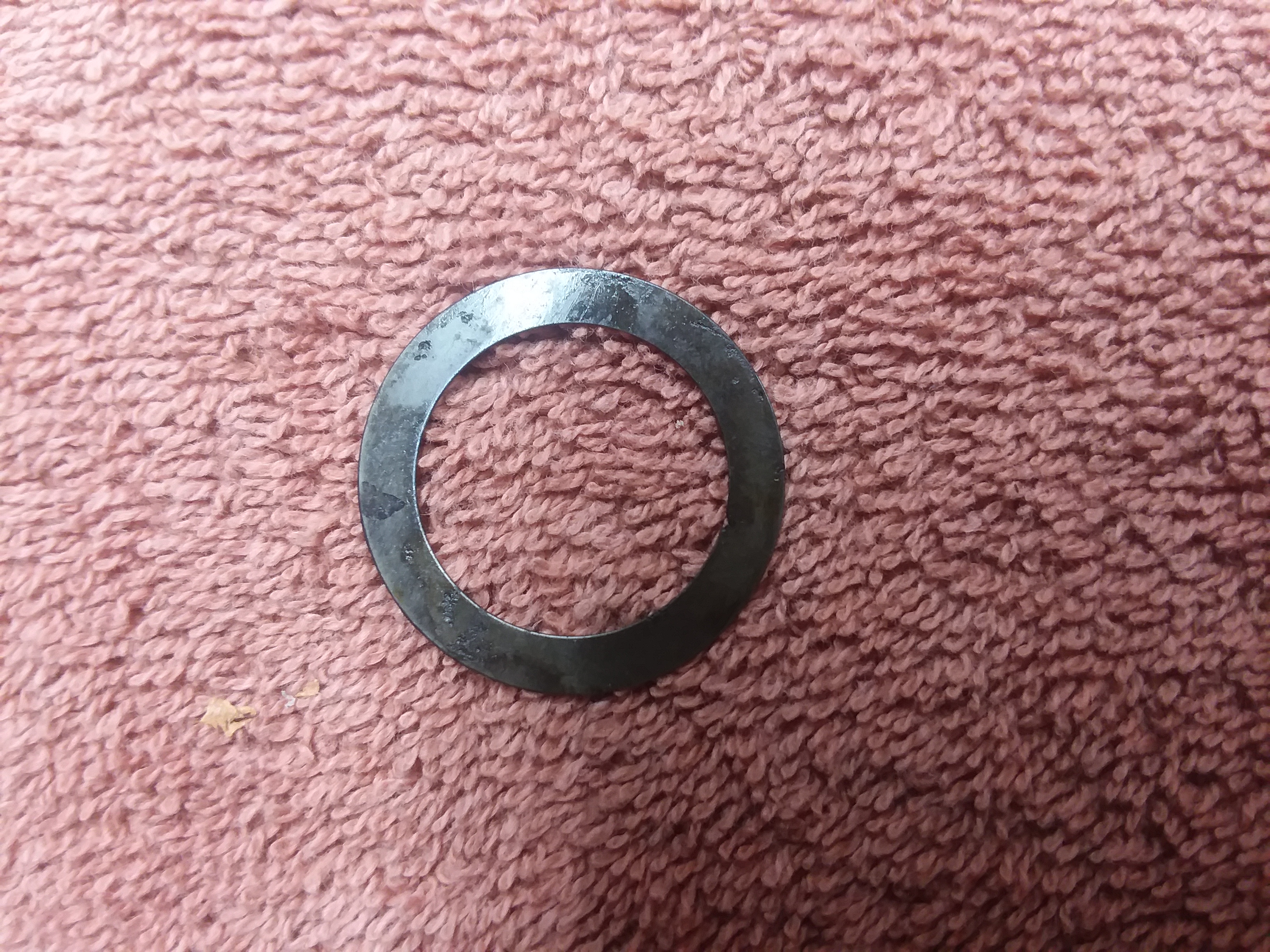

I’m in the process of putting my engine back together. Between sifting through my parts and trying to make sense of some of the schematics, I’m not sure if the left side crankshaft washer is placed on the left crank spindle before the left hand case is installed, or if it goes on after and is part of fastening the flywheel, along with the lock washer. Any help is always appreciated. Thanks!

Also, is it a this washer (as thin as a thrust washer)?
Re: Left side crankshaft washer
Yes, it is placed on the spindle before the left case is installed. And yes, it is a thin thrust washer that fits nicely to the spindle diameter.

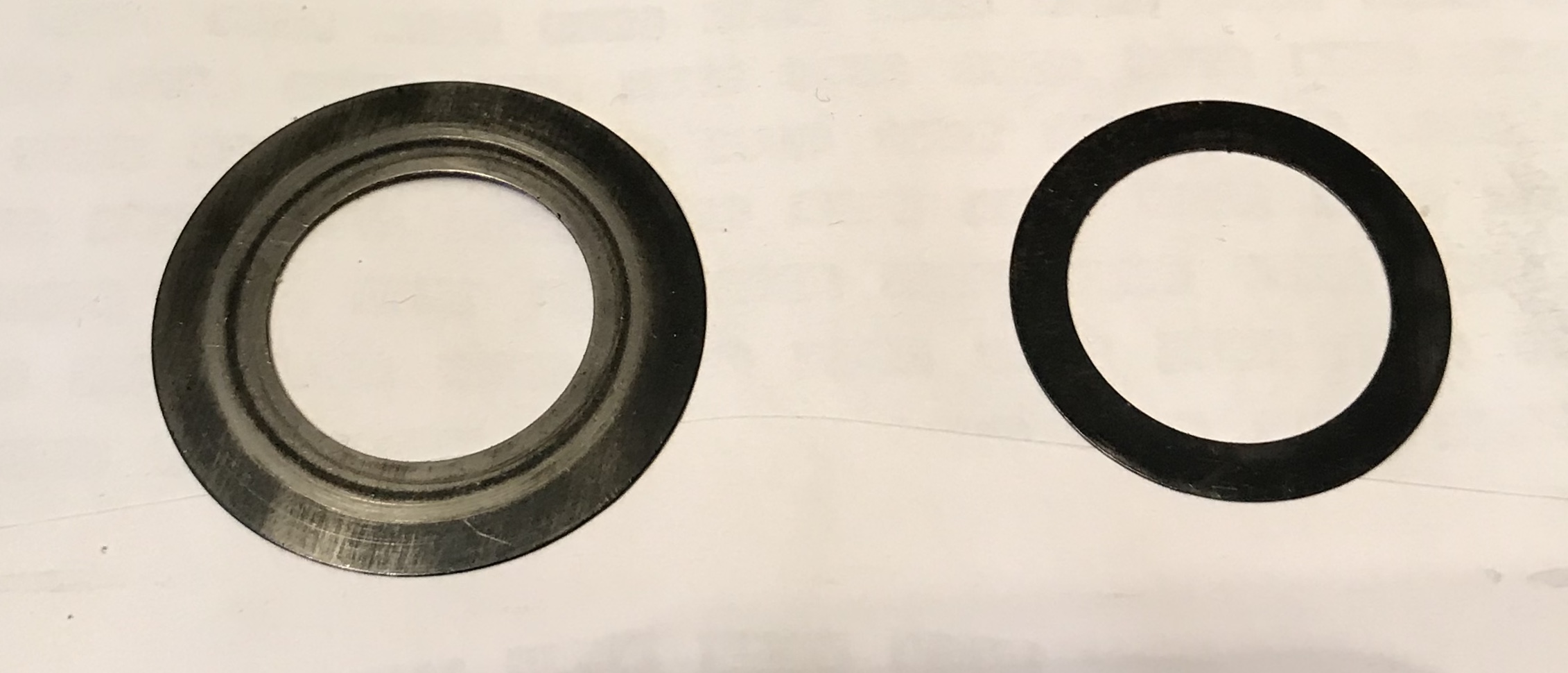

Thanks a lot for taking the time to respond. I value the advice here. I went ahead and split the cases in order to install the needed washer on the left side of the crank. In my box of Hodaka parts, I have these two washers left over. The bigger one is an extra one I had that I believe goes on the left end of the transmission. However, both fit properly on the left hand side of the crank. Can anyone point out which one I need to use on the crank, as the schematic is too vague in its description/picture. Thanks again.
