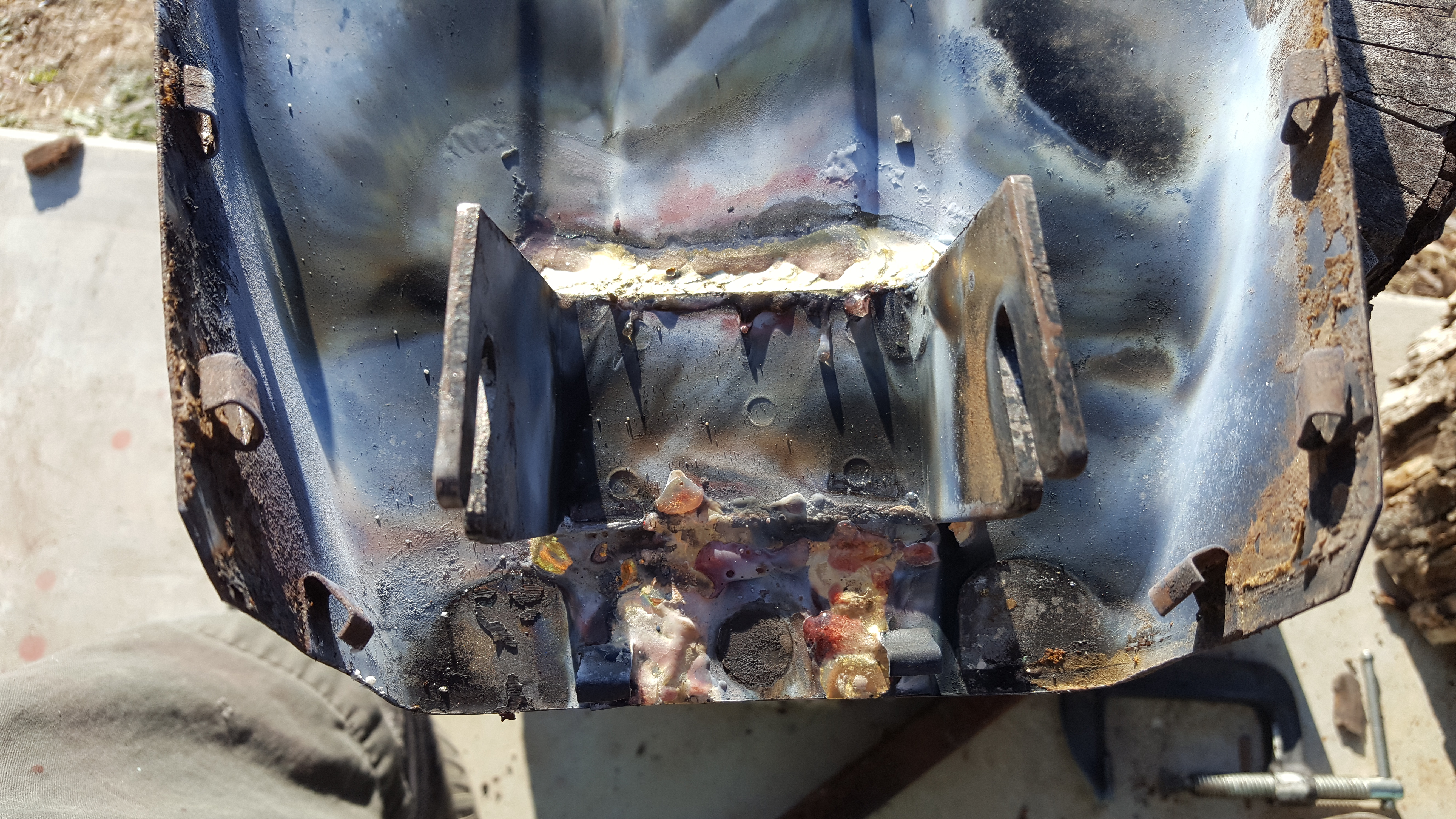

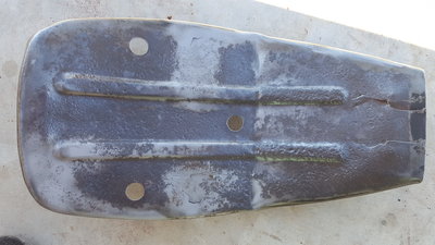

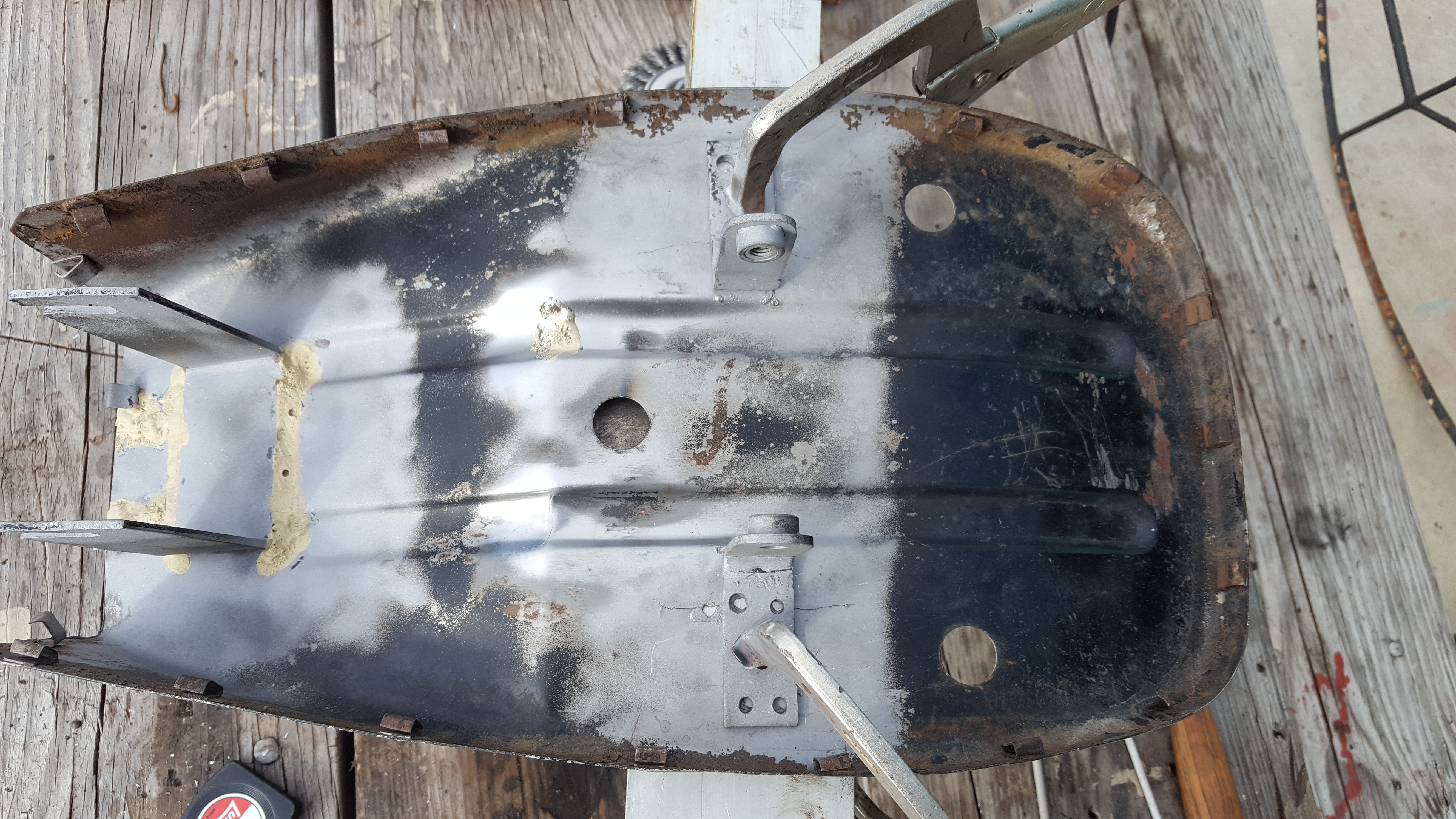

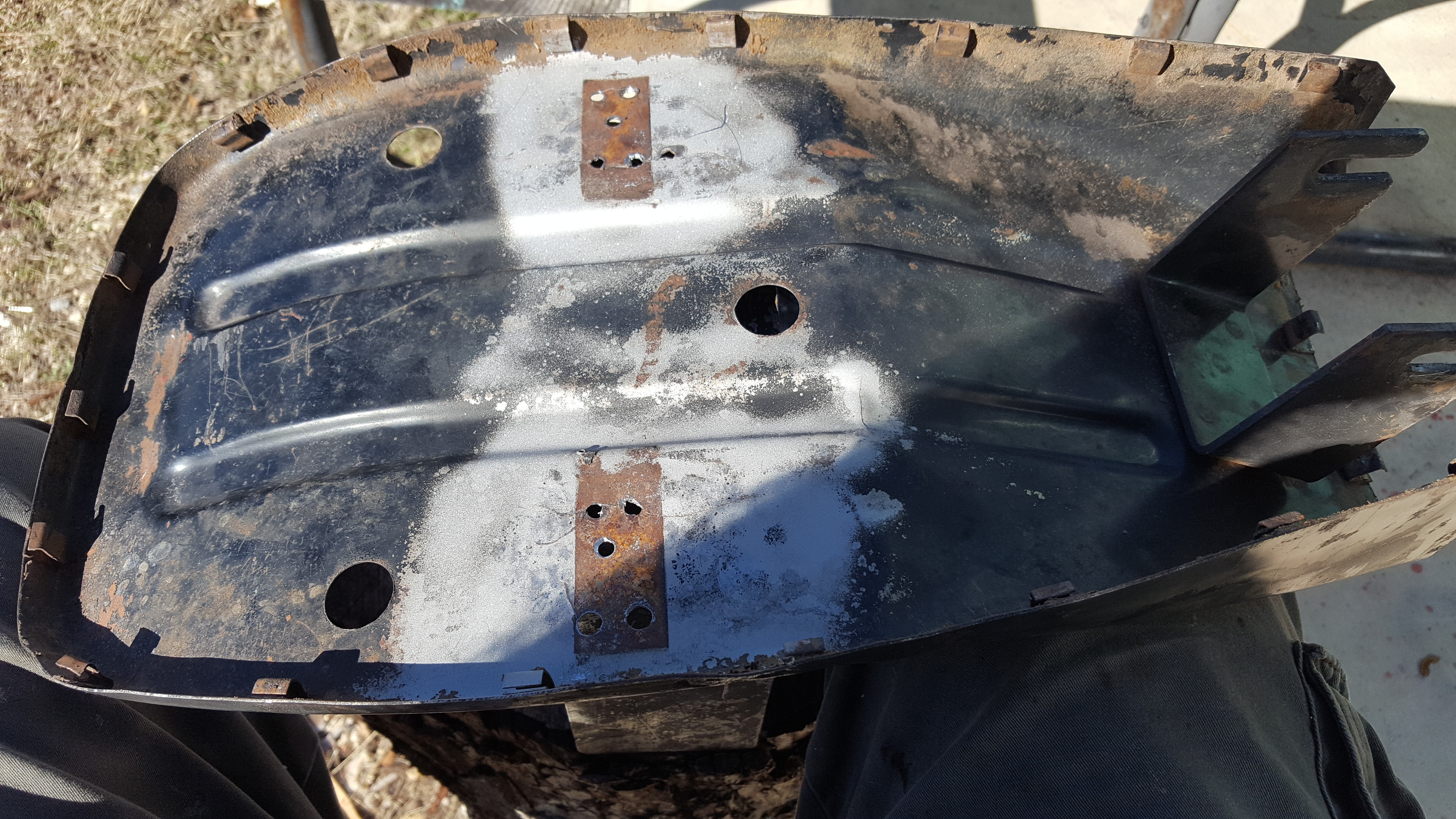

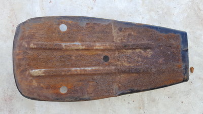

W.A.R. on a 93A seat pan. That's it gentlemen, I am going to show how to weld and repair a seat pan in case anybody would like to try it themselves some time. The bottom pic is before starting. First, I removed the cover and foam and discovered it was all rusted between the pan and foam. Need to get all the rust from around areas to weld repair. Very important, rust and weld do not mix good, Brass rod especially. That's what I will use to do this weld and repair. Brass flows on very nicely and you can use it to build up damaged areas. I then removed the old ears by drilling out the spot welds. I did this because I am going to put a reinforcement plate on the bottom of the pan where the ears were before. I am also going to weld the ears on to this plate. Also, lets straighten out all bends, dents, and damage on the pan now before we weld it up. Once its welded its hard to straighten.

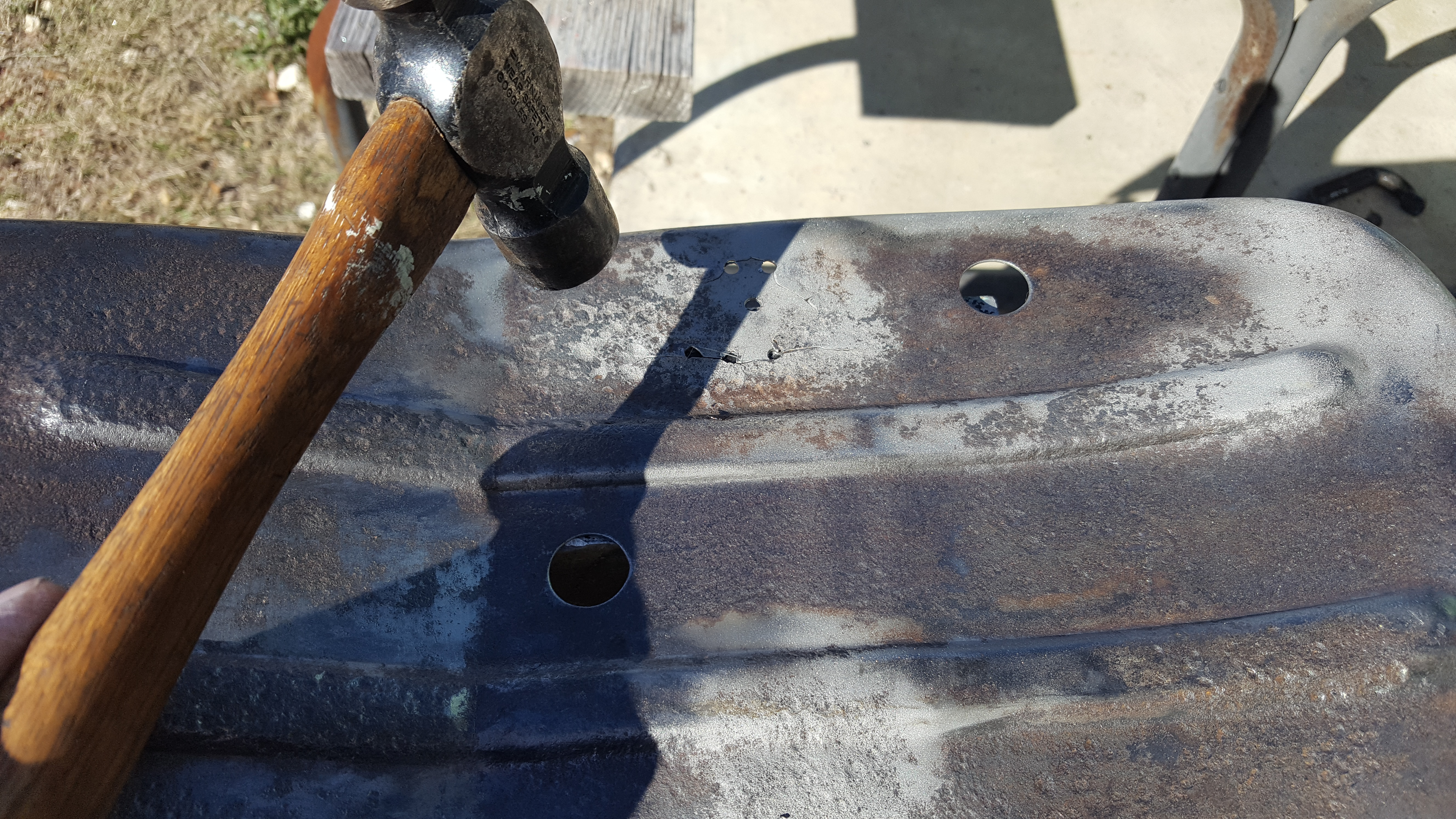

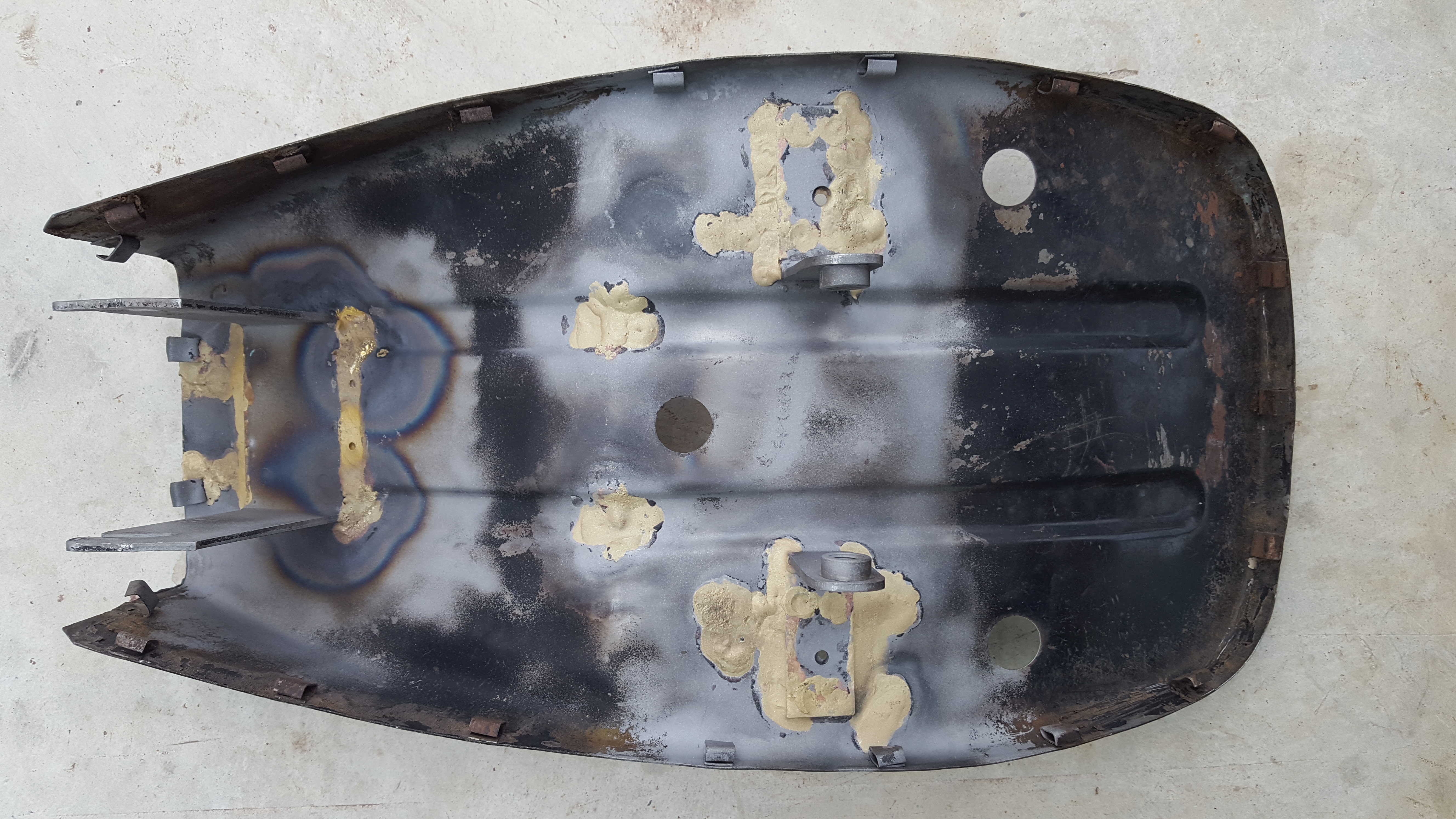

Ok now here I have clamped a small piece of rectangular tubing underneath the front of the pan to get that front edge nice and straight while we weld it up good. Notice how its clamped very good just giving me space to weld it. I will weld it up on both sides. Then I will wash it in water to get off the brazing flux and give it a sandblasting to clean it up. That's looking much better now. Tomorrow I will fabricate the reinforcement plate with some ears welded to it and fasten it on to the pan. I will post details on this tomorrow. If you zoom on the pics you can see the pan is loaded with cracks. All of these will be welded up. Going to do it the right way, yeah man. Thanks gentlemen!

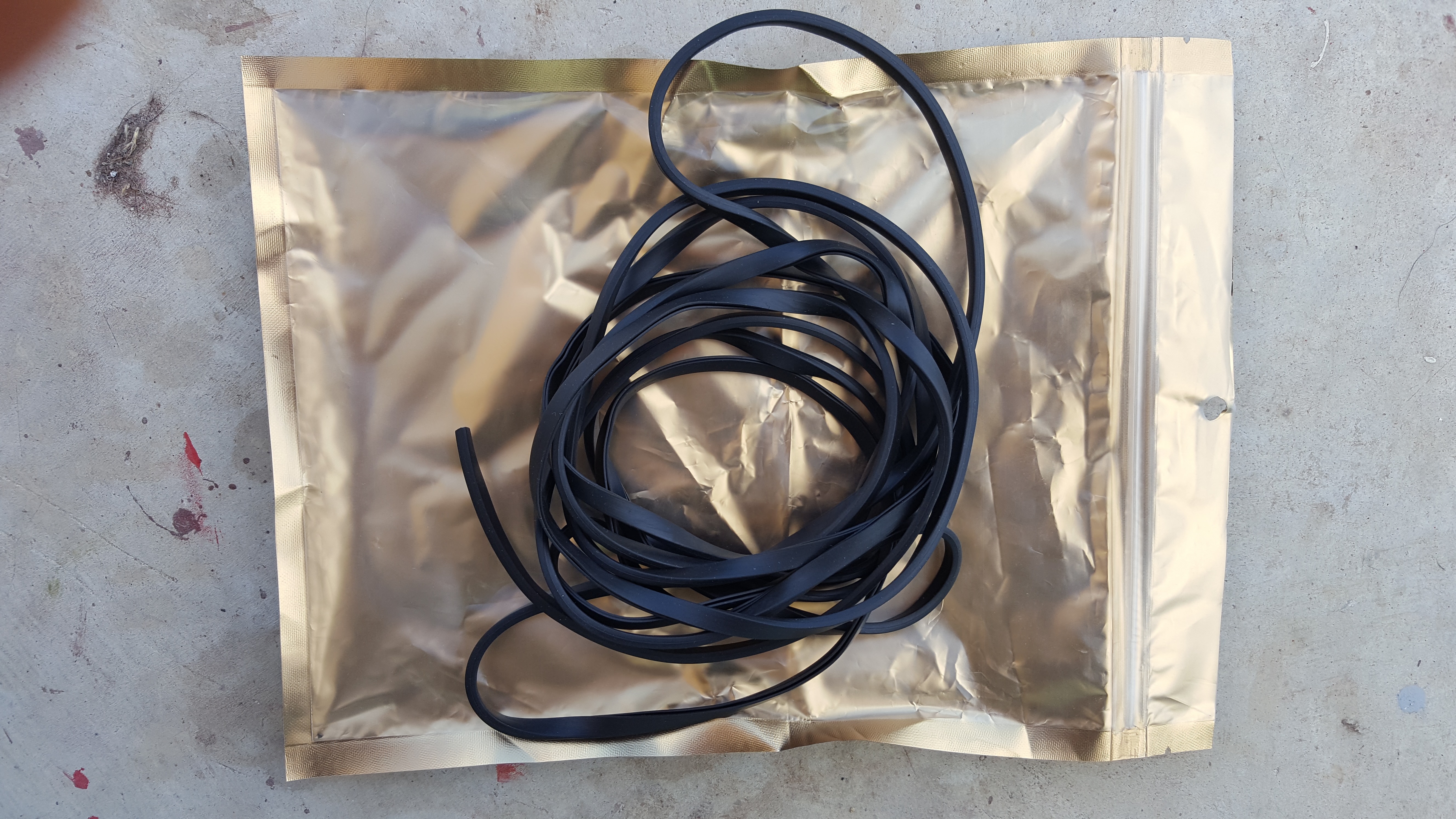

Along the edge of the pan its thin sheet metal and I have bought some edging for this gauge of sheet metal that I will use all around the edges of this pan. This is to protect the new cover from the sharp edge of the metal. Now, this edging I will use on my Bultaco Sherpa S 100cc that I have started restoring also. Its pan I have repaired all ready. This edging also I will use on some on my air cleaner screens. I think from the factory the screen originally had some edging but it has long since rotted off. Take a look. The edging I found on Ebay. Dad Gum Ebay has everything! I buy all kinds of things I need there. Its the best place to by from.

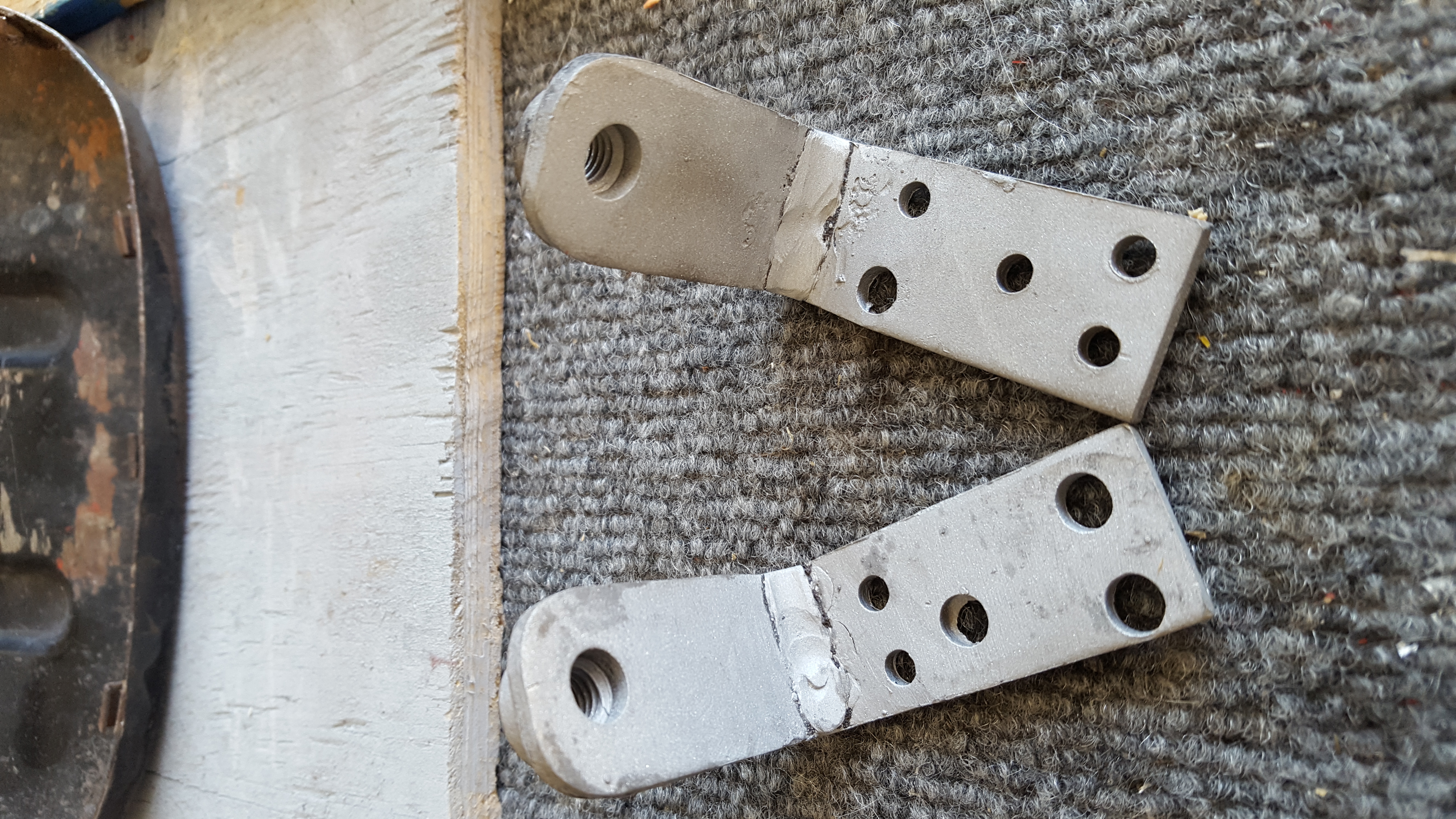

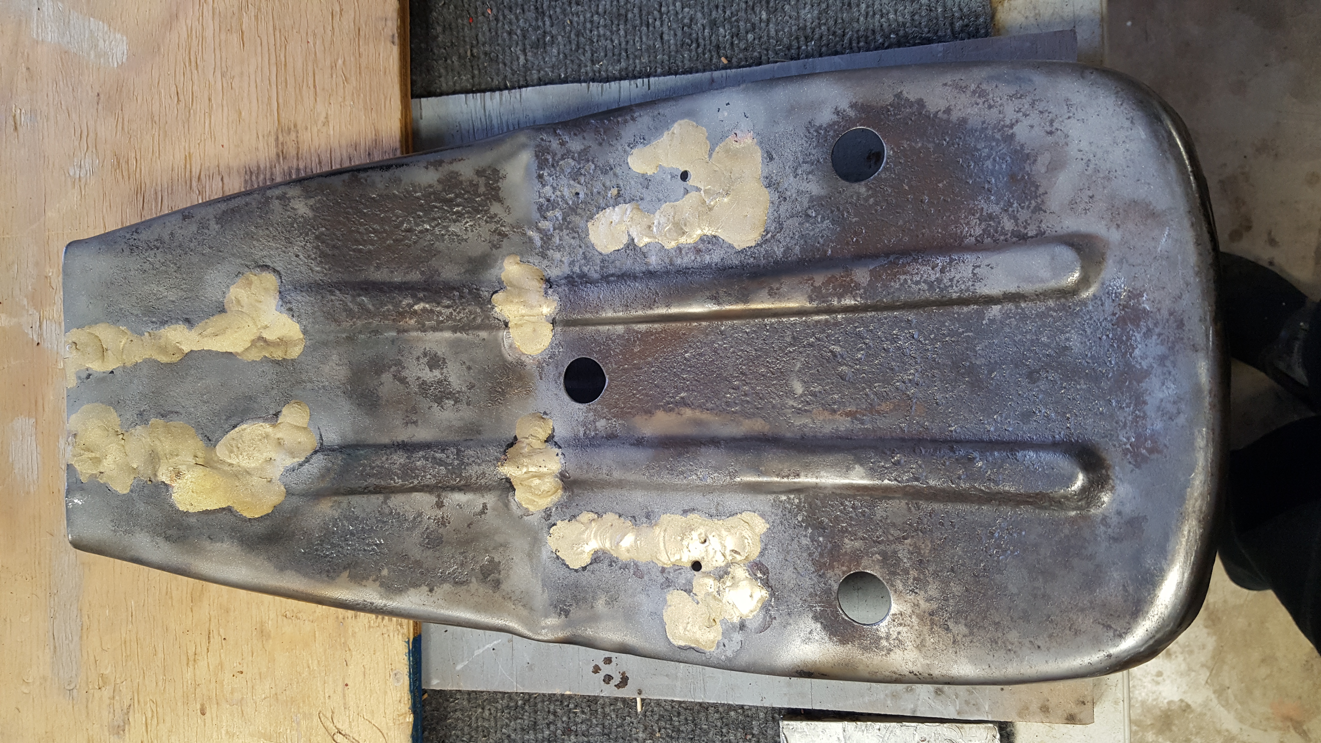

Merry Christmas! Today I finished the W.A.R. on my seat pan. Leaving off from yesterday I needed to put the rear bolting ears back on and finish welding the seat up. And that's what I did today. The ears were broken and had been welded in the past. I welded them some more after removing some of the old weld and made sure they were welded good. Then I positioned them back on the seat pan exactly where they were before and welded them back on using brass brazing rod. Then I inspected for anymore cracks in the sheet metal and repaired them as well. There were cracks everywhere. Also, the rust was so bad that the pan was getting holes rusted through. In these areas I also put a layer of brass over these area to strengthen them. Everything came out real nice. I did not end
up using a reinforcement plate like I stated yesterday. It would not be original if I did. Now that I am done with W.A.R. on my seat pan. I will sand blast it good, paint it, and then recover it. I need to order a new foam and cover asap tomorrow. Anyway take a look

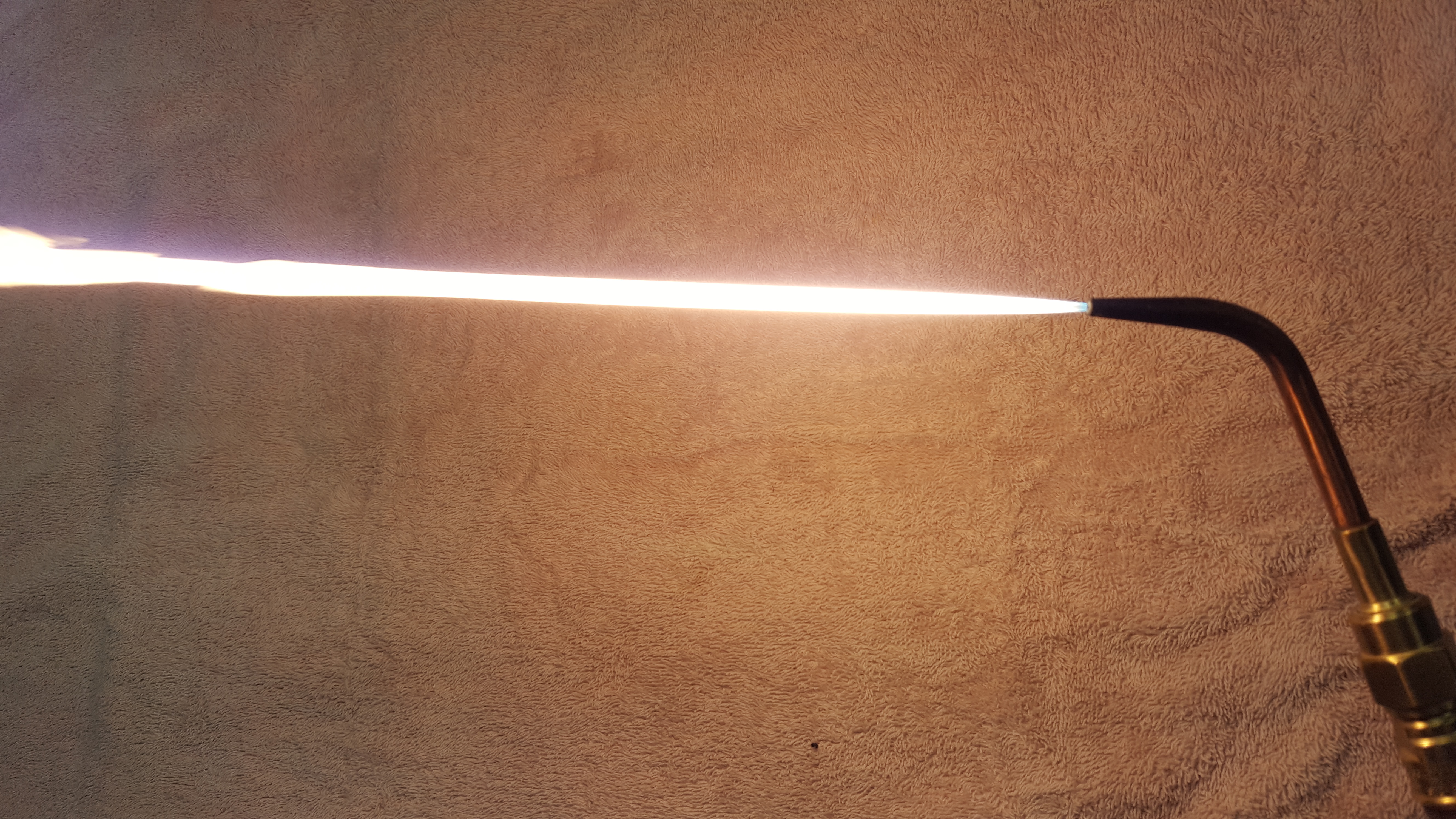

Next, the flame of the torch tip is very important to adjust correctly. Look at the pics I will post that show the correct flame. You adjust your oxygen to get the desired flame. The acetylene you adjust for the size of the flame you want. Also I used a Victor torch tip size O-W-1 This tip works good for this gauge sheet metal we are using. You do not want to get too much heat or you will melt through the sheet metal. Refer to my pics for flame type and the color of the metal when its heated and ready to apply the brass. You must have the metal glowing orange or the brass will not adhere to the metal! Very important. Preheat the metal until its glowing orange and then put the end of the brass rod touching the heated area and into the flame and it will melt.The brass will flow towards the heat. You will see this when you do it yourself. Then you move along with the torch tip heating the metal and melting your rod at the same time. You can move the flame around and smooth the brass out nicely. You can go over the area again to build it up. You should also practice on some sheet metal of similar gauge to become confident before you try your new skills on your pan. That's what you need to do.

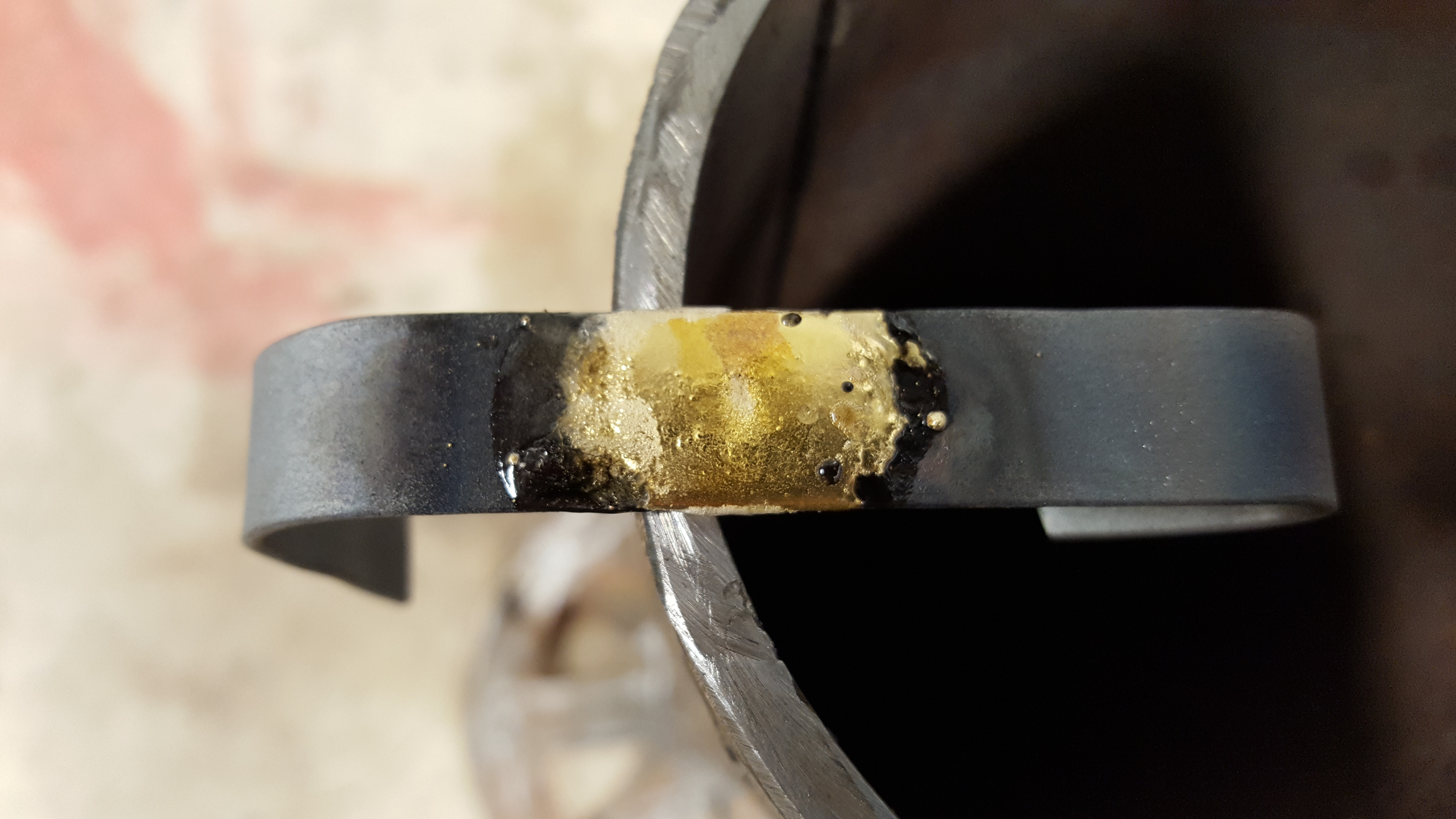

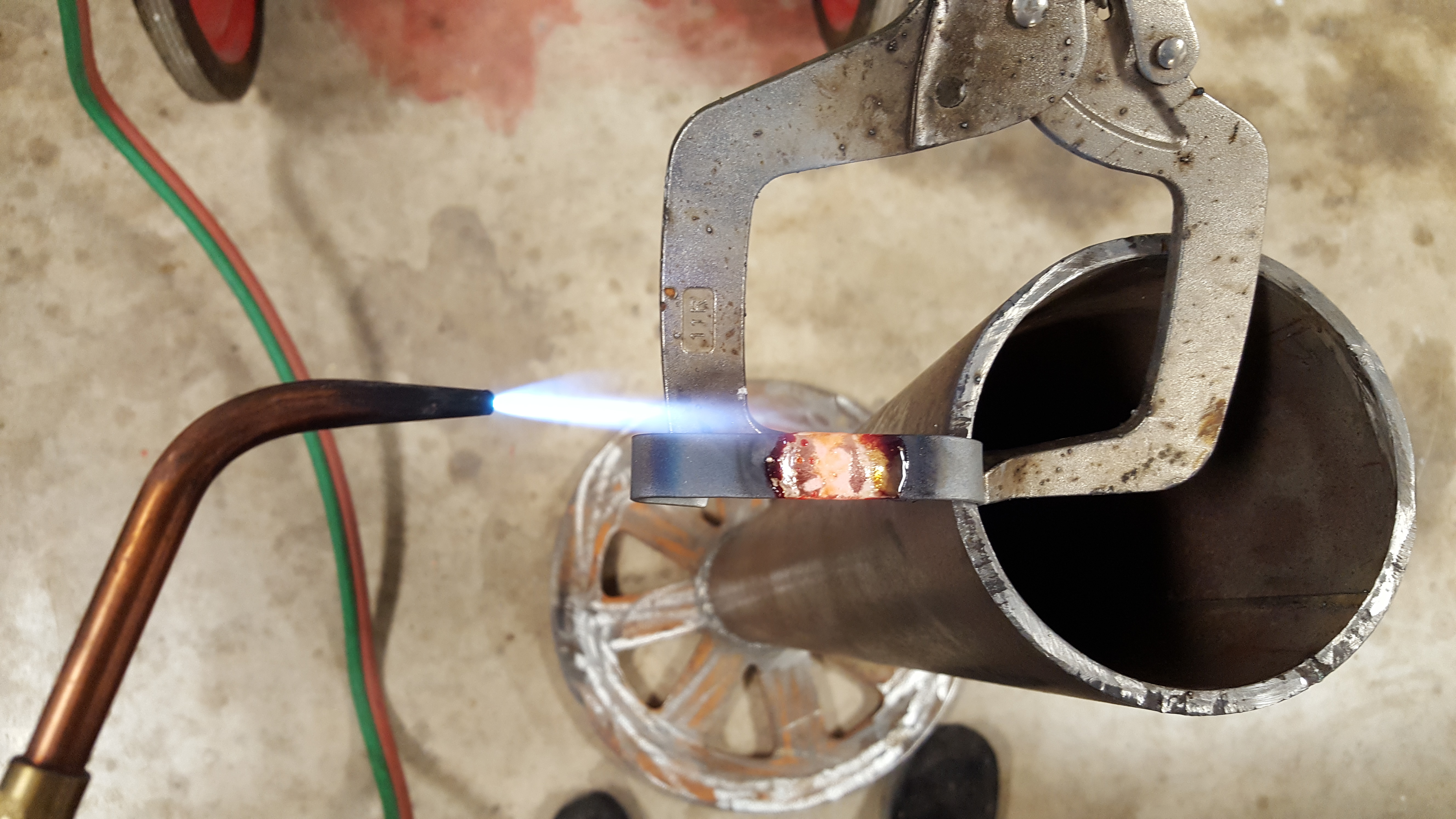

Ok gentlemen here are some more pics to go with my post. Note the white rod in the necessary equipment pic, that's you flux covered 3/32 inch dia. brass rod. They come in three foot lengths.
Make sure to get the correct flame configuration before you start.

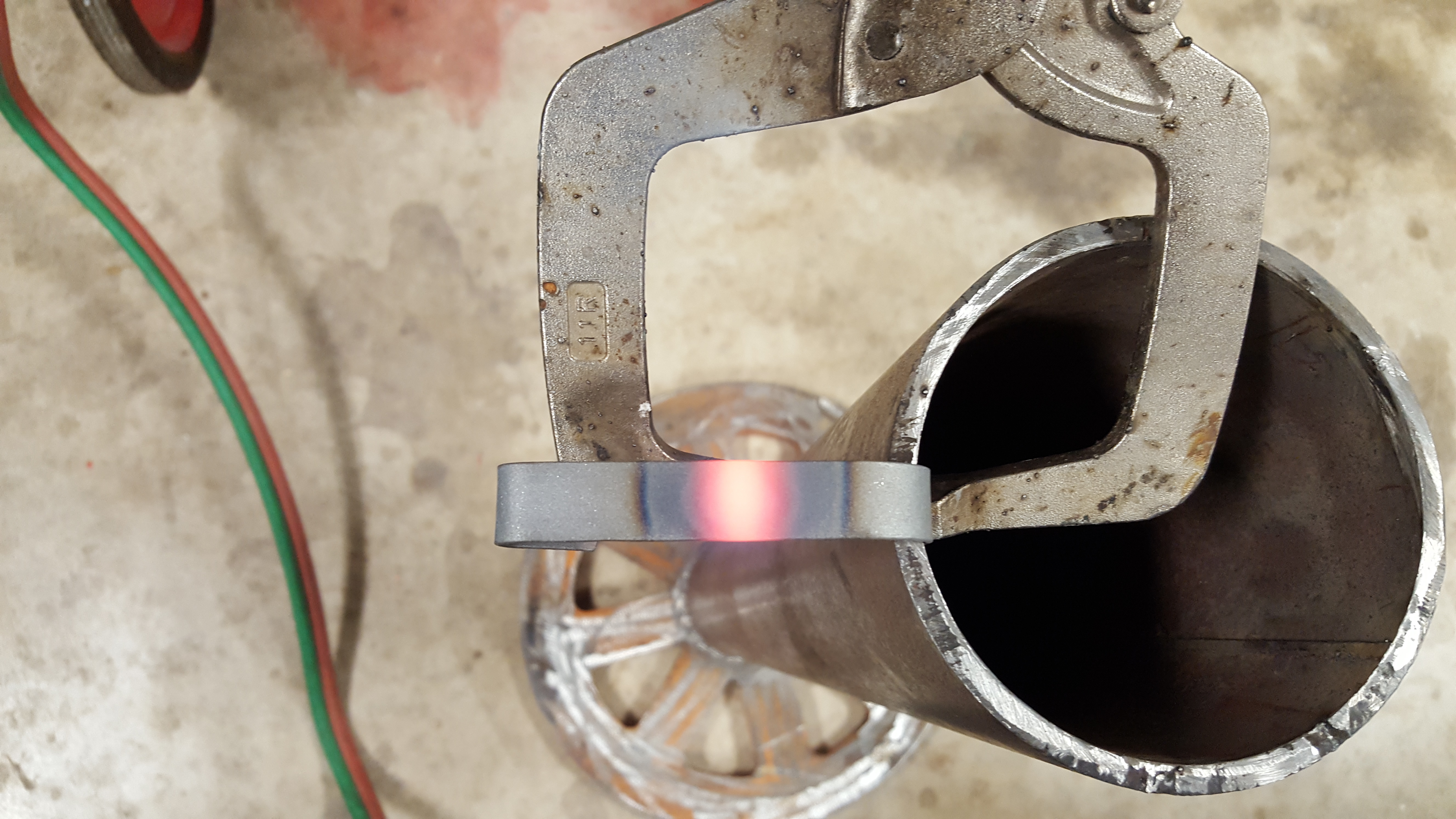

Look at the bright orange color of the metal after I preheated it, bright orange, you are ready to touch your brass rod to that area. Then use the flame to melt the rod.
Look at the laying down brass pic. See how nice it goes on.
Then you have it cooled down, it looks good.

Just a few notes, Remember to clean every thing down to bare metal, either grinding, sand blasting, etc. Use a dissimilar metal such as aluminum to back up the area where you want to repair. It keeps the molten brass from falling through and helps to keep the metal from warping from the heat when its clamped. The brass should not stick to aluminum either. Don't use steel because it can get welded to your seat pan also. Using an aluminum back up piece is how I filled in the holes on the bolting ears with. I had it underneath the holes and filled them up from the top. I hope this was informative to my brothers in Hodaka. If you have questions just asked. One last thing, be extremely carefull with the flame of your torch. Its super, super hot. You do not want to get burned by that. I have been a welder since I was 15 years old and I have never been burned to where I needed medical attention and I do not want to ever.
