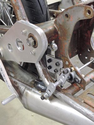

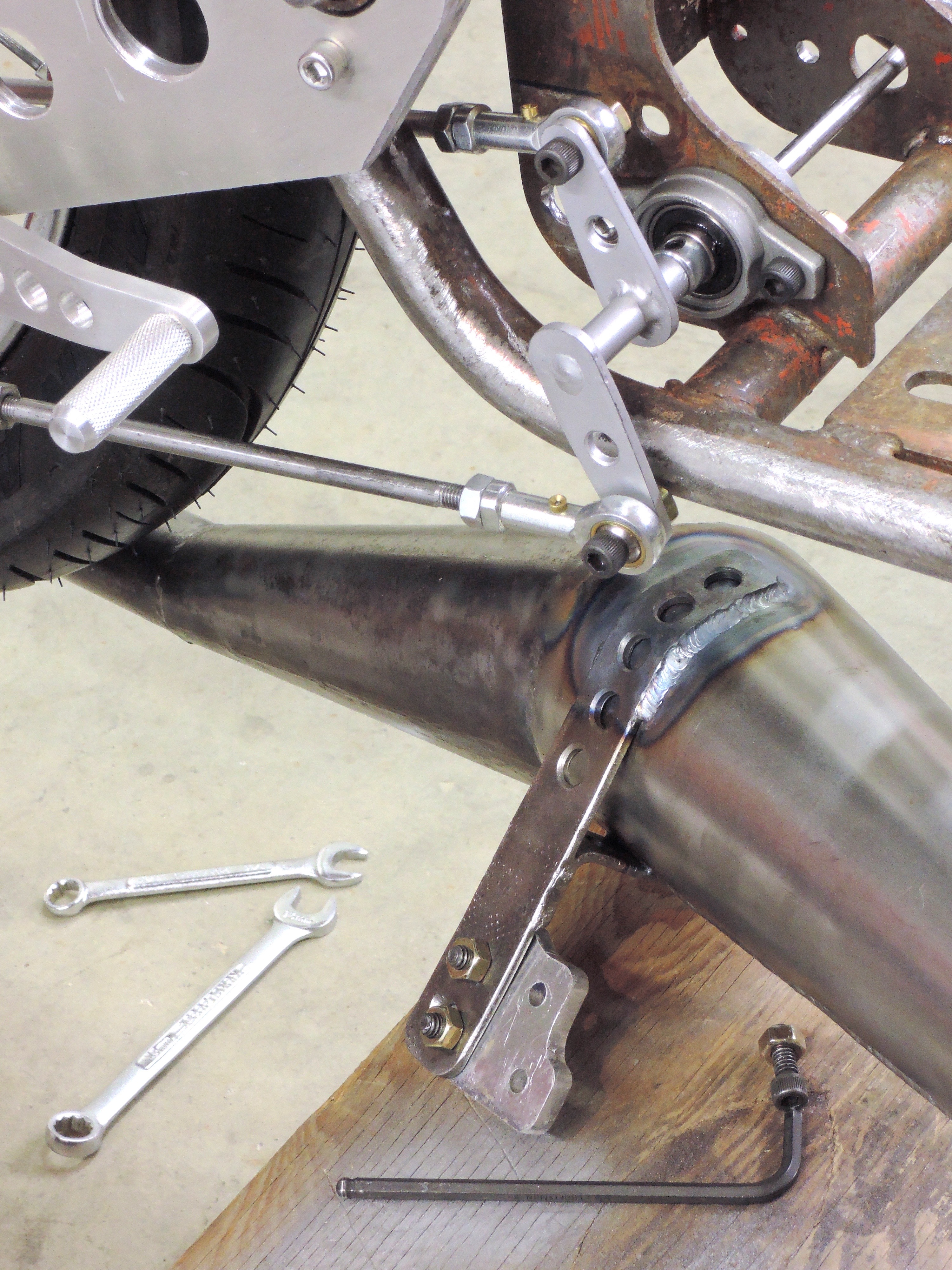

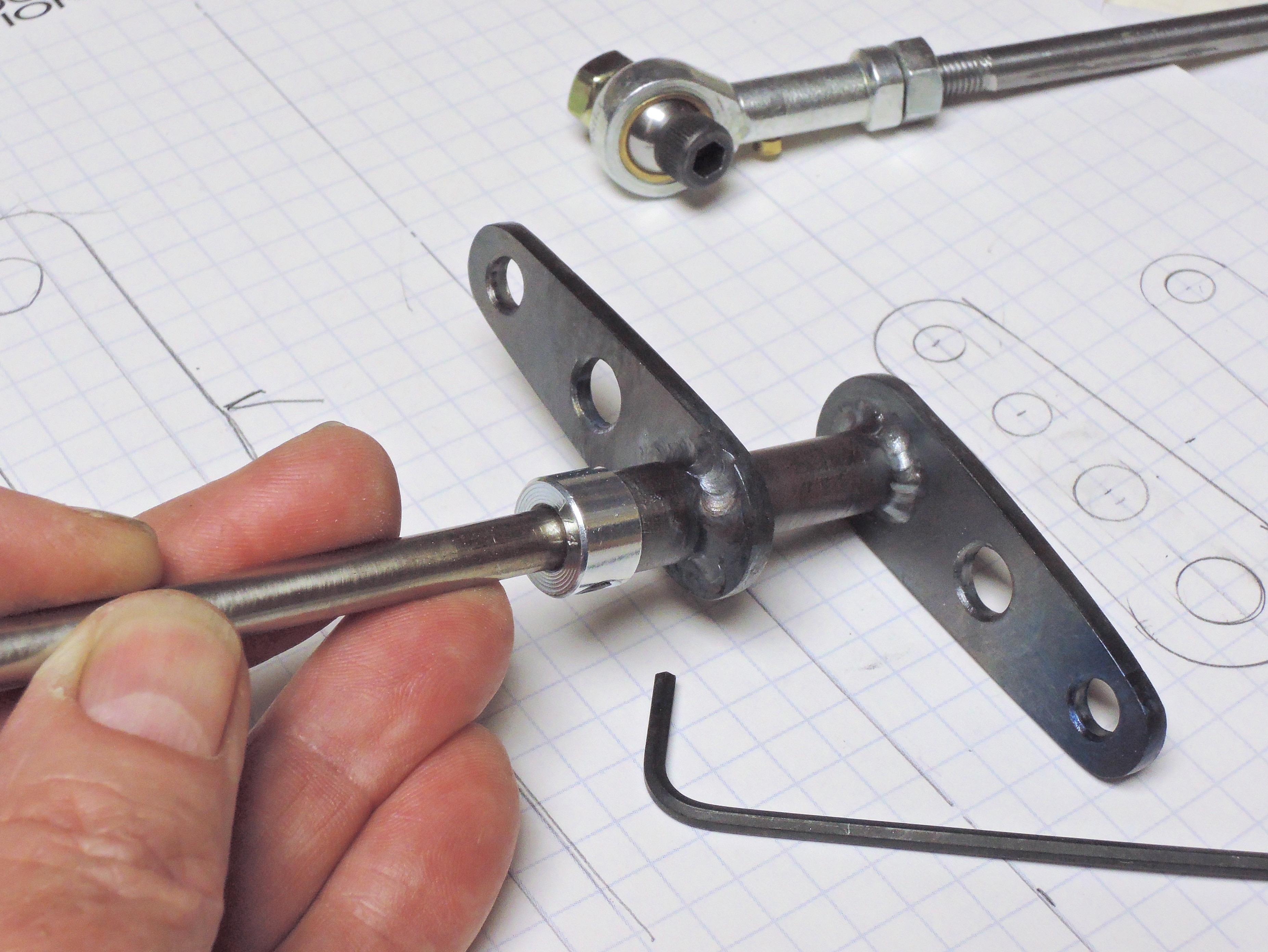

Back to the pipe. Final welding of the pipe mount and a bracket to mount it to the frame. The DPO had used up the previous mounting area with a series of holes, all not in the right area and I'd moved the manufacturers pipe bracket slightly to fit all this new linkage in. I did ventilate the pipe bracket while it was off and got one more ugly ounce off of it. 8-)
First I built a two hole steel bracket for pipe to frame that looked weak and tacky for sure. The bracket and frame needed more than one hole each and a mount that exploited our theme of mechanical complication. Right or wrong this is how I did it. Remember our new standard of "Better to look good than to be practical" :roll:
Well, that was fun and entertained me and does look somewhat mechanically complicated, even functional. Two or three requirements met. :)
I think it's ready for some VHT flat black coating.
Final lightening and welding of the pipe mount
Better to look good than to be practical.

Since the point of the exercise is to look good rather than be practical, I won't point out to you that at least half (if not just a bit more) of the welded bracket is pointless at this point because you welded right up to the midpoint of one of your lightening holes, reducing the strap width to a small fraction of the original width, and creating a stress point at the midpoint of that half supported hole, which will sooner or later result in a fracture at the point the weld ends on either side of the hole. And because your bracket looks really nice, I won't point out that the bead material on the too long strap weighs more than the metal removed by drilling really lovely holes. This opinion is worth every nickel you paid for it.

Buzz off Jack, seriously.

(tee hee) I thought the rule was something like "Simplicate and add lightness." But "Complicate and add lightness" at least has a similar sound. ;)

Those sure are beautiful wields.------------Clarence

Bullfrog wrote:(tee hee) I thought the rule was something like "Simplicate and add lightness." But "Complicate and add lightness" at least has a similar sound. ;)
Ah, the theme and rules are like a river, fluid and ever changing. :lol:

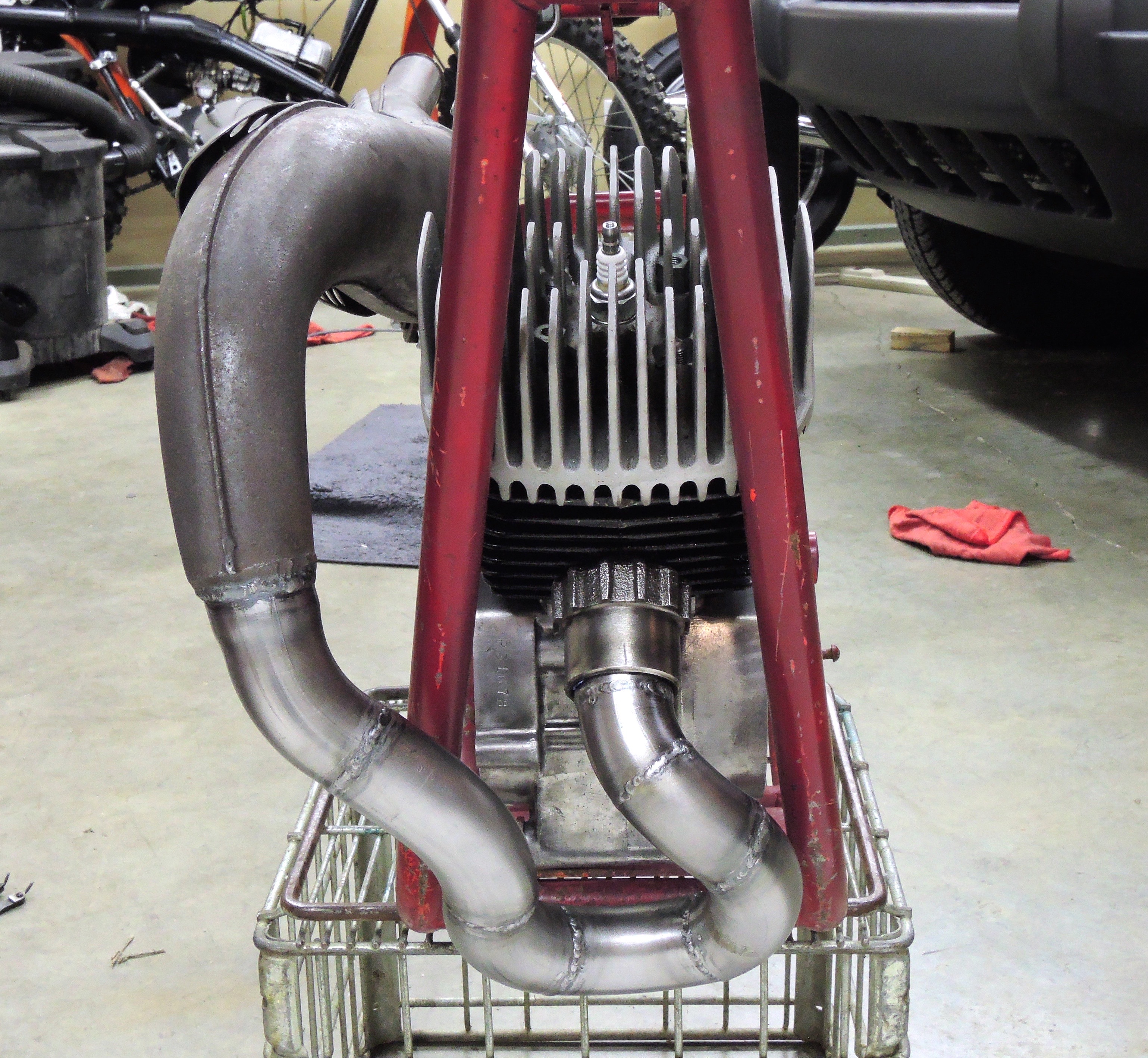

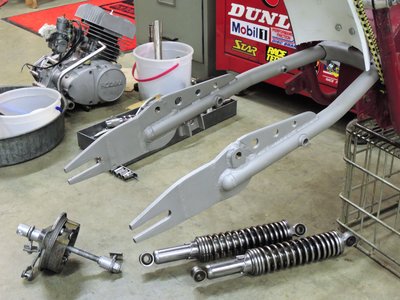

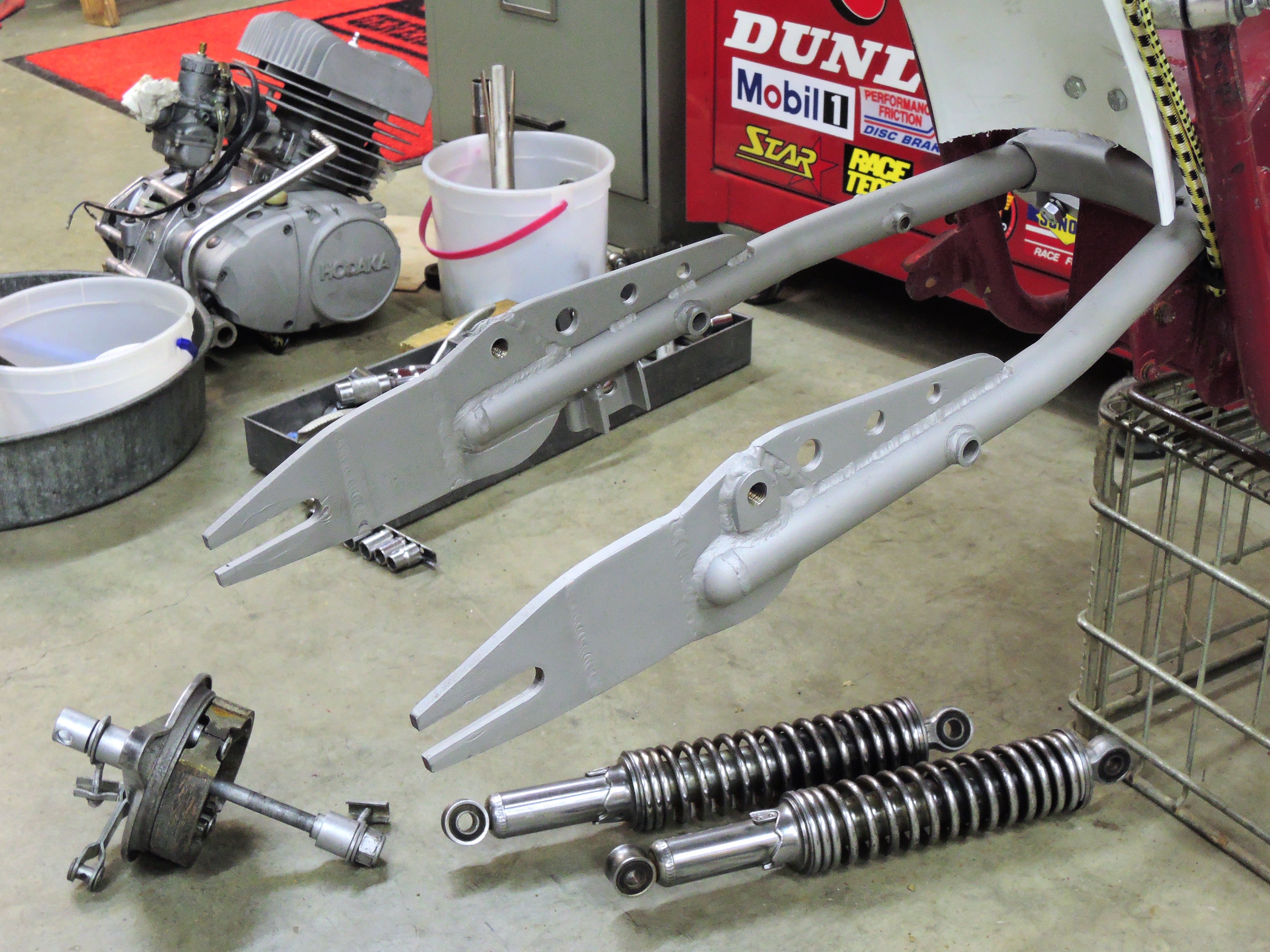

Hey Clarence, Yes! Rod Blackburn at his Hot Rod Shop is quite the welder. What an asset for a project. This is why Max doesn't weld. I think he likes my projects and puts up with me as a walk in customer. He also did all the welding on the Day One Project. I'm really looking forward to the frame part of the project which will require a lot of his expertise undoing the DPO work and fabricating fork stops and such. Art for sure!
One more, making exhausts go anywhere!
Nice work by Rod on the Day One project extended swing arm
Art by Rod
Art by Rod

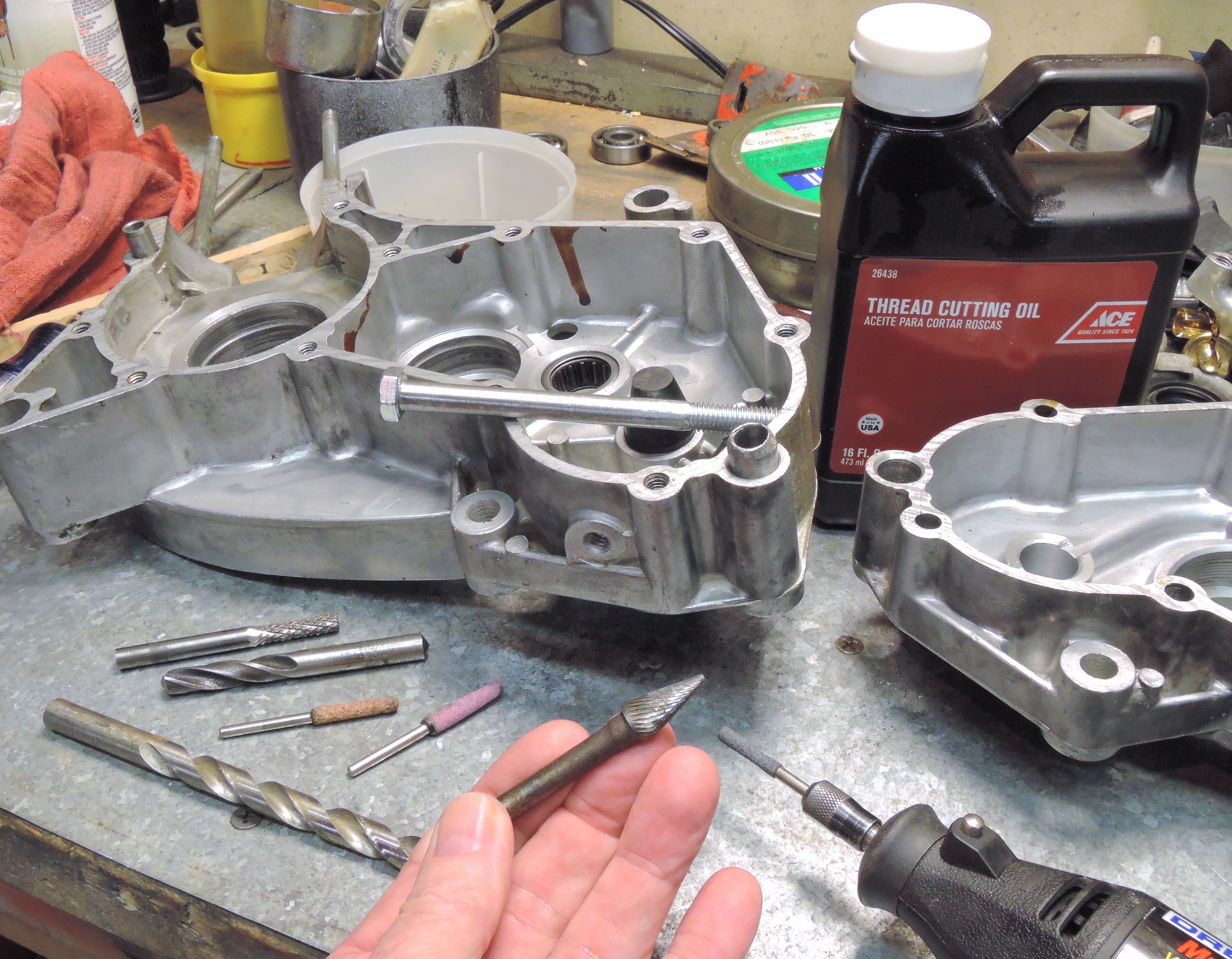

A minor report to keep things more or less current and to show how a DPO can add hours if not days to a project like this. I mentioned awhile back about the DPO apparently losing the rear alignment dowel and making a replacement with some kind of piston pin. The O.D. was perfect but as I discovered in the mock-up the rear engine mount bolt wouldn't go through the engine. No problem for the DPO, as he probably just used a smaller carriage or square-headed farm bolt.
Seems like a somewhat simple fix, let's just enlarge the hole through the fake dowel. Hmm, this thing seems to be made of Kryptonite. Metal files come out with no metal on them. After rounding off a couple of drill bits even with thread cutter oil, I've only about a millimeter of progress along the length. OK, let's grind it out with the Dremel tool, I only need a a few thousandths. After turning three bits to sand and using up some of an hour, It's time to try something else. I've go lotsa expensive die grinder rotary files but if it's that hard I'd hate to dull something that eats cast iron. More digging and I find a worn rotary tapered file that the large end is exactly the size I need. Wow, this file is harder than Kryptonite and eats through the hole enlargement in seconds but not without finishing off the well worn file.
We'll that's how you spend two hours reversing the negative progress of a DPO and why these projects take so long. In reality its just about problem solving, minor challenges are good for the brain and part of a project. :?
PS--Hey, the engine is on the bench!
Reversing negative DPO Progress.

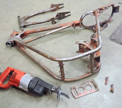

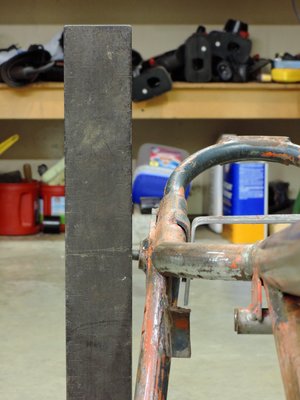

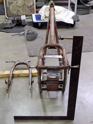

Now that I have most major mechanical linkages, forks and such figured out, It's time for some frame repairs and fork stops. Were do I start? Plenty of options here. I did get the swing arm plates back to spec awhile back when figuring out the wheel combos. Let's move forward, so to speak, and start with the upper rear shock mount that has quite a mis-alignment with the swing arm end.
I'm beginning to think this specimen was ran over by a truck or fell off a trailer rather than a racing accident as some of the things I'm seeing would be hard to do. The main frame measures straight but there's several things tweaked. The plate holding the rear shock is where the twist is in this case. One step at a time here. :? The plan here is to straighten everything I can and then go to the blaster to prepare for welding.
Minor report here.
Check out DPO work.
Check out DPO work.

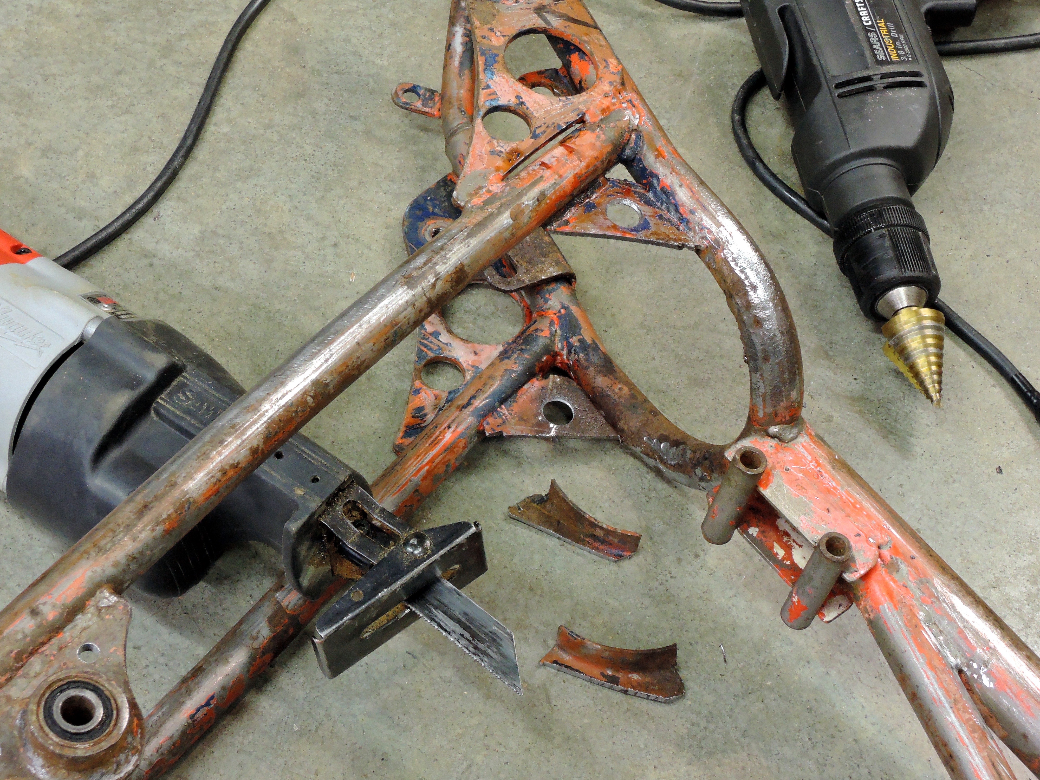

Re: The 2 the Max Project
Termites.
One more ugly pound.
Weight loss program.

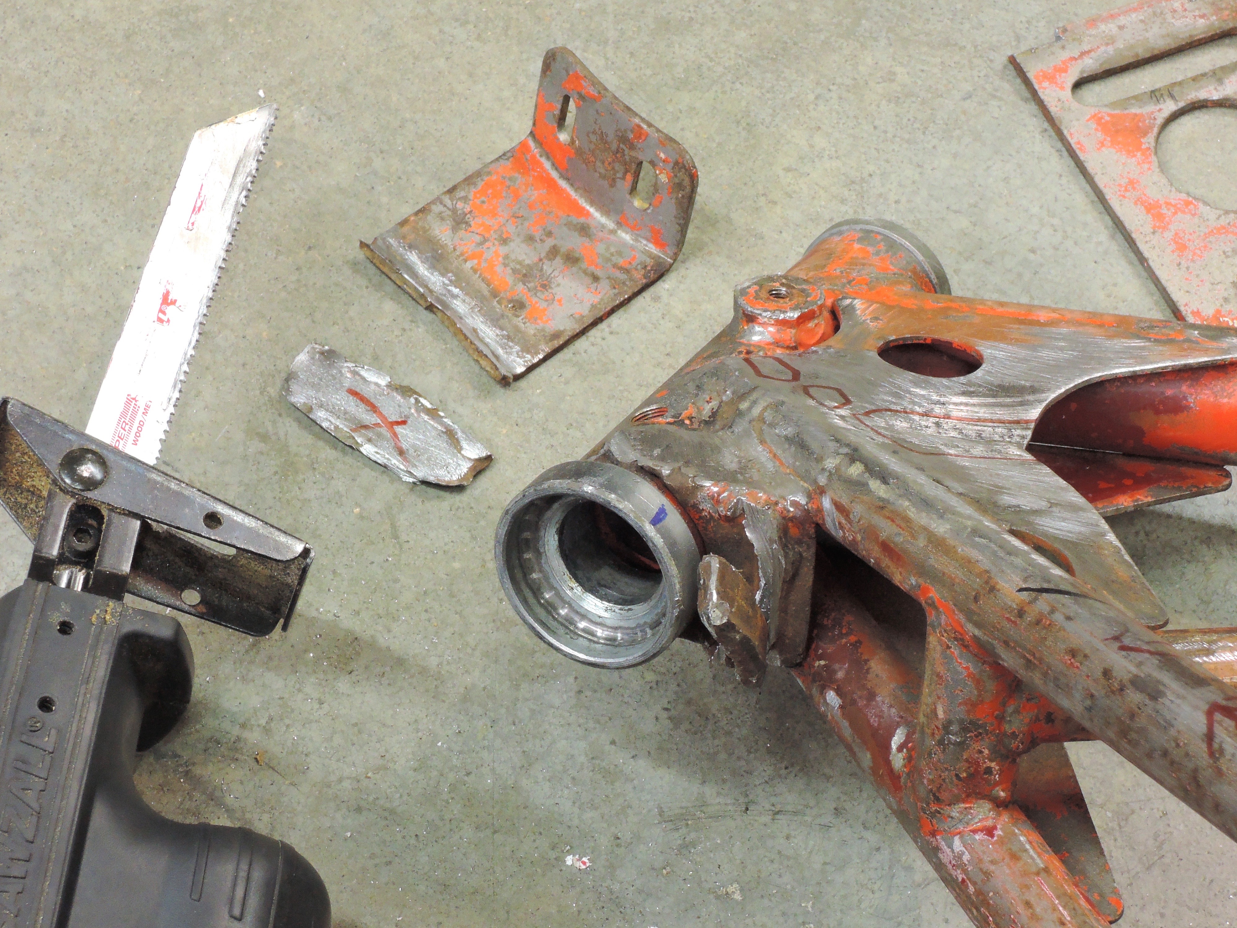

My, that Sawzall is a mean machine! I did get the broken rear fender bracket cut off. Again, it was broken where the DPO had re-enforced it. I broke the top part off with my hand. I also got most of the fork stops and other crudeness removed. A bit of work with the die grinders and I think I can save all this. My wife said (not too seriously) that I'd made enough noise and that I should give it up for the day. Yes Dear, I said. I'd already had enough fun already. 8-)
Progress on the project!
