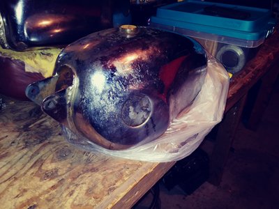

Here's the rusted out tank the bike came with. It has good tabs, even has the rubber grommets. The chrome isn't as good as the tank with the chewed up tabs. It has rusted out holes in the underside :(
Re: new owner, need advice
As always, Jack is spot on. I would add only a couple additional tidbits. After emptying and rinsing out the chelation treatment the inside of the tank will flash rust-over immediately - practically as you watch - or so I've read :-). If the integrity of the tank is confirmed (no rust through leaks) and the tank will not be immediately sealed or filled with fuel and returned to service, give it a good swish with premix and leave some in the tank swishing occasionally. WD40 is also a decent rust preventative. Empty any residue and flush the tank with fresh fuel and discard the flush prior to filling the tank for the maiden voyage. Always use an inline fuel filter. The use of a tank sealant in a nonleaking tank is debatable. I've rescued three chrome (toaster) Hodaka tanks and one aluminum alloy Suzuki RM tank using Caswell 2-part epoxy with zero failures. Follow the instructions EXACTLY. If you can find it, get the 2-part burst pack for simplicity and no mess.
