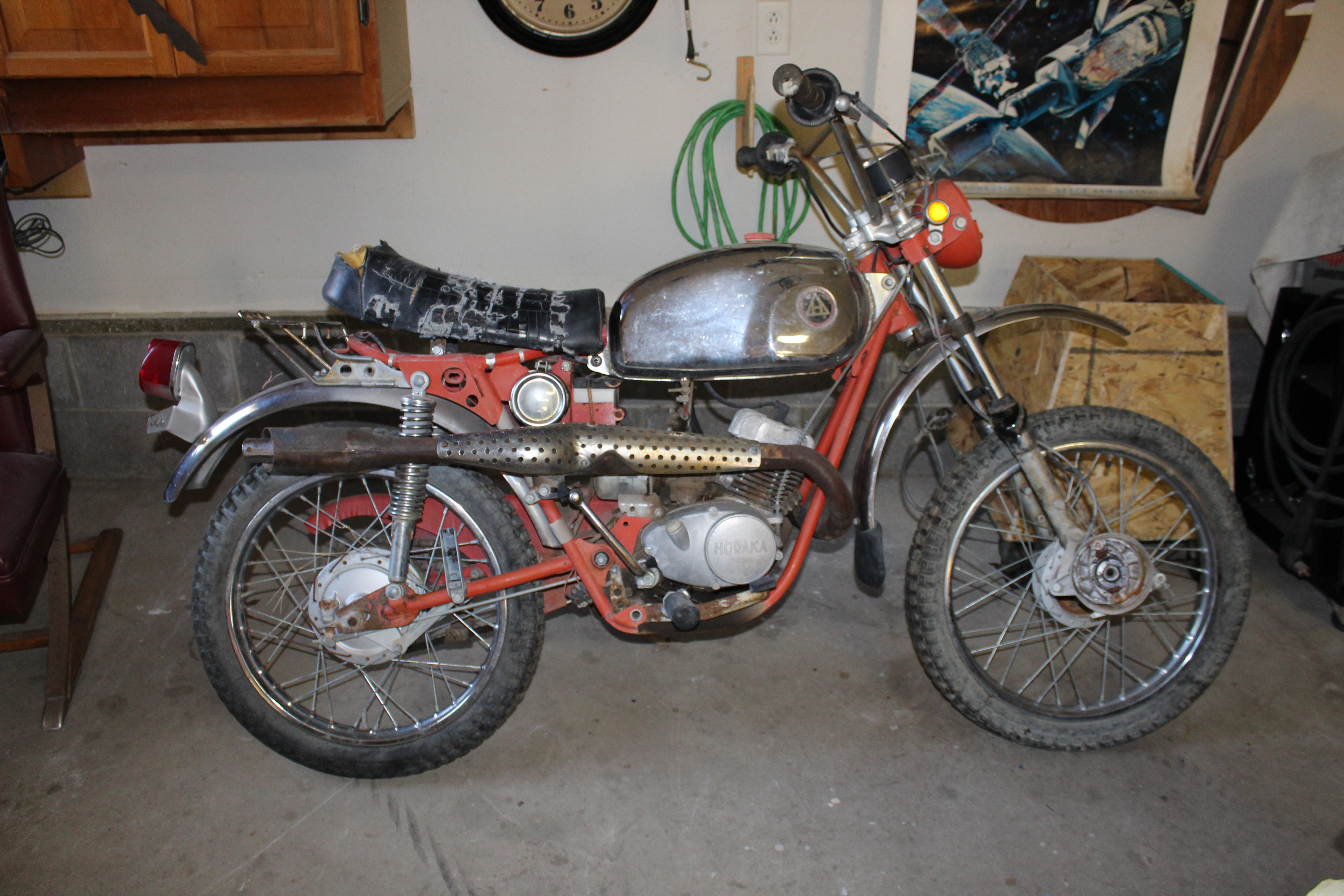

new owner, need advice

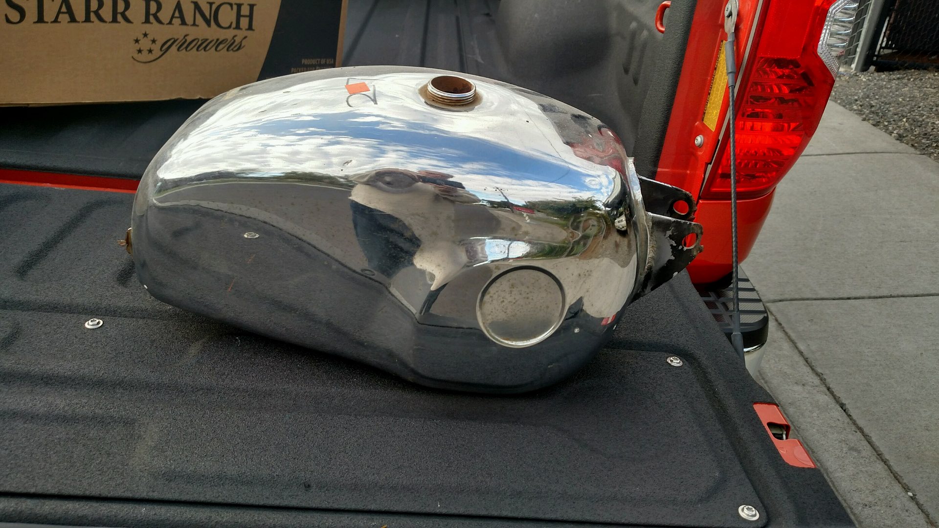

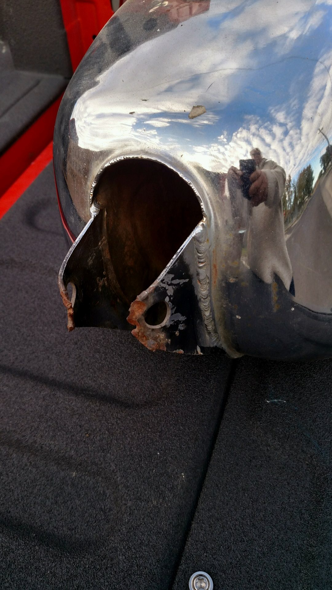

Wow! Hopefully they can pound them out and weld on without damaging the chrome anywhere but the tabs???
I think I would sand the tabs really good after the weld and spray paint just the tabs silver so you don’t have to rechrome the whole tank, unless that’s your plan?

Ya, hope so. The shop had just closed when I got there but they told me they will give me a quote this week. The spray is a good idea. But then, theres always the silver powder coating idea I saw on here somewhere ...

Show us more pictures of the tank. It looks too good to alter the chrome, you could also paint the tabs white. Your chrome really looks nice, would the tabs function if they were just aligned? ---------Clarence
Re: new owner, need advice
Agreed. Those tabs look like they would work with a little blacksmithery. Looks like it might have been dropped on the tabs.

Clarence, I'll take some close ups of the tabs when I get home later. They aren't too bad. Maybe they can just straighten them out and build up the metal a bit. There is one tab missing, but it's one that's under the seat so it won't really show when it's back on the bike. I can't bring the tank back in to the machine shop til tomorrow.

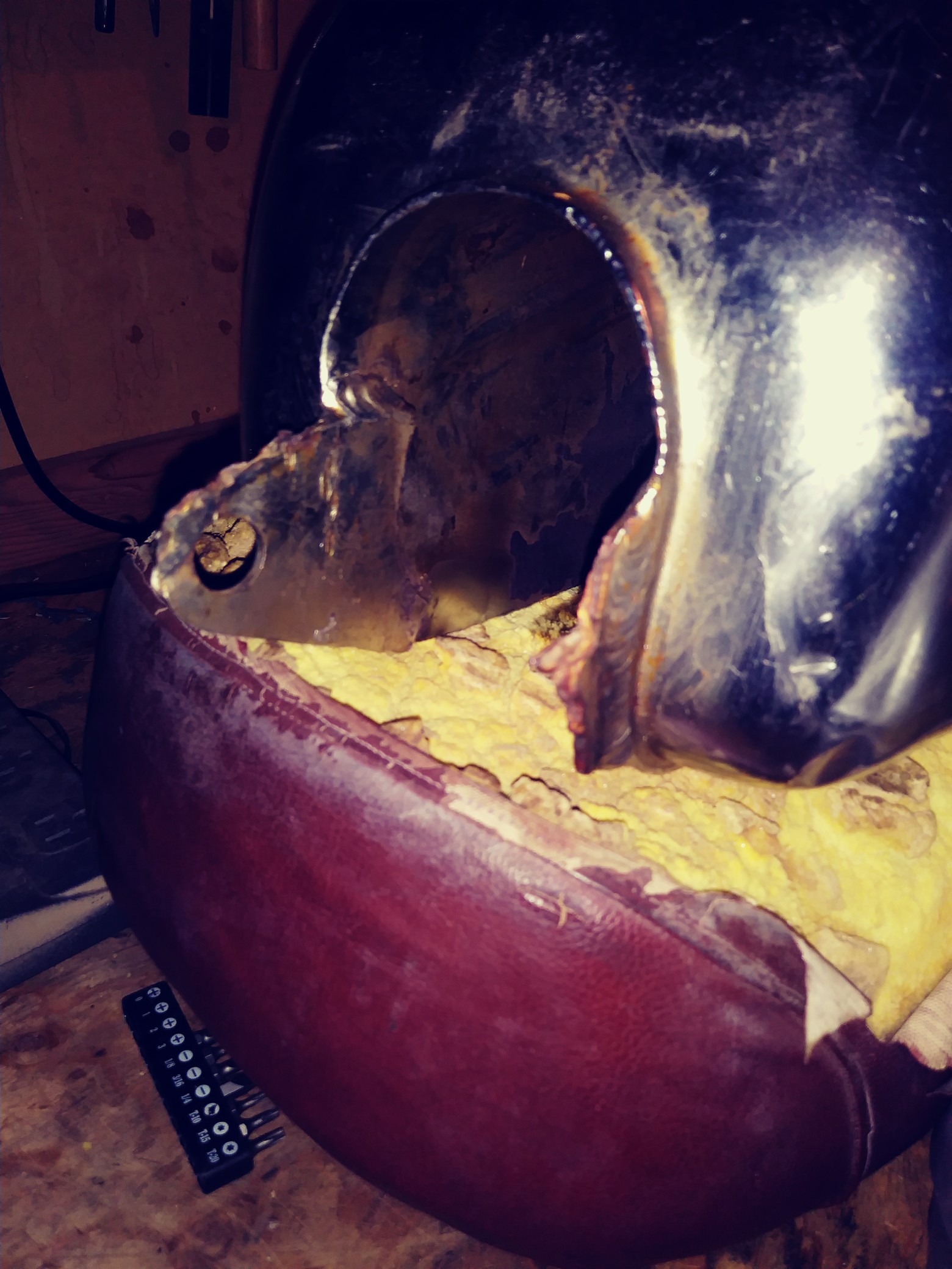

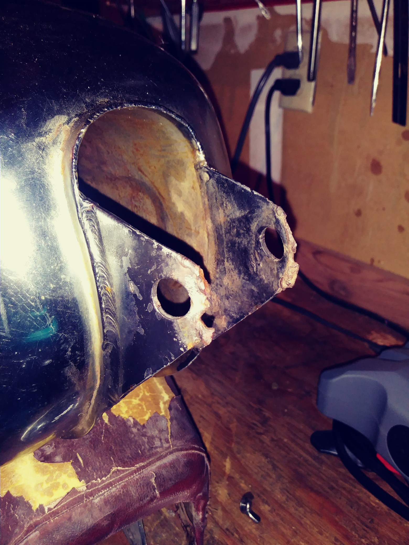

Here's pics of those fuel tank brackets for your viewing pleasure. Thoughts??

I would not cut the tabs off and reweld, as this will almost certainly affect the chrome on the tank in proximity. Instead, I would straighten and flatten carefully, and if necessary, weld a washer on either side to reinforce each hole. Since the holes are covered by rubber grommets anyway, you won't really see a washer tack welded to the tab. And I would then paint the tabs with chrome or aluminum paint. The repairs should about disappear.

Great insights Jack. But what about the rear tab which is broken nearly all the way off? They will need to weld something in its place. They can cut and shape a new piece with a correct sized hole in it. Then weld it on over the remaining piece starting as far back from the tank as possible. This should keep the chrome from changing too much, right?
