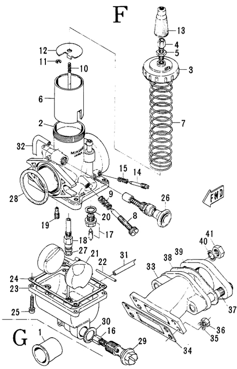

Here is a copy of carb page from the Wbat94 parts book:
Re: Mikuni carb and o-ring problem
The o-ring is #27 and only one is used. It should seal the "annulus" between the needle jet carrier #18 and the main jet cavity in the float bowl. It must seal-- any leakage upsets the fuel flow through the main jet to the needle jet. I don't recall the width of that o-ring groove, but one o-ring will work and two should be fine.
