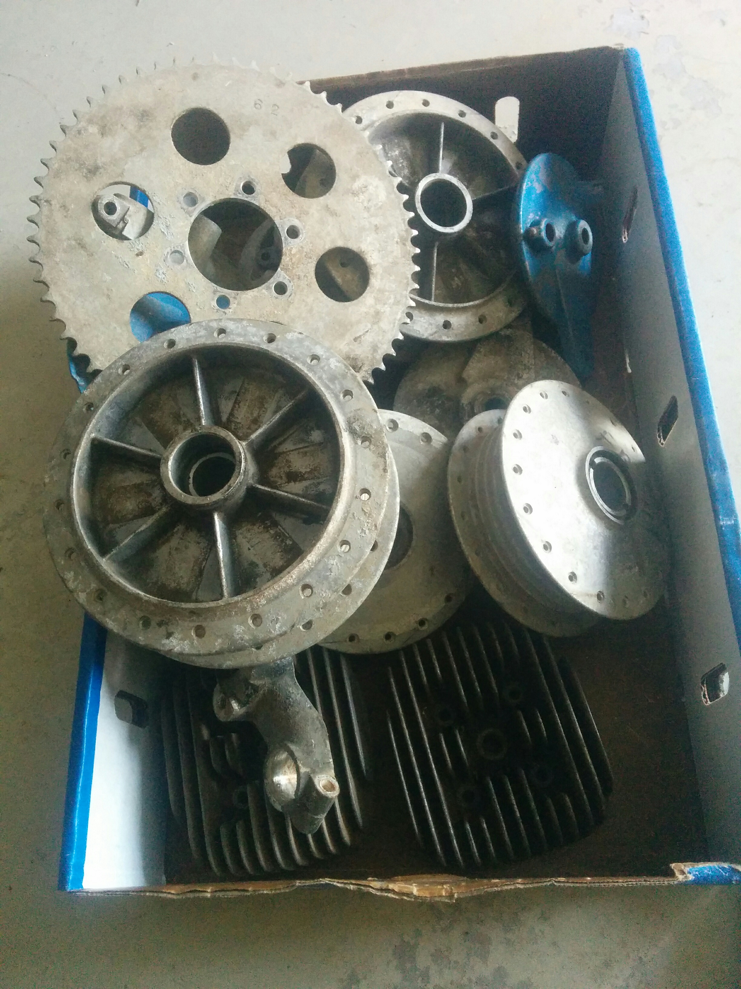

Personally I wouldn't go the Soda route again. I had an XL250 engine done once, and maybe it was a crap operator, but it was rubbish.
Had the Hodie parts vapour blased:
Just streets ahead of Soda
