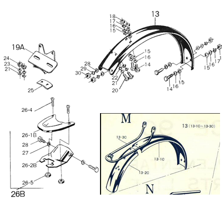

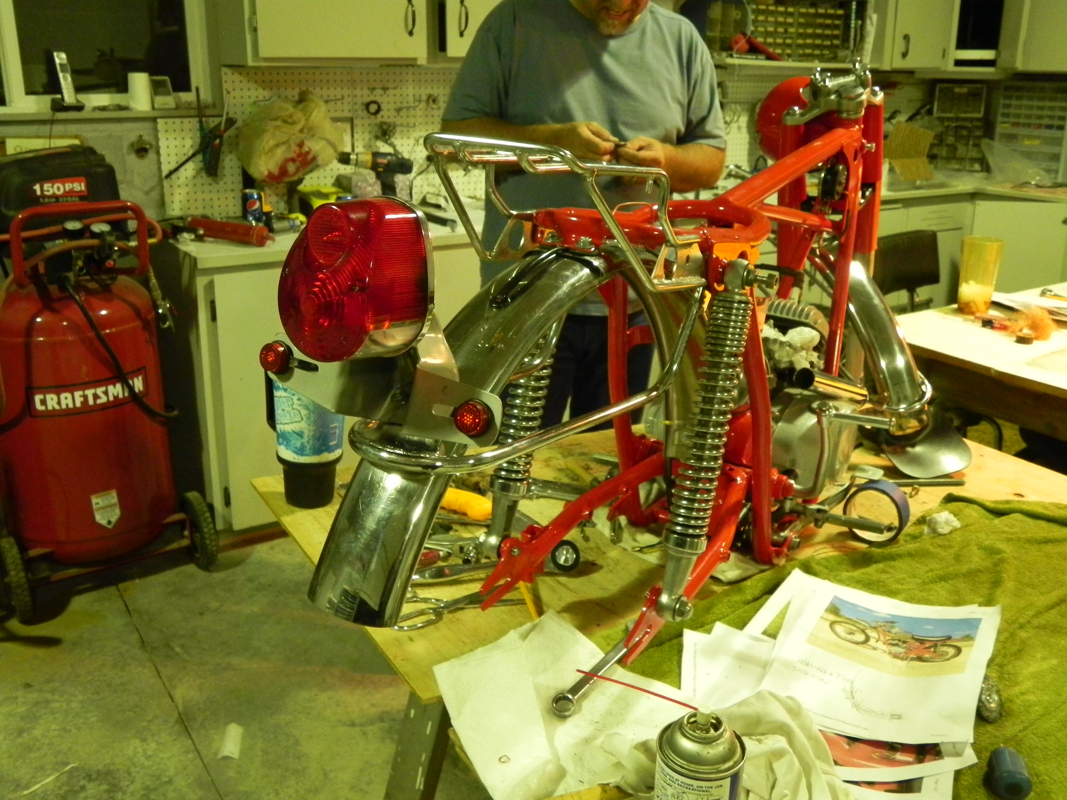

In regards to your taillight, you have the correct taillight, but for a later Ace 90 that incorporated a two piece fender and fender support bracket. I believe your one piece fender is probably correct for your early Ace 90 built in 1965. The Ace 90 Manual will give you the serial number for when that switch was made. The taillight that was installed on the early Ace 90's was a lucas style taillight which was already shown above. On your one piece fender there are two hole on the sides, near the end of the fender, these were to mount a ducktail rubber flap.
This shows the difference between the two: (The yellowed inset is the later style)

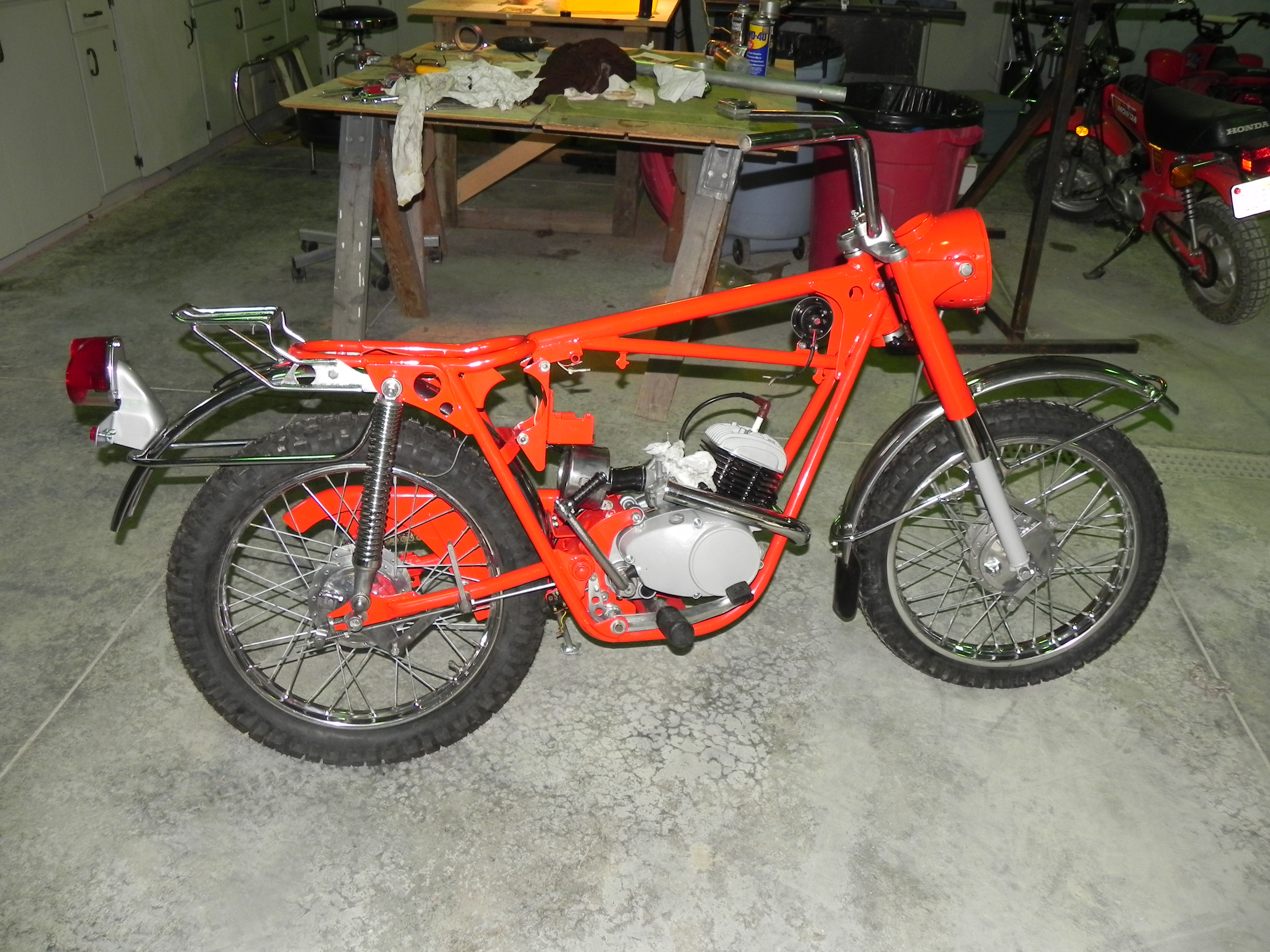

I just wanted to say one more thing on the issue. I thank the Heavens for Bruce in Idaho. He made me bundle deals and kept the cost of this build under control. For as vague as I have been, he did a great job of filling my orders. The only reason I was concerned about the ignition is the amca rule book. So, all in all , after all that, one piece didn't match up. The tail light. I think that was a great job, considering the 3000 or so miles in between.

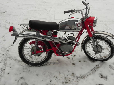

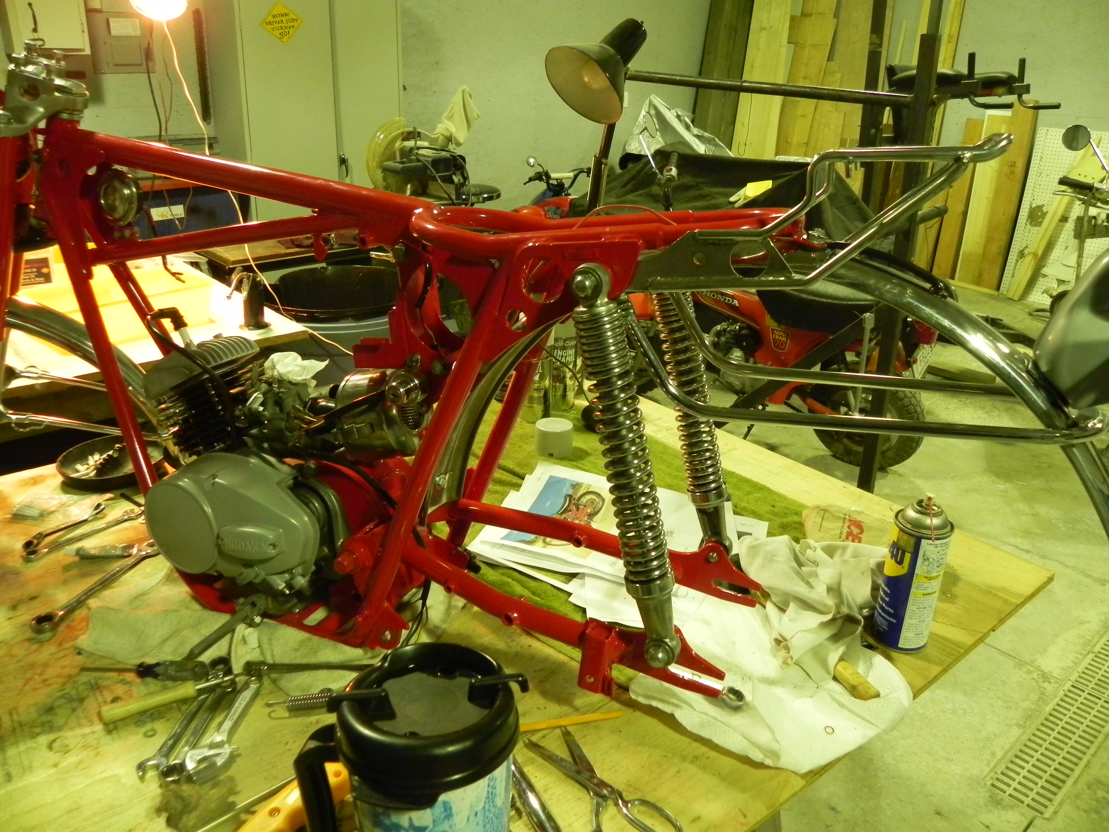

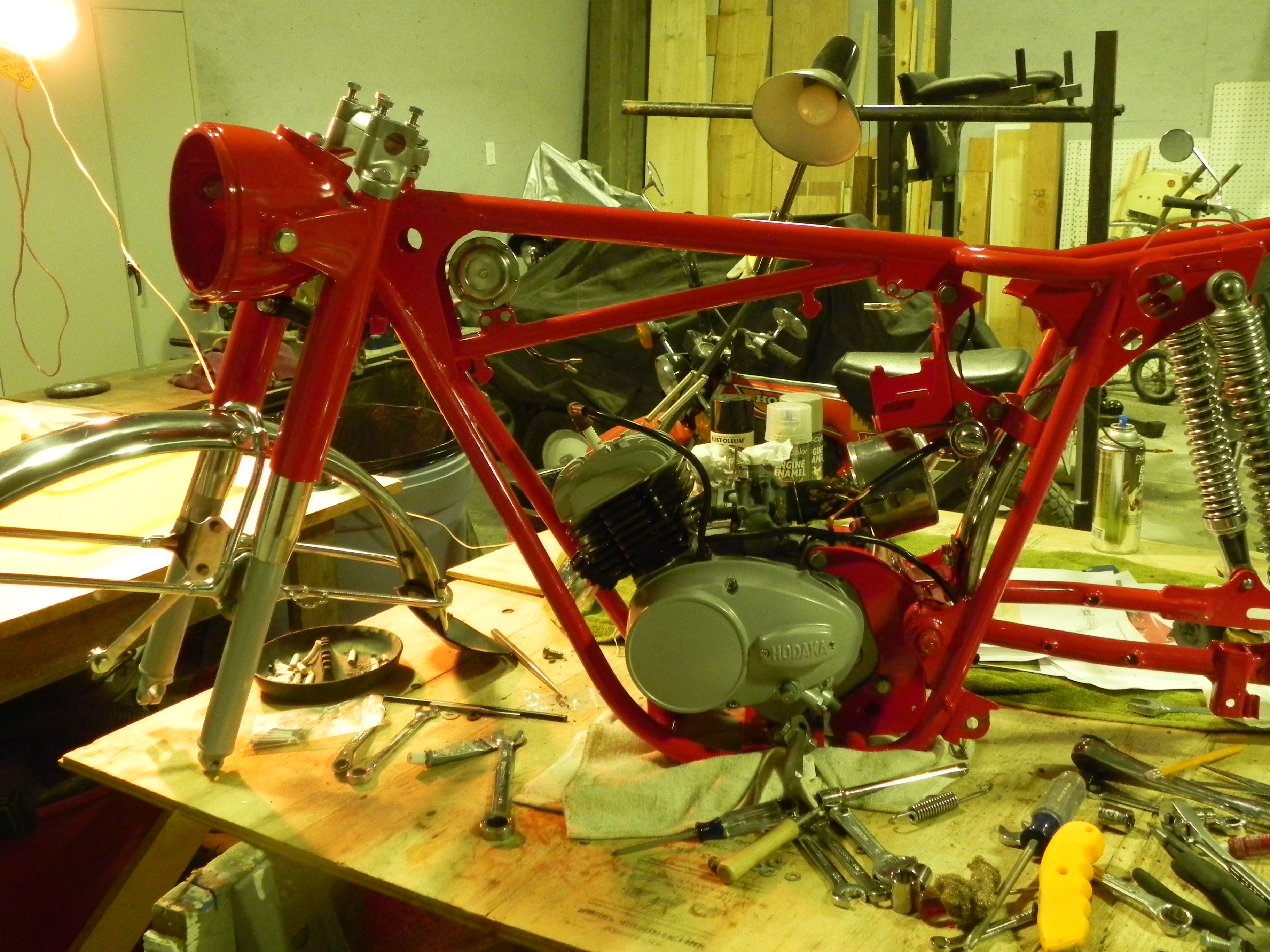

Here are some of my pictures of my Ace 64 when I was rebuiding it.hope any pictures will help. I could not find the small fender with the little mud flap so I used the longer fender with the brace.
MTRob

Nice Ace. I see now how the tail should look. I like all the chrome but ouch! That must have hurt a little.
Pop

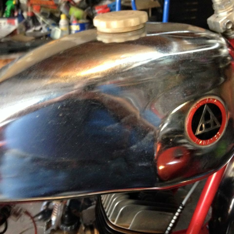

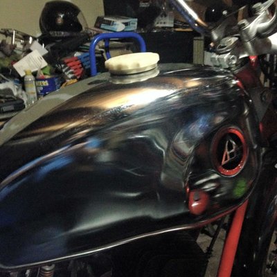

Re: Points problem
Semichrome metal polish, my friend. It is magic on chrome you'd think was ready for the recycle bin. That bike started as a heap of rusted junk that spent the last the last 40 years outdoors entangled in a bunch of wrecked/rusted farm machinery behind a barn in North Dakota. Semichrome polish, 4-ought steel wool, and elbow grease is the ticket. You should try some. Its imported by Competition Chemicals in Iowa Falls. Available on Amazon, etc. (And thanks, Clarence - I've learned from the best
Re: Points problem
Phil there was a racing coil made for the ace 90. 913008R it was held by a bracket that clamped to the frame, located under the tank by the horn. It was a ace 90 racing part that was also used on all of the 93, 93A and 93B super rats. -----Clarence
Re: Points problem
Pop. I use a Mothers Power Cone and apply first the metal polish and then follow up with the chrome polish. It took the tank I had from looking old to looking pretty nice! ; D Victor
Re: Points problem
Wow Victor! I gotsta get me one of those polisher cones. That looks pretty fine and I bet took a lot less time that the elbow grease method.

Re: Points problem
Matt & Phil. It took about 2 hours of polishing and buffing with that cone to get the results, but it was worth it! It took minimal effort and not as much pressure as I thought it would take with the cone in my cordless drill. I used the metal polish first and did the whole tank, except for the tunnel, of course. Then when done with the metal polish I cleaned the cone, let it dry and did the same thing again for another hour with the chrome polish. Then I wiped it down with a microfiber cloth to clean the tank after the chrome polishing. I was truly amazed myself. Someone here in the forum suggested this method to me & I was sure glad the did! ; D Victor
Re: Points problem
Top notch, Victor! Way worth every minute!
