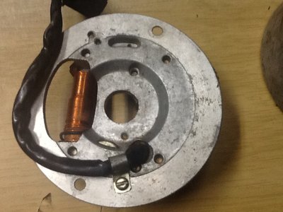

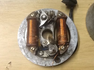

Re: Points problem
Phil, having a basket case, it may have a later Ace 100 ignition where the coils under the flywheel look alike and the Hi-tension coil is under the tank. Here's the Ace 100 ignition to compare it to.
Re: Points problem
That's what I was thinking Maxie. The absence of the coil and wire in the magneto case suggests that the ignition system was replaced at some time.

Re: Points problem
Max,
You may have the answer. That is the setup I have. So, the right coil on the ignition would not have a place to connect the high tension wire. What I need, then, is a whole different ignition?
If that is the case, I will offer my setup, with the remote coil, for a correct ignition coil setup.

Re: Points problem
Nope, all you need is that coil that bolts under the tank. None of that stuff will be visible and the coil stays much cooler under the tank and it's much closer to the plug. They updated it for a reason I'm sure, but the flywheel is the same. Hope this helps!

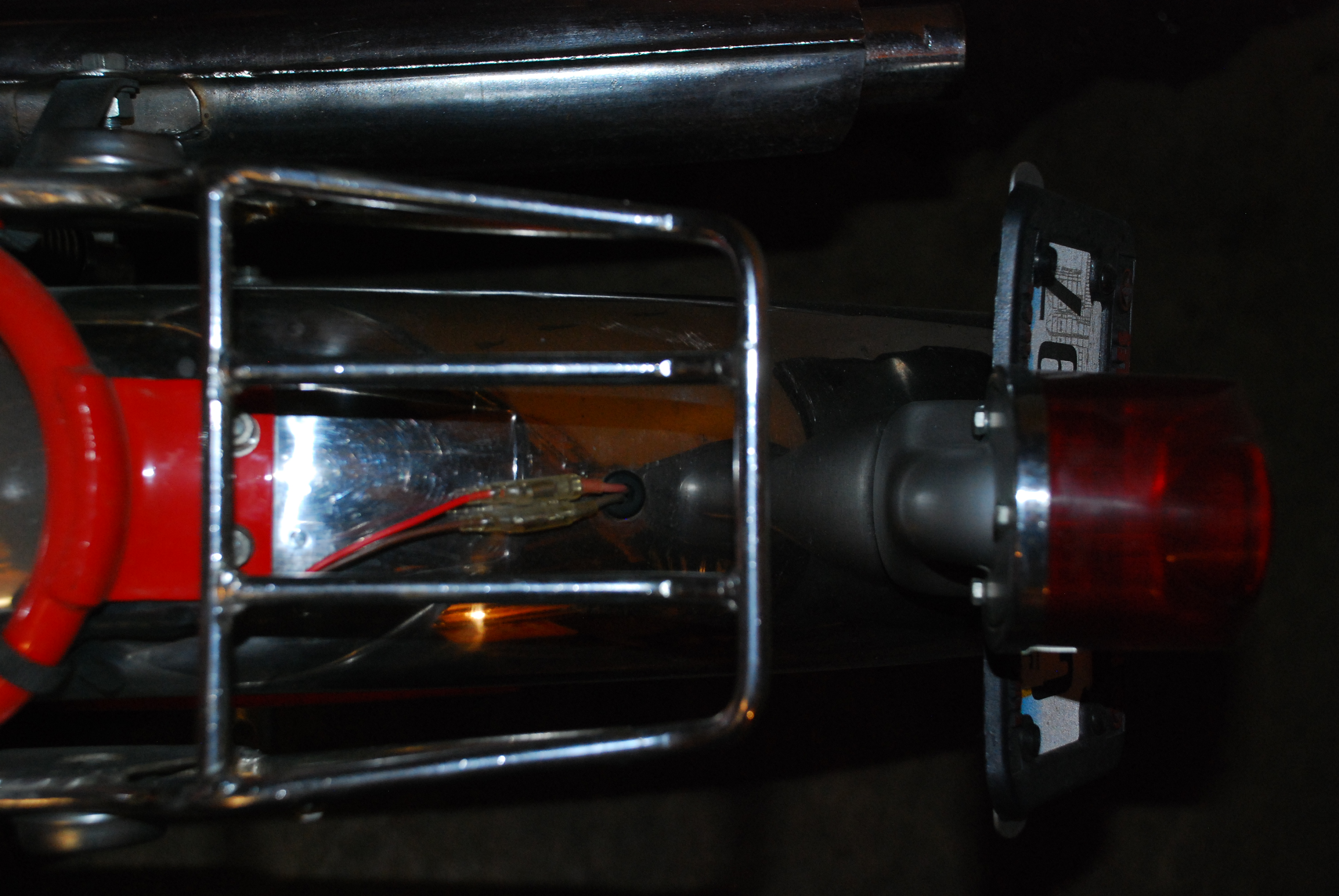

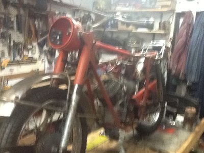

Ok. I spent a couple of hours in the shop and just got more "good" news. First, I have added some pics of my ignition parts, just so you can see what I am talking about. Now, in putting a bike back to original, is it going to be a problem using the upgrade and still calling it original. I am a member of AMCA and they have some screwed rules on bikes. I take it that most of you are AHRMA.
I also included a couple shots of the bike.
So, after the photo shoot, I decide to start putting on things that don't affect where I am working. The speedo went fine. Then. I grabbed the luggage rack. I noticed that the tail light might be a problem. I removed the tail light, fitted the rack then realized that the light fixture was too tall. I am now thinking that I have the wrong light assembly. I plan on reading up on the specs to see if the height is specified. Put the tools away. I
Decided to have a cigar and a couple of shots.
Pop c

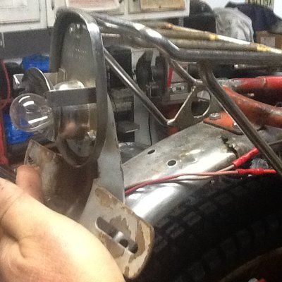

Re: Points problem
Part of the problem is your sequence. Next time start with the shots, and then hit the cigar WHILE you are working on the bike
. Could you post a pic of the light, fender, and tie-down rack? From the picture, the rack looks correct. Were the light and rack mounted to the bike when purchased or were they included in a mystery box of parts included with the bike?

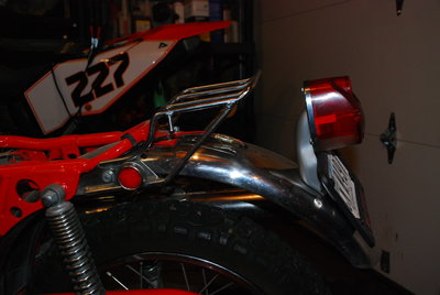

Re: Points problem

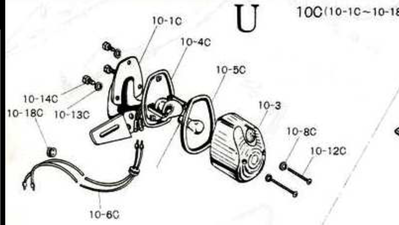

Good. The picture helps. Me thinks what you have there is a tail light assembly from an Ace 100. I will post a couple pictures of my Ace 100 for reference. You can go to the Strictly Hodaka main page and check under the "shop by schematics" drop down menu for comparison. The good news is that if you are aiming for a functional tribute Ace 90 more than a balls-on Ace 90 rider resto you could drill the fender to accept the Ace 100 tail light assembly.

Here are a couple pictures. Sorry they are so dark. Hopefully they will be helpful.
Re: Points problem
The tail light picture in your previous post looks right even tho it's dark. Is it not the same tail light as you show without the red lens in the previous post? Here's what the 90 tail light is supposed to be from the parts fiche. ; D Victor
Re: Points problem

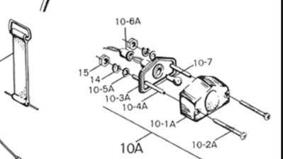

Phil what are the serial numbers on your ace 90? The early one had a small taillight and a stubby little splash guard. they also had a narrow fender. the later one had a fender extension and stabilizer bracket. The stabilizer bracket was then upgraded to a stronger one. Your fender is for the early ace 90 with the little mud flap. -----------Clarence
Re: Points problem
Victor your posted picture is not for the early ace 90.----Clarence
Re: Points problem
Ah. I was looking on a different page. Was not the oldest of the 90's. I think you mean this one! I usually pull fiche pics from Dan's site because the images enlarge better. Had to pull this one from Paul's so it's not as sharp, but you get the idea. ; D Victor
Re: Points problem
That's what I was thinking fellas. The picture of his bike shows the early Ace 90 fender with the additional holes for the early style tail light assembly.
Re: Points problem
On target good eye Matt. Now show the small rubber mud flap Victor. -------------Clarence
