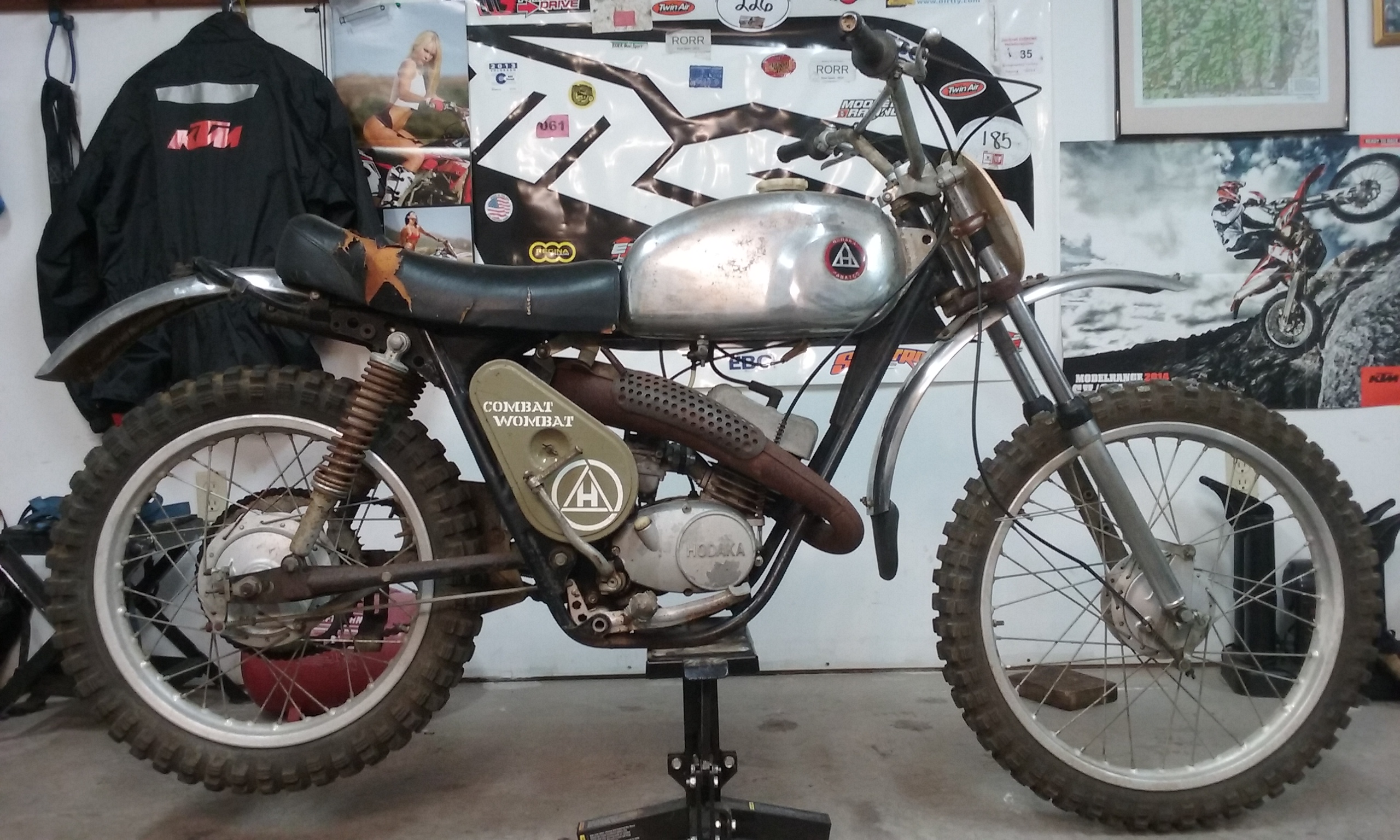

After a 13 month search ..I picked up a Combat Wombat last night. Time to start restoring. I'm sure I'll have a ton of questions and be looking for everyone's advice.

Nice. You're off to a great start.
Re: Found my Combat Wombat
Wow, brings back memories of breaking a new Model 95 out of the crate and riding it on every trail. Looks to be a great project! Keep us posted.
Nice catch! You got a bike with the "normal" alloy rims (not the "H" section "mud catcher" rims) and the later silencer/spark arrestor (not the "flame thrower" style) . . . just right!! I always liked the look of the later production units with those features. Love it. Y'all are going to have some fun!

Nice posters, too; did they come with the Combat?

Cool looking Combat Wombat and nice man cave!
What Bob really meant to say is.... Great MX riding style in the poster behind the bike. When motocrossing it is always good to get your shoulders over top of the bars.

I believe the young lady is trying to get squared up over the bars, but is having access issues...

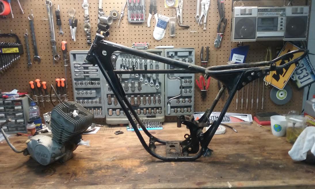

Ok guys here is where I'm at.
Stripped to the frame, all bolts being de-rusted and cleaned. Anyone do any home electro plating that they can comment on for fastener rehab? Rear wheel dissembled . Evaporust in the tank (no leaks so far). Everything came apart pretty easily so far but i have not dissembled the forks yet. Frame, swing arm and other black painted parts will get stripped an repainted next week some time. I'm planning on going about this is some sort of organized fashion so I don't lose focus and would like the opinions of those that have gone through it as to the approach I'm taking.. First things first. Get the frame swing arm, air box, chain guard and lower triple clamp stripped and painted black. Next Goal is a rolling chassis. Polish, paint and rebuild the rear wheel with new spokes, bearings, sprocket, tire etc. Get new red wings for the rear. Clean polish and rebuild forks.triple clamp and front wheel next. Then fenders, tank ,seat ,and controls. Finally the engine/transmission, exhaust and carb.
As far as the hubs go any suggestions on the brand/specific color silver I should use? Strictly Hodaka Pweter? Any tips on the hubs? Anyone ever had the hubs ball burnished instead of painted?

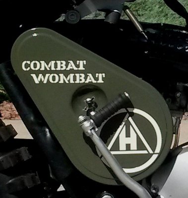

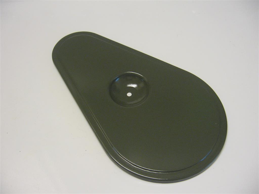

I finally gave up on finding an original color for the CW air box and used a primer with clear coats to bring out a gloss. The primer was Dupli-Color Automotive Primer Self Etching #DAP1690 and the clear was Dupli-color Acrylic Enamel Crystal Clear #DA1692. I used 2 coats of primer and 4 coats of clear. The last coat was sprayed over the decals which I got from Strictly Hodaka.
It ended up pretty close: After decals;

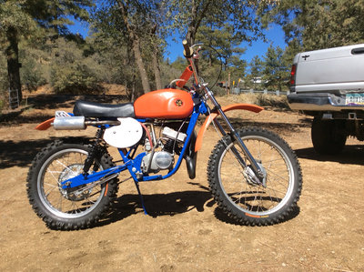

Nice shot of your bike Arizona Shorty. Can you tell me what your swing arms mods consist of and is this the SC motor you are using a 28 mm carb on? I want to use the same carb combination to smooth out the model 97s powerband on my sons race bike. Can you review your carb specs again.

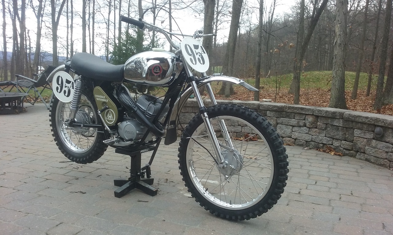

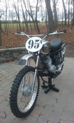

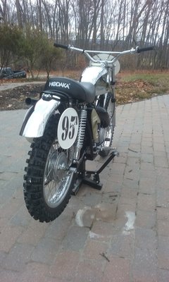

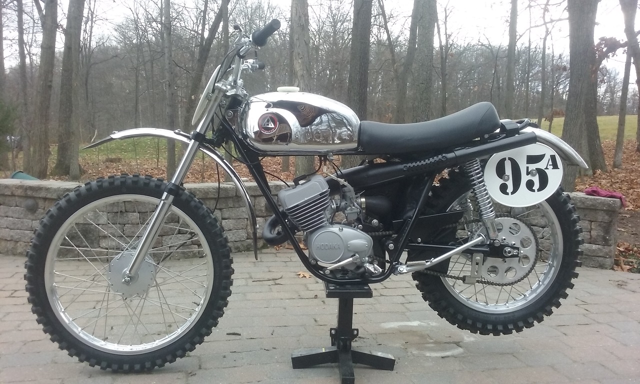

After 391 days, unknown hours, and a blown budget, I am considering the project done.
Wow! That did come out nice! Thanks for keeping us posted.
It takes all the fun out of a project when you have a budget! LOL No cutting corners on this combat wombat, it looks great! Richard
