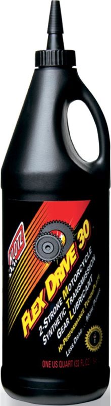

Quick, go to your local Moto shop or cycle supply and get some of this. KISS, Keep It Super Simple. You won't go wrong.
I hope I made it time, buckle up.
Re: Gear Box oil for 73 Combat Wombat
What Kelly said.
Ed (former PABATCO/Hodaka employee)

Danny Cooke recommended this oil to me for the Hodaka crankcases. It's all I use now! ; D Victor
