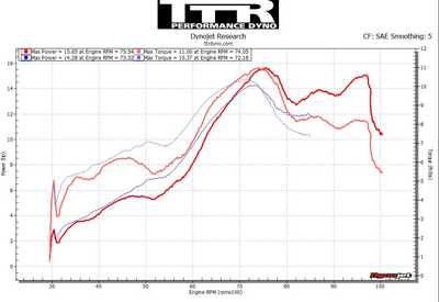

I ran the new CPI pipe on the dyno and this is what we got. The CPI made 15.65 HP at 7554 and the circle f made 14.28 hp at 7332. The CPI made 11.00 tq at 7405 and the circle f was 10.37 tq at 7218. The pipe would be a great pipe for a combat wombat that was a play bike / race bike. The low end tq is down just a bit from the circle f but when it comes on WOW it is fast. But for what I'm doing I need more low end TQ so we're going to make some changes to the pipe.....or I may keep this pipe and have a new one made that is more for TQ down low. Sorry I can't get the dyno run to down load. Oh and it also revved out to 10,500 rpm with out just dropping off on the HP and TQ and the circle f would fall off at about 8300 rpm. DG

Here's the dyno run for the circle f and the CPI pipe. As I said earlier the CPI is a bit soft on the TQ down low compared to the circle F. For a first try at making a pipe for a hodaka I think CPI did a great job! I have showed Mike the dyno run and he ask me to bring the pipe back for some changes. If he can get the TQ down in the lower RPM and have it still rev out, I think we would have a winner here. I need to take a combat wombat up to him to have a pipe made also.

So Dale. Do each one of those peaks represent the top end of each gear before it peaks and drops power, or am I reading this wrong? That's what it looks like to me. ; D Victor

The dyno run is done in forth gear, it starts at 3000 RPM and this run was shut down at 10,000 RPM. We did some to 10,500 RPM ....but man I didn't wont to blow it up so we shut it down at 10,000 RPM. DG

Well then! That looks pretty darned good for a 4th gear only run! I bet she had stuff left over even for 5th gear!!! ; D Victor
