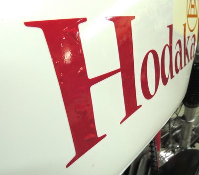

Hi Gang, Here's a minor new problem concerning the new Clarke fuel tank. After fueling, the tanks surface seems to be outgassing causing bubbles under the vinyl graphics. I iron them down daily to no avail. I'm considering two options, one being painting of the tank to seal it or the other one the sealing the tank from the inside. Has anyone painted their plastic Clarke tank and was it successful? I hate to give up on the cool graphics as it was part of the design. Any thoughts? I'm off to the Graphics guy for his ideas.

While I don't know the solution to the problem, it is my understanding that ALL plastic tanks allow some vapor migration through the tank walls.

Use graphics that have the little holes in them, can't recall what they call them but they use them on Yamaha plastic gas tanks and Can Ams.

Hey thanks Terry, I'll run that by the Graphics guy and see what materials may be available.
