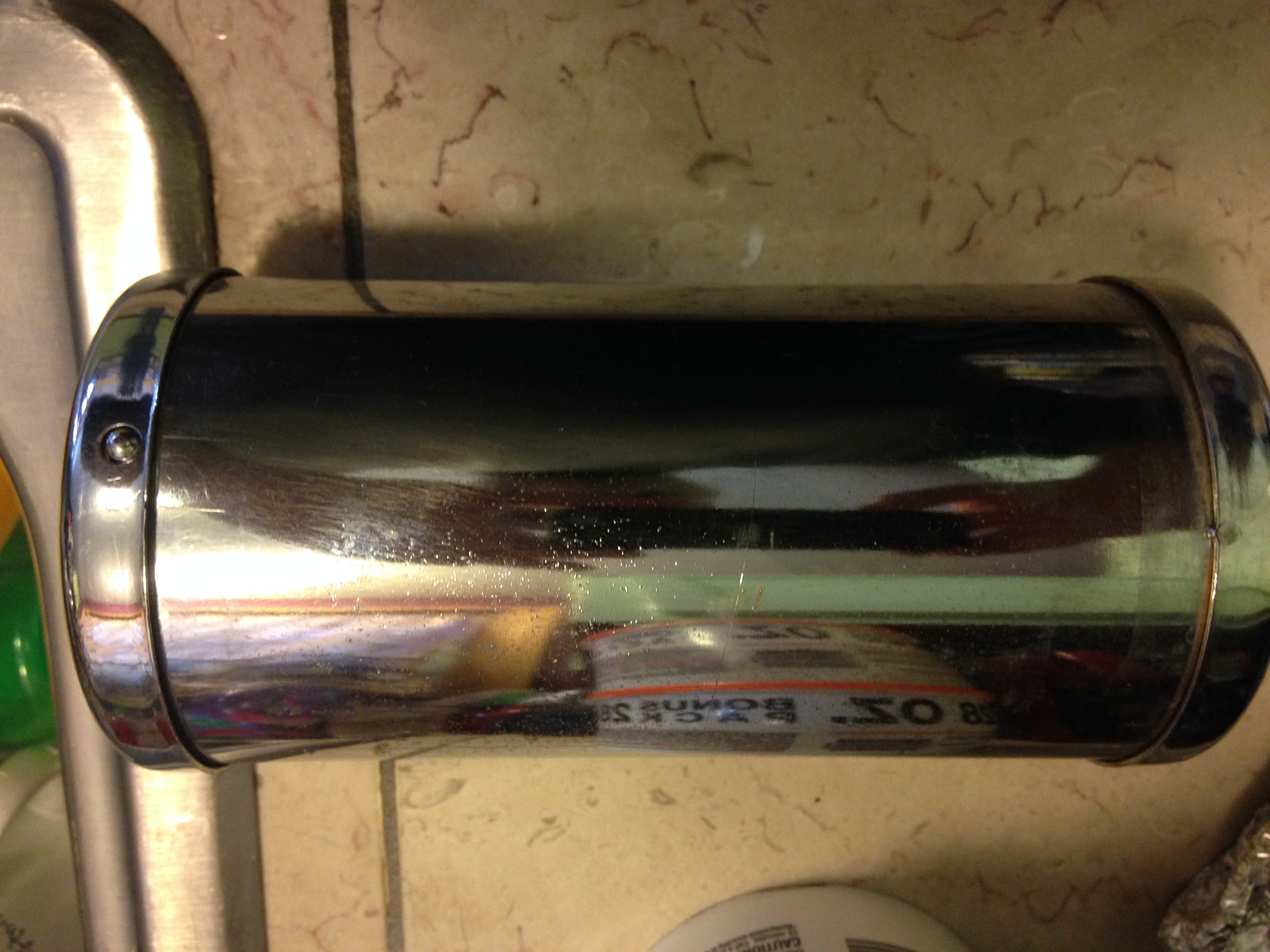

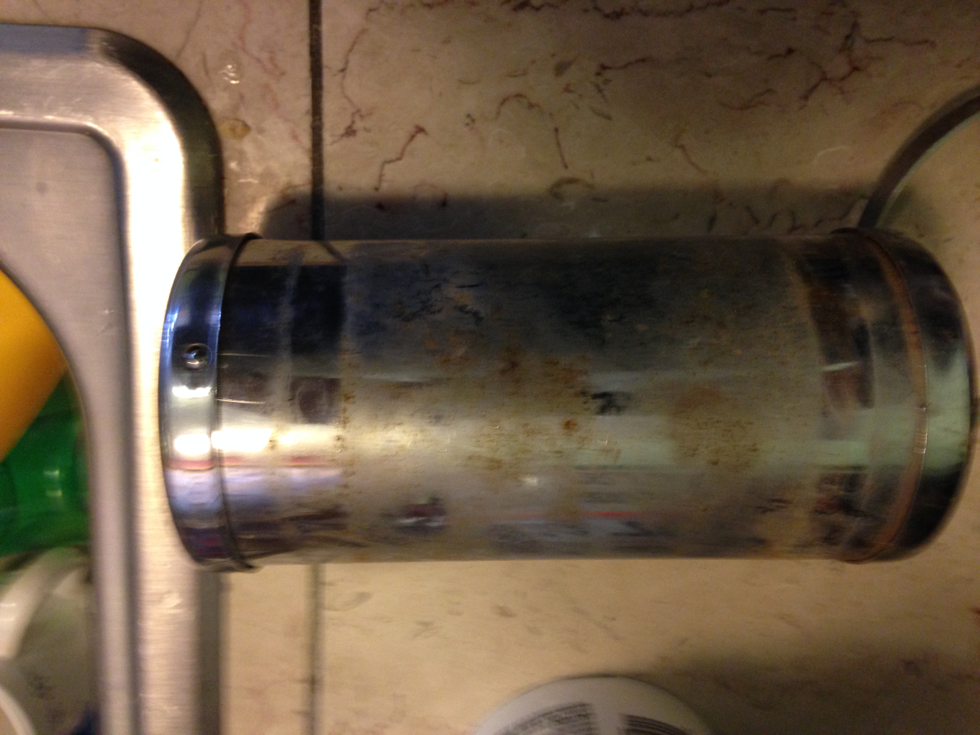

Zeek. Have you ever used aluminum foil for rust removal on chrome parts? Wrinkling and then folding a sheet of aluminum foil and wetting it and then using it to clean the rust will show you whether there is light pitting or pitting all the way through. It also helps lower the cost of rechroming because YOU do the rust removal.
It works well. Some folks also say wet the foil with Coca Cola also. It's a great trick for rust removal, especially on chrome. ; D Victor
