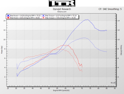

Here is the dyno run we made today with the circle F pipe and the Boyesen duel reed and 03 manifold. It cost's $75 to make three pulls on the dyno and I had used all three so I never got a chance to put other reed's and a open manifold on to see what it would do. The second sheet is of a bone stock 72 wombat and the run I made today. The first one has today's in blue last years in red and Tim's pipe is in yellow.....that one is fun to ride.

I hope the development project continues in the attempt to extend the power curve of the set-up which had major muscle at lower rpm's - that is wayeeeee more interesting than the "normal" (and very strong) power curve you have right now. (at least to me)

We're working on the circle F pipe to lower the Max Torque RPM. One thing about the pipe Tim made that is interesting is there is a big difference between 10 and 11 foot pound of torque on the butt dyno.

The Blue lines look like more fun to me

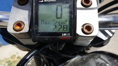

Ed this is interesting. I have pluged this in to the spreadsheet we did a while ago and we are in the ballpark. DG what was the RPM at this speed and we would also like to know the radius of the tyre ,ie the distance from the center of the axle to the ground.DGardner wrote:Like street outlaws........I did a test hit on the wombat today.
16/47 at 7000rpm with radius of 36cm gives 71.54mph

Kevinthirdstone wrote:Ed this is interesting. I have pluged this in to the spreadsheet we did a while ago and we are in the ballpark. DG what was the RPM at this speed and we would also like to know the radius of the tyre ,ie the distance from the center of the axle to the ground.DGardner wrote:Like street outlaws........I did a test hit on the wombat today.
The Highest RPM was around 8500 RPM. I will get the rear tire size and post later. DG

The spreadsheet at 8500rpm MAKES 77.21mph at 16 47 gearing and wheel radius of 32cm

I checked and I came up with 33cm from center of axle. I set the bike on a stand then used a level to get the top of the tire to the center of the axle. DGthirdstone wrote:The spreadsheet at 8500rpm MAKES 77.21mph at 16 47 gearing and wheel radius of 32cm

The pipe that we used for the blue line dyno run was a fun one to ride. We have changed some stuff from the last dyno run and it is running better now with than ever. My friend (Tim) that made the pipe and did the dyno run's is having some health problems....so all dyno and pipe making is on hold till we can get him feeling better. DGthirdstone wrote:The Blue lines look like more fun to me
