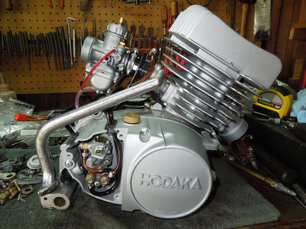

Well may be not quite ready to take a spin yet. Completed the engine and installed it in the frame today. The plan is to address all the mechanicals and sell the bike to fund another project. This is an unmolested 03 with title. Will make a perfect candidate for a full restoration. Will post more as project continues and, with Paul's consent, list it in the for sale section when ready.

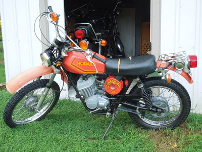

Ok so here are pictures of the bike. Everything works as it should and a bit more tuning to do. Going to go to a different reed and see how the bike responds.
