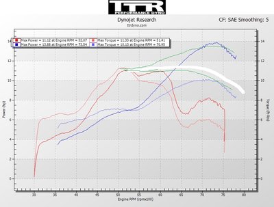

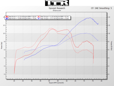

I was able to get the wombat on the dyno yesterday. Okay first off this thing was designed for torque not H.P. and second we changed the porting after the pipe was made, so now we need to change the pipe again to match the porting. The new motor is in red and last years motor is in blue. For seat of the pants riding WOW! this thing has a lot torque and for what I use it for it is so easy to ride, it will just stay at 55MPH at 6000RPM. It has so much torque that I think I could gear it up two (47 to 45) teeth on the rear.

Soooo many questions. Can you give us a quick narrative about this comparison? Which Wombat? (Iron barrel, piston port? Alloy cylinder, reed valve?)
Was last years engine "stock"? Carb, porting, pipe?
This year's power curve sort of falls off a cliff after 6,000 - but is pretty muscular up till then. Seems like it would be a fun powerplant to ride. Pipe re-work may change the "cliff" part of the power curve substantially?(!)

What I see is that it used to give you linear power throughout the band, and now it is lumpy from low to midrange with a couple of significant flat spots, and to say it falls off a cliff understates the problem. Clearly nothing you have done so far has helped unless you are building a trials bike. I would start with the new pipe. Toss it. And frankly it isn't the stinger. If the rest of the pipe isn't tuned for your system, the stinger won't fix that. That is neither old nor new school thought, just math. Put the circle F back on and see if your new porting is aided in any way. Hopefully you can still get usable torque and also get some revs out of it. Limited to 6,000 rpm I can't see how you get up to 55. I would have to do the math on your total gearing, including tire sizes.

Let's keep in mind it IS a development project and a new pipe is already part of the near future plans - so lets see how it all develops.
It would be interesting to see how close these two engine specs might be on a twisty track with an old coot at the throttle (translation - a guy who uses the clutch for starts and shifts . . . but who does not fan/slip the clutch on the track).
With a Combat Wombat transmission, shifting from 3rd to 4th at 6,000 RPM would drop the engine speed to 4,400rpm. Which is a slightly more muscular spot on the power curve than the 5,353rpm the "old" engine would have seen when shifted from 3rd to 4th at 7,300rpm.
To be sure, for outright "go fast" riding, considerably more revs are needed before power starts to fall off. But right now, the "new" engine looks like it would be a hoot out in the woods.

Like Ed said "it IS a development project" I had a dyno time scheduled for 11.30AM and I got the bike put togeather at 9.30AM, then rode it 35 miles to Tim's to put it on the dyno. So this is about as new and untested as a bike can be. We know the dyno sheet is not the best looking and the the bike could use some over rev, but it is still a very fun bike to ride! See you all at hodaka day. DG

I am hoping with some pipe modifications that we can get the curve to look more like this one (Green)
But for the 1st attempt "build it" from scratch.. Tim at TTR did an excellent job..

Encouragement might sound something like, "Hey - the "new" engine is producing 63% more power at 5,200rpm than the "old" engine did at that engine speed. Cool! Let us know how the engine performance changes as the development process continues."
Re: Wombat Dyno
Except it isn't. The 11 that it makes at 5200 is 57% "more than" the 7 it made before, not 67%. If that were the intention, fine. As I said, if trials is the target, it's getting there. One might also say it now makes only 35% of the power it used to at 7300. Cherry pick all you want. What is shown is, hopefully, not the final product. Even Doug and Kels have agreed that it isn't done yet or where they want it to be. I was trying to identify why it is what it is.

Interesting. We don't even read a graph the same way. (6.8 VS 11.1)

For your information ,the GOAL of this engine is to WIDEN the effective power band.. Yes, create MUCH more LOW END POWER and give little to no top end power change ..
We all know how much low end power these engines have in stock form.. right??
The low end power of this engine is where Doug wants it..
Getting the over-rev will be fairly easy with some simple pipe modifications. This will happen when Doug returns..
Looking at the peak power vs the area UNDER the curve is a common mistake made by people who do not understand what it takes to make an 85 octane STREET-BIKE Engine.... Not a race BIKE Engine.
Like previously mentioned.. The order of operations for this build has been carefully planned out and is progressing very nicely.. The pipe is "1-off" and is 10" (inches) LONGER than the previous pipe.. put that in your calculator.
Once completed the dyno graph will , hopefully, resemble the one I mocked up and will be an engine that is made for street running but would also dominate on a moto cross track... The piston will last longer, the engine will rid itself of heat more efficiently, and it is able to "lug" (something Wombats are not known for) and still run 70MPH on the highway.
