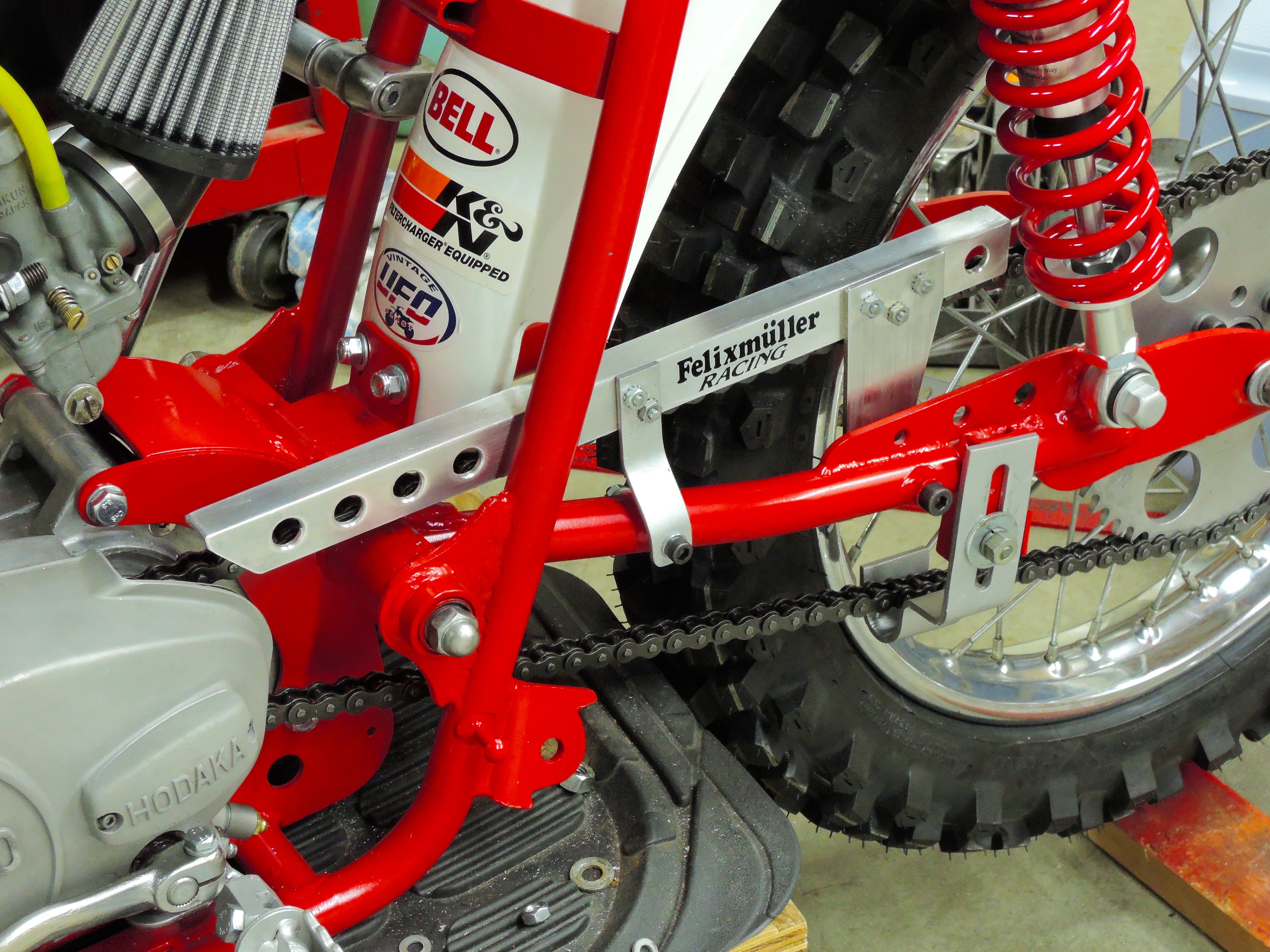

Thanks Ed, lots of fiddling with the fit on this one. The vertical plane of the rear bracket is close and to adjust it outward you need to grind off material from the inside of the rear bolt boss on the inside of the swingarm (if you can follow all of this.) Everything is tight tolerances. Maybe I should have went with a narrower tire in hindsight, but here I am. :? OK , I think this is the final on this one. One more hole in the rear non-structural part of the guard and a decal to balance out the design. Felixmuller Racing is a funny story in itself which I'll relate to everybody when I have more time.
Later
I think I'm finished.

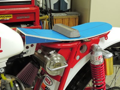

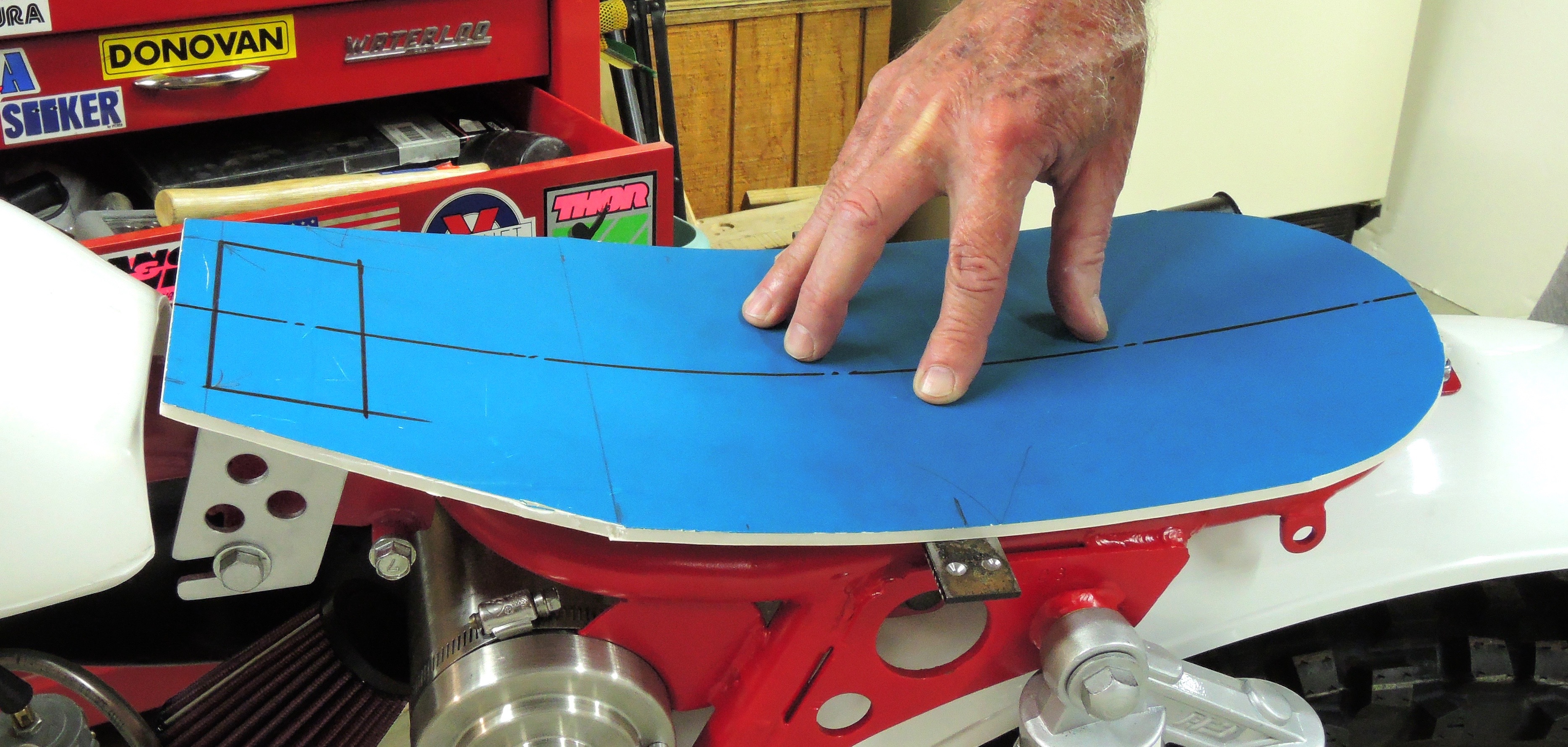

Well, I'm on page two again. Time for a little report on the project. My seat guy brought over a mock-up with the stock seat pan but we both agreed it was just too fat looking with the narrow gas tank. Back to the drawing board or at least some visual prototyping. I removed the front bracket from the stock seat pan and modified it to use with the proposed aluminum pan. I'll need to build a bracket for the back that can use the existing seat mounts on the frame. Looks like it will all work. The stock pan was about 10 inches wide and the new one will be just under 7 inches. It should be better for trials use.
That's it for now. :)
Modified front bracket.
Pattern for aluminum pan.

As long as you are making a seat from scratch, why not extend the front of the seat to overlap the tank a bit in a tapered apron. That might make them blend together.
GMc
Re: Day One - New Project
. . . and would provide an easy (and um, comfortable) way to move your weight forward a bit more for aggressive cornering.

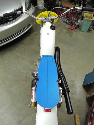

Hey Greg and Ed, thanks for the input and that's the plan. I'm waiting on the seat guy to look at it and decide how much more pan he needs. It's hard for me to visualize how he's going to fasten the cover in that area. Quoting you guys, I do want it to "blend-in" so I can do "aggressive cornering". ;)
This width looks much better from the top.

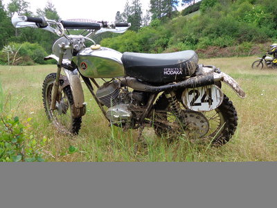

I'm liking the shape of the SH racing seat on Dale Dvorak's Wombat stitching and all on a smaller scale.
Cool bike, cool seat!

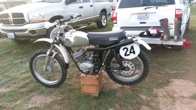

Ok, I found a better shot of the seat and Dale's cool bike. This is kinda what I'm shooting for in design. (and my seat guy is monitoring the Forum for guidance.)
Getting there-- :)
I'm likin it.
I'm likin it.

It is funny that you found a better picture of my mini-chain guard than I could produce when needed... I am not sure that you would have noticed it since it is painted black. It is mounted directly above the Jay Roller chain tensioner spring, sharing the same mounting hardware.
Funny Dale, both pictures were on the Day One thread. I see the chain guard now! :)

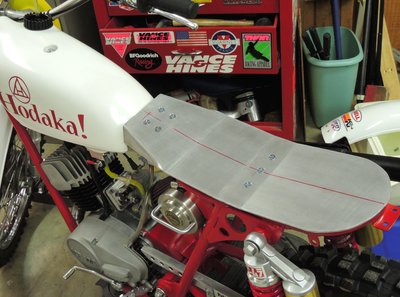

Here's a report of work in progress on the new aluminum seat. The pan was fabricated with 1/8" aluminum sheet. The front bracket was modified from the stock one and a new rear bracket was made. Three trys on bending the rear bracket but I finally prevailed. Time for the seat guy to do his work. :)
Seat pan comparision.
Brackets made and mounted.
Aluminum seat in place.

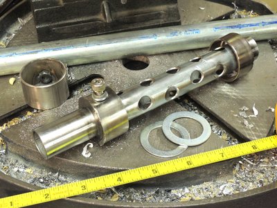

A peek inside the 94A exhaust exit end reveals some internal baffling that looks to be stifling any return waves from the rear convergent cone. The project mission is to produce more torque and all should still be OK. Since this is an experimental exhaust it will need some sort of stinger and this is a start. 1.5" thin exhaust tubing fits perfectly inside the 94A exhaust rear. The stinger was fabricated from 7/8'' conduit. Washers were used for end plates with the 1.5" tubing used as centering caps. A little time on the drill press and it's off to the same clever guy that built the twisty header pipe to weld it all together. He's gotten so enthused with the project that he hasn't even let me pay him lately. I owe him!
Getting there! :)
Experimental stinger/silencer fabricated.
New stinger/silencer mounted.

Are you intending to pack the new silencer with glass? Either way it will have a bark to it, but without, it will be about the same as a straight pipe. Workmanship looks very good. Let us know how it functions.
