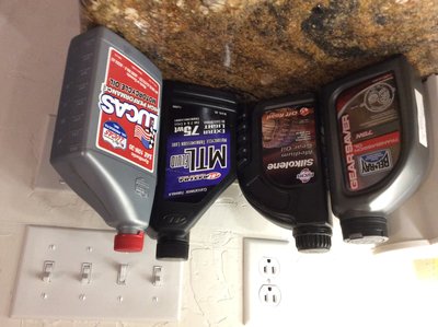

Here are a few, all good:
All are approved for use in air cooled engines with wet clutch. All are within a similar range of viscosity. The Bel-Ray is 75W, the Silkolene is rated 85W-90, the MTL is 75W (these three labeled as "transmission" or "gear" oil), and the Lucas is SAE 10W-30, labeled as "motorcycle oil." There are others.

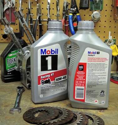

All of the lubricants mentioned so far seem to fill the bill. Here's what I use in all my recent bikes which include a Yamaha XS-650, Kawasaki KLR-650, the farm Yamaha 4-wheeler and all Hodakas. All the ratings are listed and you can read up on this product. The bottom line is wet clutch and transmission rating.
Re: Transmission oil
Nice touch putting the clutch plates in the shot Max! ; - ) Victor
Also right side up! Nikon/Apple.
I also turned the resolution up a notch. (Still plenty to go!)
