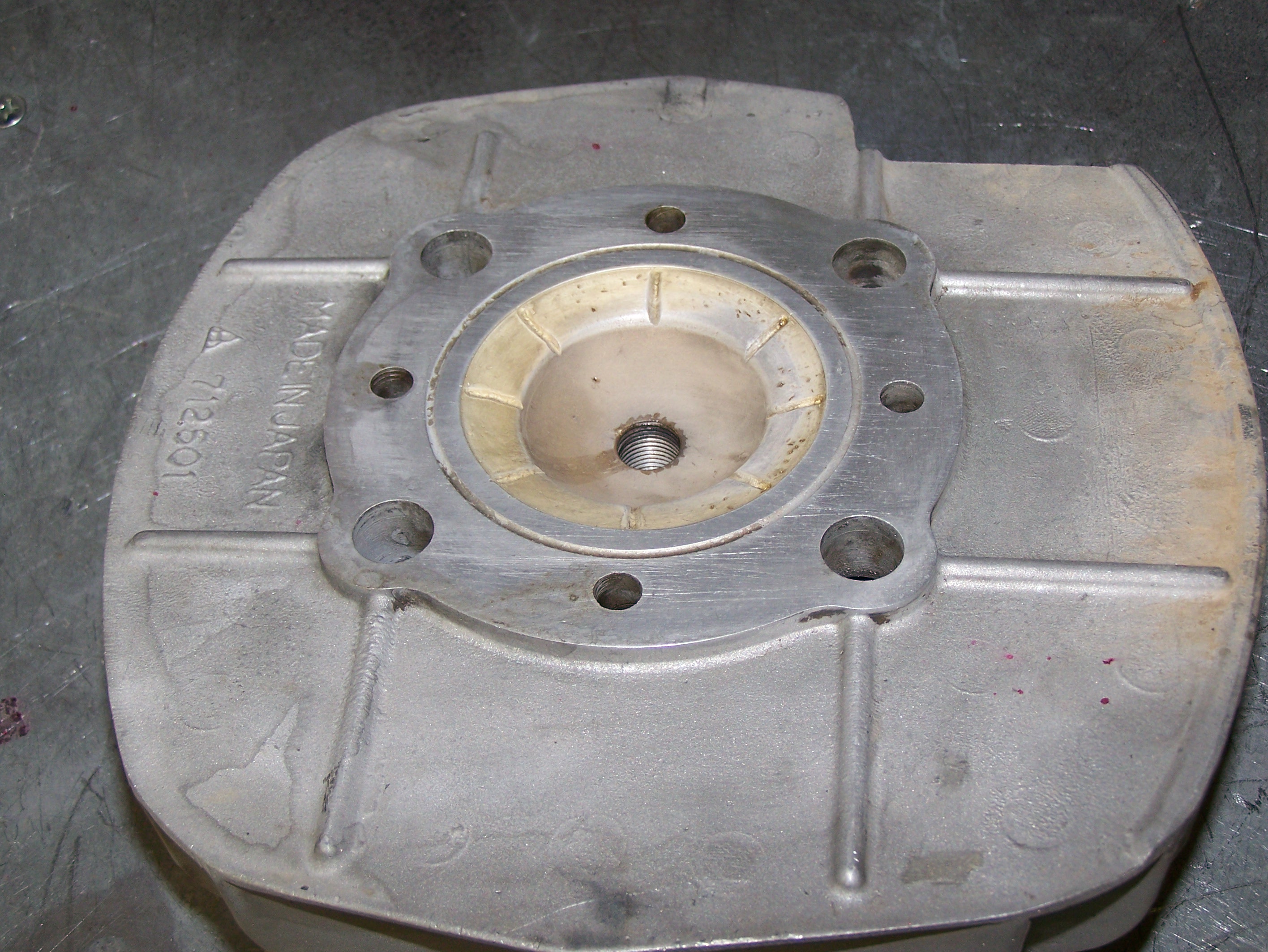

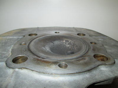

Adding torque grooves is proven to reduce the chance of detonation by improved combustion efficiency. At tdc the grooves help to send the air fuel mix that is( normally hanging out where it shouldn't be just waiting to detonate at the wrong time ) toward the center where it should be , then after the flame front begins the grooves also improve complete combustion by the turbulence they create. THis picture of the piston crown being clean all the way around the quench area where normally is only clean where the transfer port wash it is proof.

Wow, I'm really grooving (lame pun) on this torque groove concept. Apparently this brilliantly simple idea was dreamed up in India only about 20 years ago.racerclam wrote:Adding torque grooves is proven to reduce the chance of detonation by improved combustion efficiency. At tdc the grooves help to send the air fuel mix that is( normally hanging out where it shouldn't be just waiting to detonate at the wrong time ) toward the center where it should be , then after the flame front begins the grooves also improve complete combustion by the turbulence they create. THis picture of the piston crown being clean all the way around the quench area where normally is only clean where the transfer port wash it is proof.
Anyway my 250SL head has an offset combustion chamber, whereas the one Rich shows is conventionally centered. Does the torque groove concept apply anymore with an offset chamber, I wonder. Would just grooving the front third/120 degrees of the chamber/squish area assist the delivery of the fuel-air mix rearward to the offset combustion chamber?
Re: 250 SL holed its piston. What to do?
Groove it all the way around even in the narrow area, the concept works on anything, even on screwball Bultaco heads , they make your SL head look good.

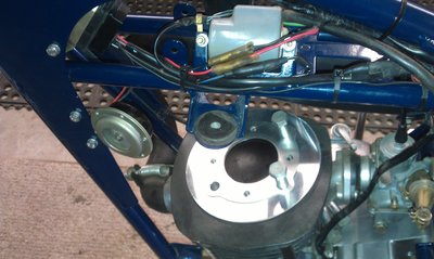

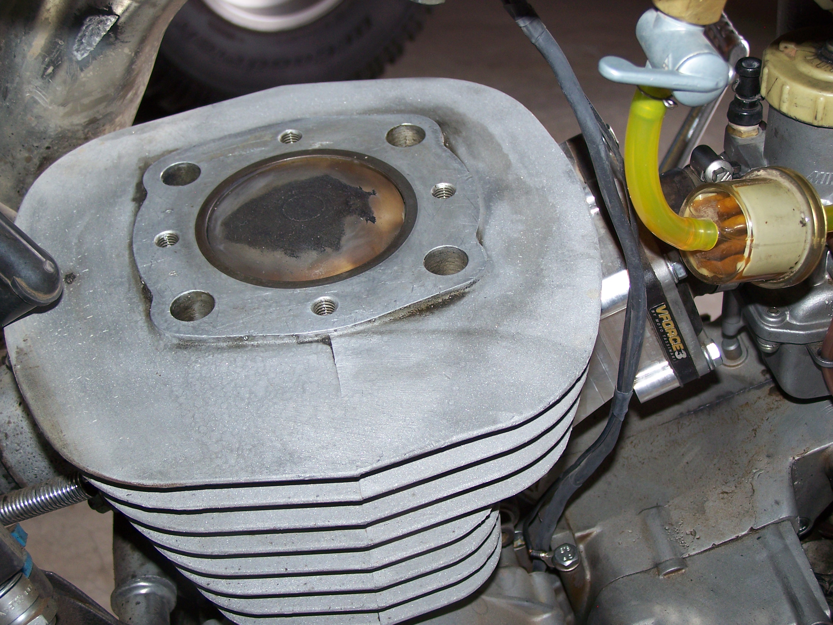

Greetings
In order to insure that my 250SL doesn't fail like Darrell's, I purchased new larger head gaskets ( Hodaka Dave ) and a new SC CDI per Rich's recommendation in an earlier post on this thread.
With the stock single gasket, I got 150 LBS compression and 130 LBS with two of the new. My plan is to ride with the two gaskets for a while and then go back to one to see if there is any difference. My thanks to Ed for the info on how to aneal the aluminum.
The SC CDI is a bit too large to fit into the stock CDI location, behind the coil , so I mounted it in front of the coil inside the frame gusset where the oil tank used to be. The wiring is long enough so that everything plugged together without any modification. If I was using the oil injection, I think that I could have mounted the CDI under the coil.
Hopefully Darrell's rebuild is going well.
