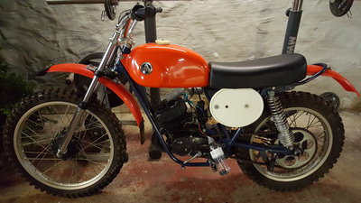

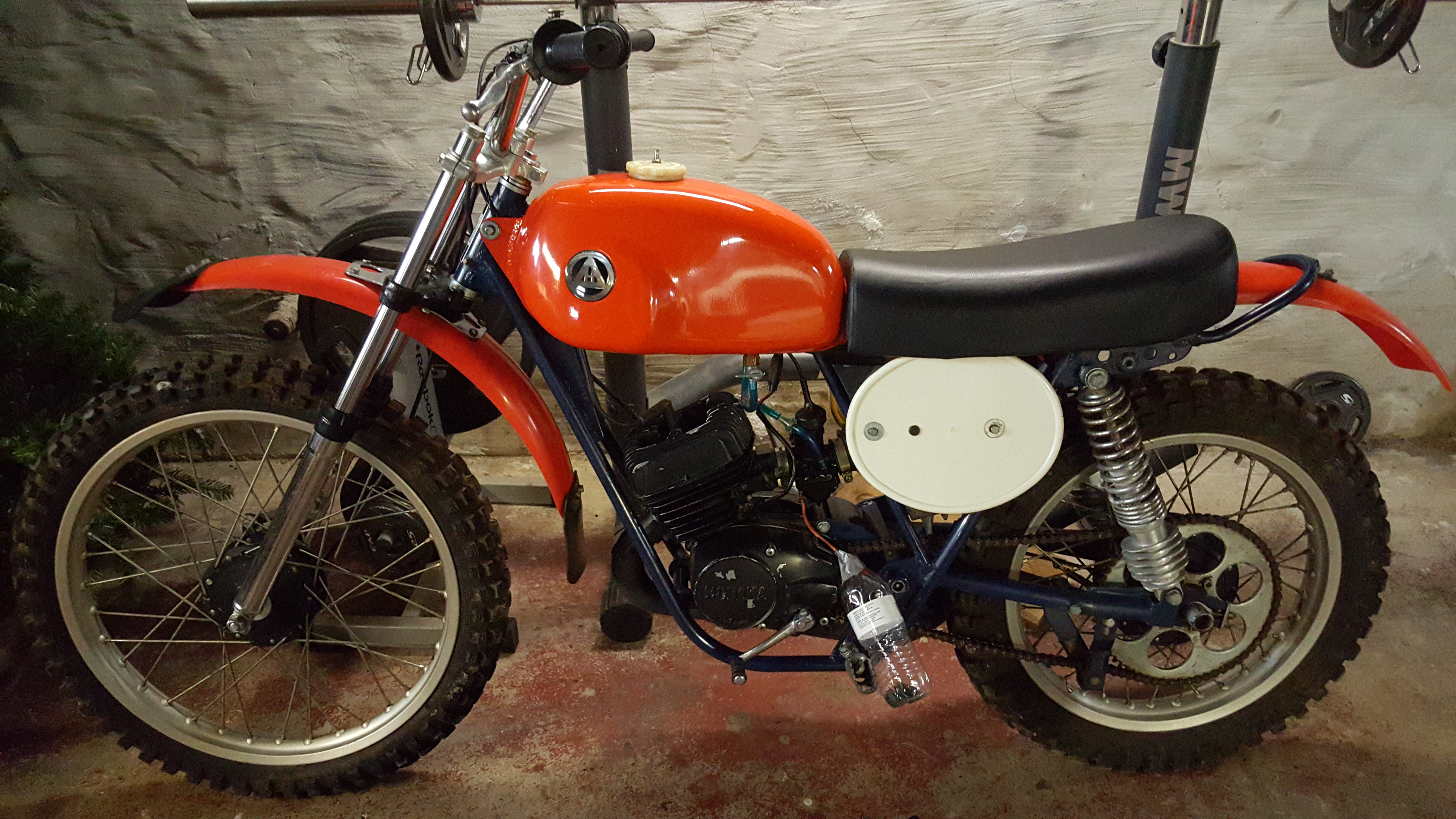

Ok, so I've posted in the past week about my Super Rat (98) that I recently bought from my uncle. The bike probably sat for at least 20-30 years without being started. Not sure what kind of issues it would of had when it was still being used. I did get the bike to start up relatively easy after cleaning the carb and adding a fuel filter. I did have to drill through one of the petcocks plastic inserts because it was siezed closed. I added gear lube too. After further inspecting and starting the bike here and there without running it for very long...10-15 seconds at the most I've noticed a few things:
1. The exhaust spit oil. Took out the flame arrestor and the packing was saturated with oil. I'm sure it had been that way. Cleaned and repacked.
2. Was getting fuel out of the air vent tube. Calibrated float and will be ordering new valve and seat.
3. Gear lube must of gotten fuel and air that could have been from fuel getting into crankcase from valve not working correctly or shutting off petcock. Lube is now sudsy with a lighter color.
Guess my question is if fuel/air got into the gear case would that indicate that I need to replace some seals? Would it only be a problem if I had gotten fuel in my crank from faulty float valve and or petcock not being closed? Once it does get by the seal is it a done deal? Dale D. had previously given me some good information on how the float system works. Just wondering if I have bigger issues then I realize. Thanks in advance.
