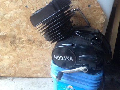

Hodaka cases were painted, were they not? If they were, it would have been with 2K automotive enamel. These catalysed paints require a compressor and spray gun. If you have such tools, choose the paint you like and shoot the cases. If you don't have paint equipment, I would leave the cases bare.
