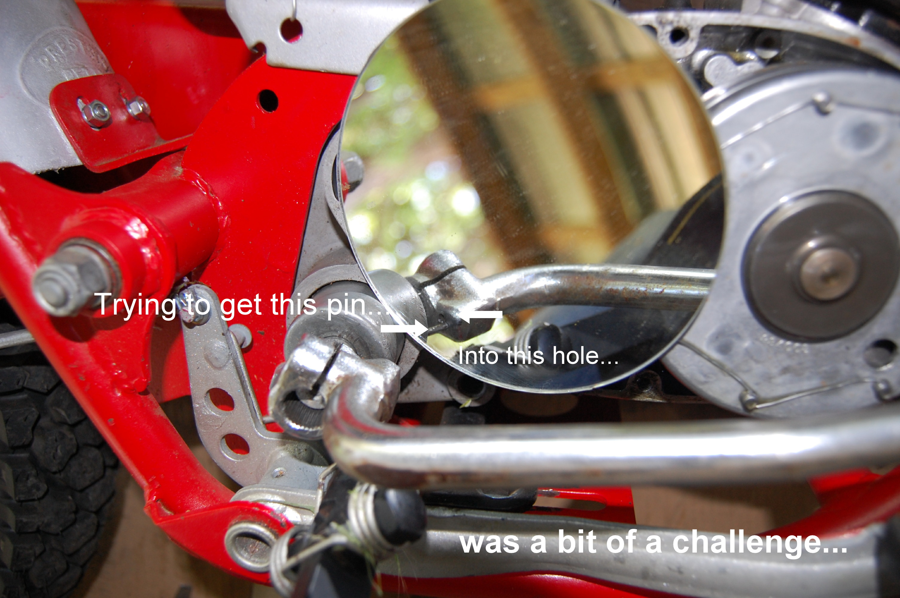

took a pic when I last did mine...click it for bigger pic...mirror helps...I always use my JIS (not exactly Phillips head) screwdriver on case screws...
