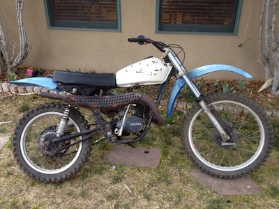

I'm considering buying a Road Toad/Combat Wombat/Wobat. Its a Toad frame, fenders and tank. A Combat engine, and has some other parts from a Wombat. Guy says it runs great, and the pictures he has of it make it look like its in pretty good shape.
To make a long story short, what should I look for when I go take a peak at this thing this weekend. What are some common issues? What are some of the things that are almost always wrong? If any?

Lots of variables to consider. One of the first things I look at, is to see if the stud on the left side of the crankcase that the rear screw of the shifter case bolts to is not broken off. It's right below the countershaft sprocket. It can be an expensive repair. Rusty fuel tanks can be a problem. I guess my advice is to inspect the usual, sprockets for wear, compression, if it starts, runs and shifts, fork seals, cables and such. Hybrids are assembled from pieces and you don't know if they used the good ones or the bad. General appearance is a factor, It shows if they cared about the project or just threw something together. Make a list of obvious things that need replaced because it can get expensive replacing vintage parts. There's my quick advice, I'm sure the Gang will mention some things I overlooked. Good luck!

Personally, since this is a put together bike, from so many different sources, I would concentrate on the engine and how well it works. If it runs nicely, looks good to you, and isn't a rust bucket, it is your choice. It may not look like any one particular machine, but if you like it, that's what counts. After that, price is wide open since it isn't a restored or original, just a motorcycle, it should not be all that expensive. I don't have a target cost in mind, but I know I would not pay more than a grand for a mutt even if I liked it.
Post pictures.

I do like the way it looks, and since this is going to be a ride around in the woods bike, looks shouldn't mean much anyway.
As for the price, he's asking $700, but I haven't discussed it with him. I'm sure there is something wrong with it that will help bring down the price. Although I like to do that sort of thing in person.
Here are some pictures.

Price looks about right to me. Hard to find one any cheaper that is running. Should have plenty of power with the Combat engine.

I see an awesome start to a project here. Great start already with the forks. Throw an 03 swing arm at it, doll it up the way you want it to look and ride on....

What bobwhitman said. Will give you a little more wheelbase and Paul can set you up with some shocks that will balance out the rear to match the forks. Go for it!

Allow me to clarify some of the previous comments about the forks. The 34mm forks in the photos are from a either a model 03 125 Wombat or from a Hodaka 250. This a good thing as they have more travel than the 30mm units that came stock on this frame. The forks being longer than stock and the rear shocks being stock,has the front end raised a bit which will result in less than optimal steering. Longer shocks would fix this problem.
Things that I would check for would include rust in the tank, cracks in the rubber intake and carb to air cleaner boot, slop in the shift shaft , rust in the magneto and condition of the seat pan.

I should say that the stud that breaks off is not a weak point but the result of a catastrophic chain derailment. It also can break the shifter case or crankcase. It is the first thing to look for when buying engines or crankcases on line. They can be repaired by clever people or replaced but all costly and time consuming. I have personally never seen a crankcase wear where the kick starter comes out. Just a little more info!Sandrion wrote:I ran across that website earlier while I was poking around for info. I don't think its the same guy, the bike I'm looking at is a little different than that one.
