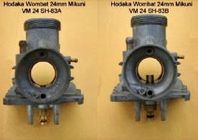

As for the model 94 Wombat carburetors, there were two different runs. The early ones had the type A carb and then at frame number C01701 the type B carb was introduced.
The type A is generally considered to be good as only a pencil holder on your desk. The type B is the preferred carb. The model 94A Wombat was also equipped with the type B carb.
To quickly tell the difference, you can look through the venturi and you want to see the shroud of the needle jet (nozzle) protruding about 8mm. That is the type B carb. The type A carbs nozzle sits almost flush with the bottom of the venturi.

Ok, Thanks for clearing that up Dale. My serial number is post C01701 and after looking at the carb it is the type B that you described. So I should be good to go with a little rehab to the existing carb.

If you go to the Library section on the Hodaka-Parts.com website, the specs for the carbs are listed.
Dale is correct about the SH-83A vs SH-83B carbs. I’ve attached a pic of the 2 side by side, from a previous Resonator Revisited article. There are more differences than the brass top of the needle jet.
The library also lists the differences in jetting and configuration. But the brass top of the needle jet is pretty much a dead give away between the 2 carbs.
Re: New to group/model 94 Carb question
I checked the throat of the carb and it has the nozzle that sticks up into the throat of the carb like the picture shown of the VM 24 SH83B so it looks like I have the good one. Thanks for the info.
