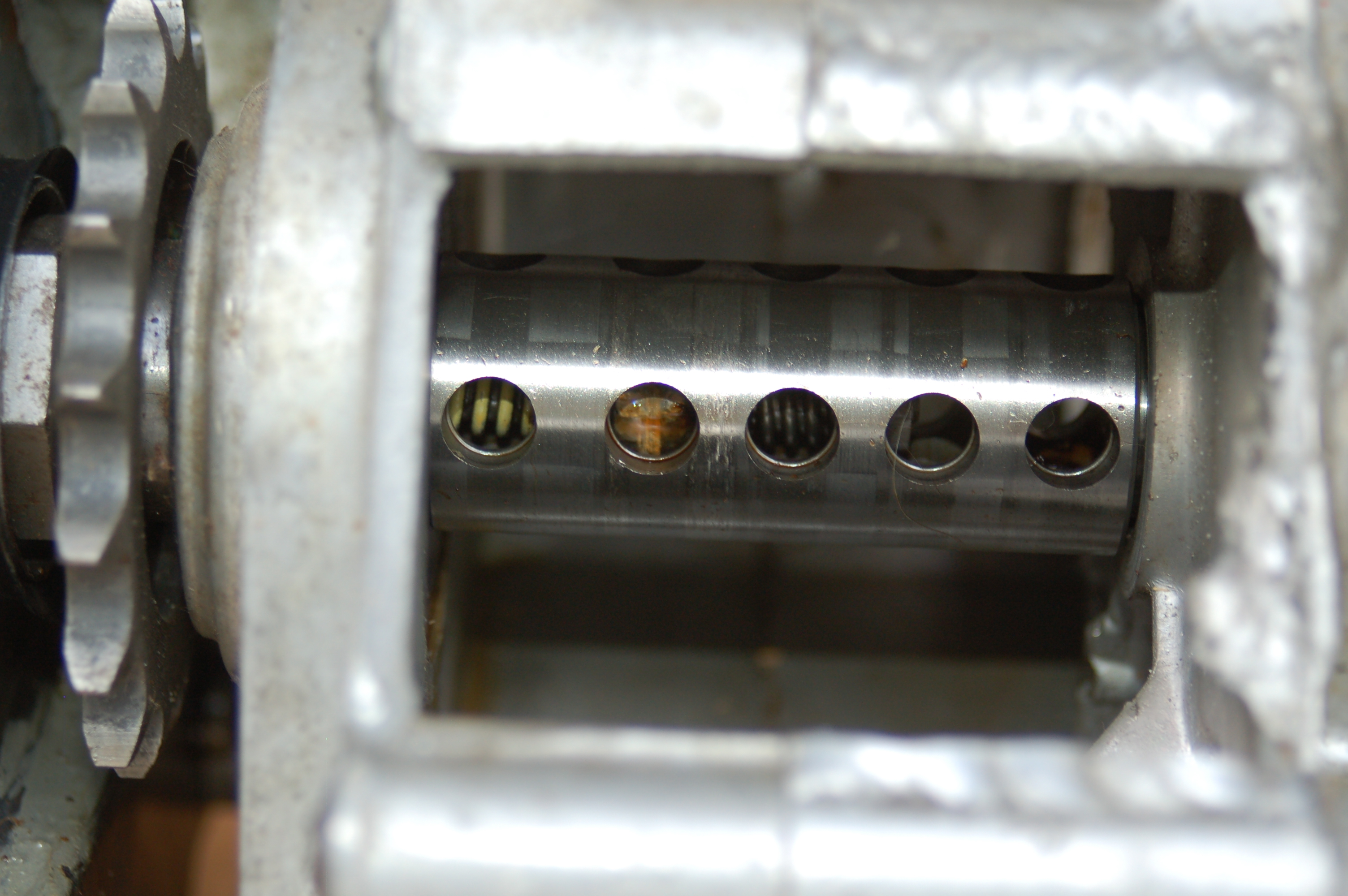

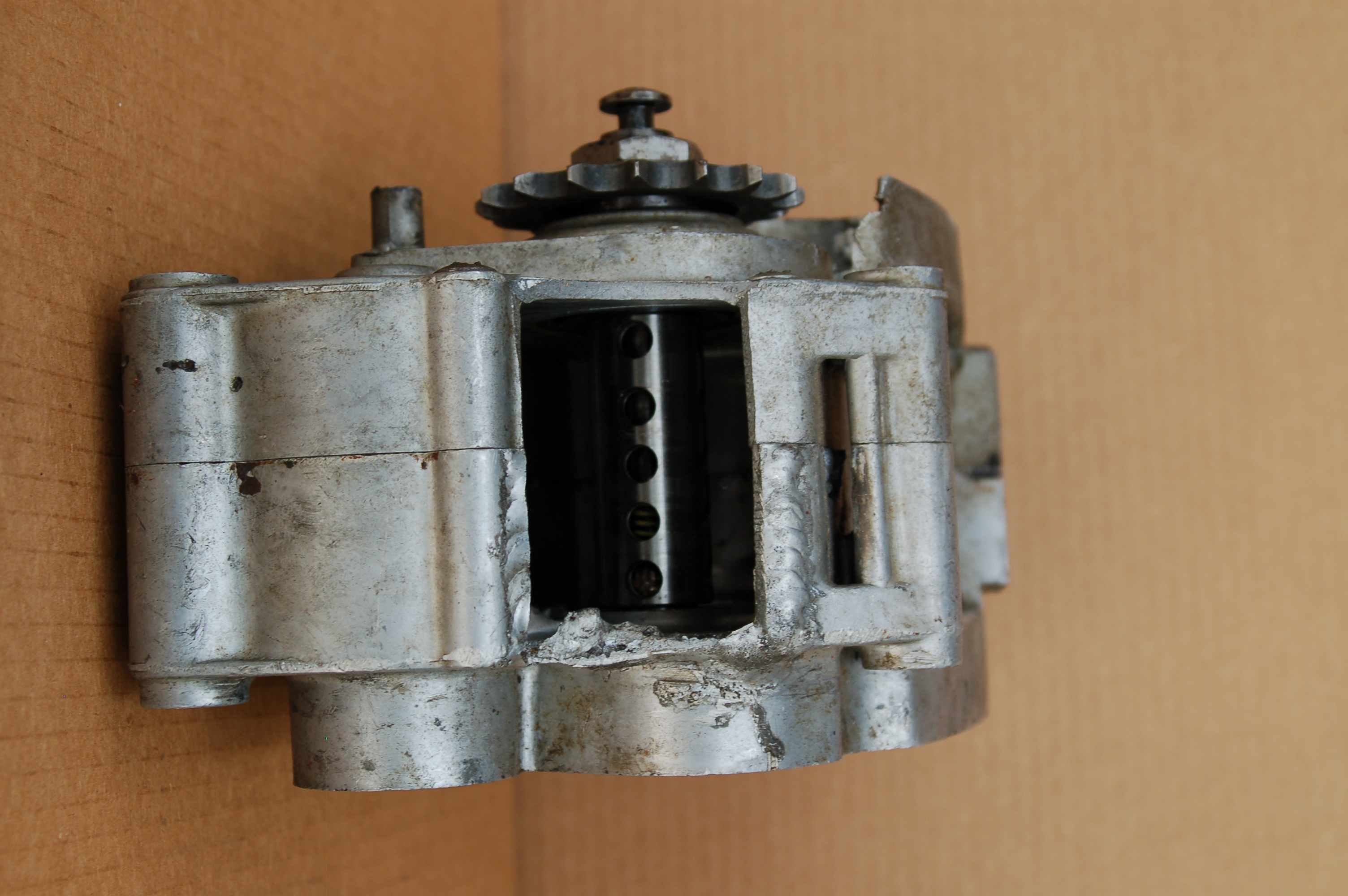

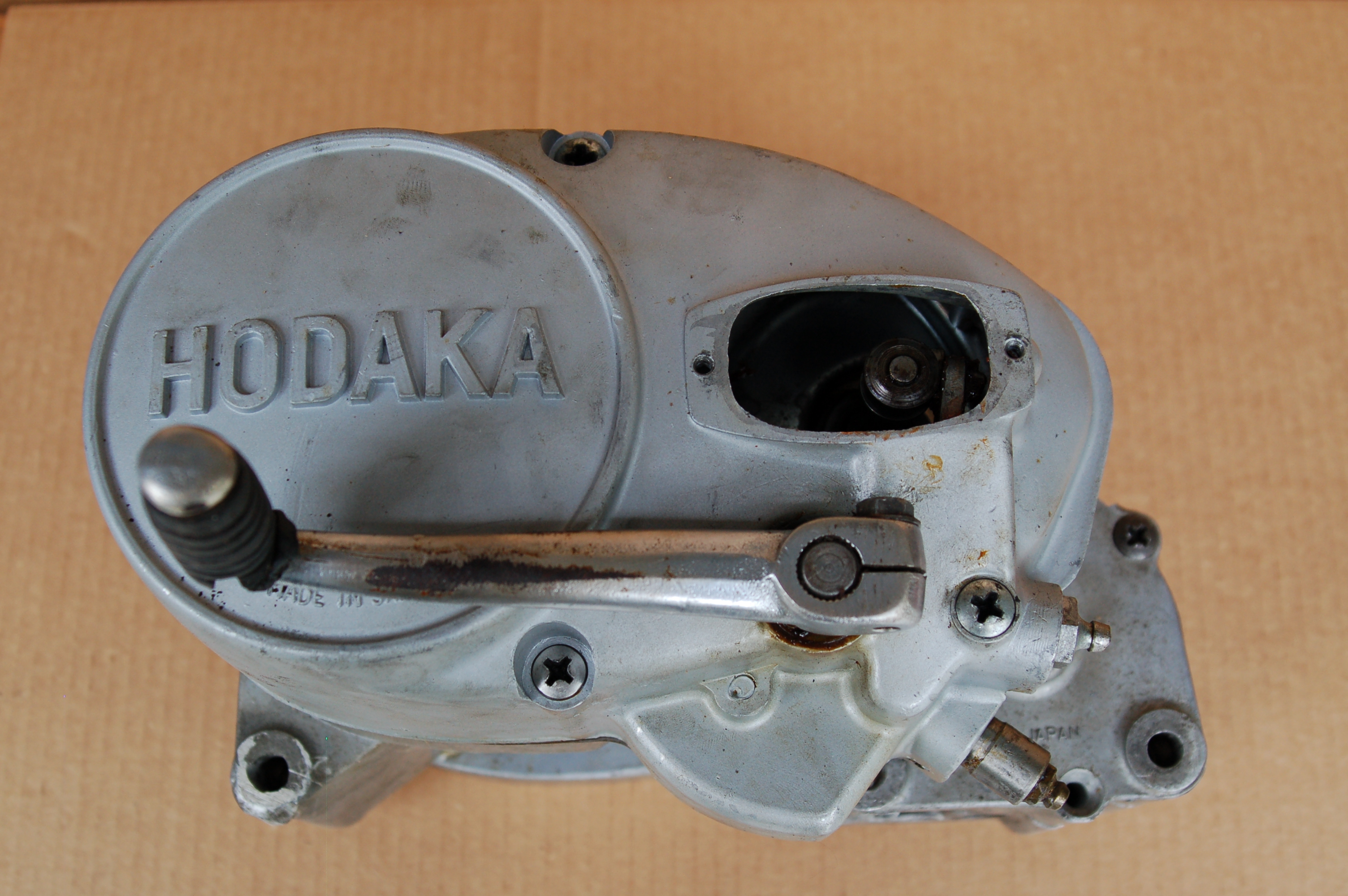

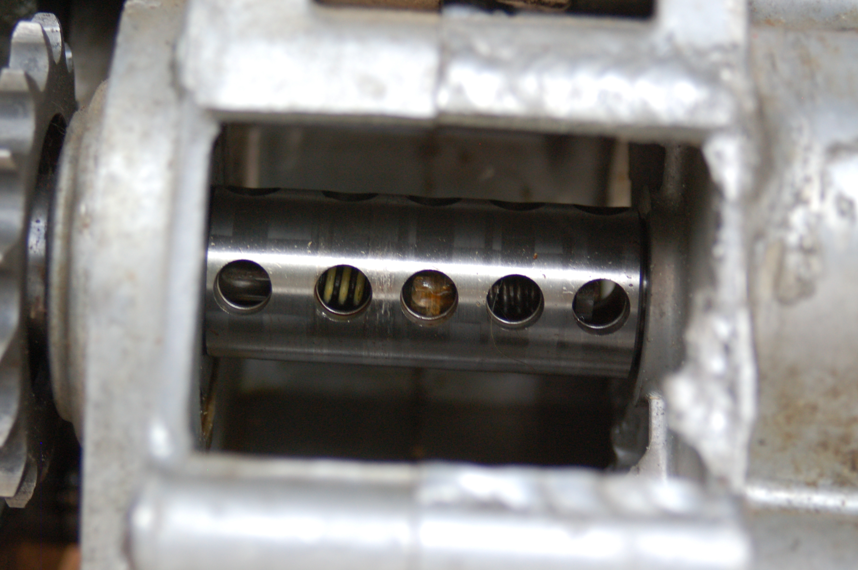

Here are some photos of the shifter case adjustment tester I use. It is made using old, damaged parts. Basically, it is just a set of damaged cases that a worn countershaft (with the shifter springs and ball receiver installed) is mounted into. A large window is cut into the cases so you can see the ball receiver as it moves from position to position in the countershaft, as you shift with your attached shifter cover. You can then adjust the case to get everything lining up properly.

I’ve gotten used to sighting in where the end of the shifter pin sits in proximity to the edge of the inspection window. I inspected several of my functional cases and got a pretty good idea where that is.
Now, I just check the location of the pin on each shifter and visually set it where my eyesight says is where it should be. Works every time for me!
