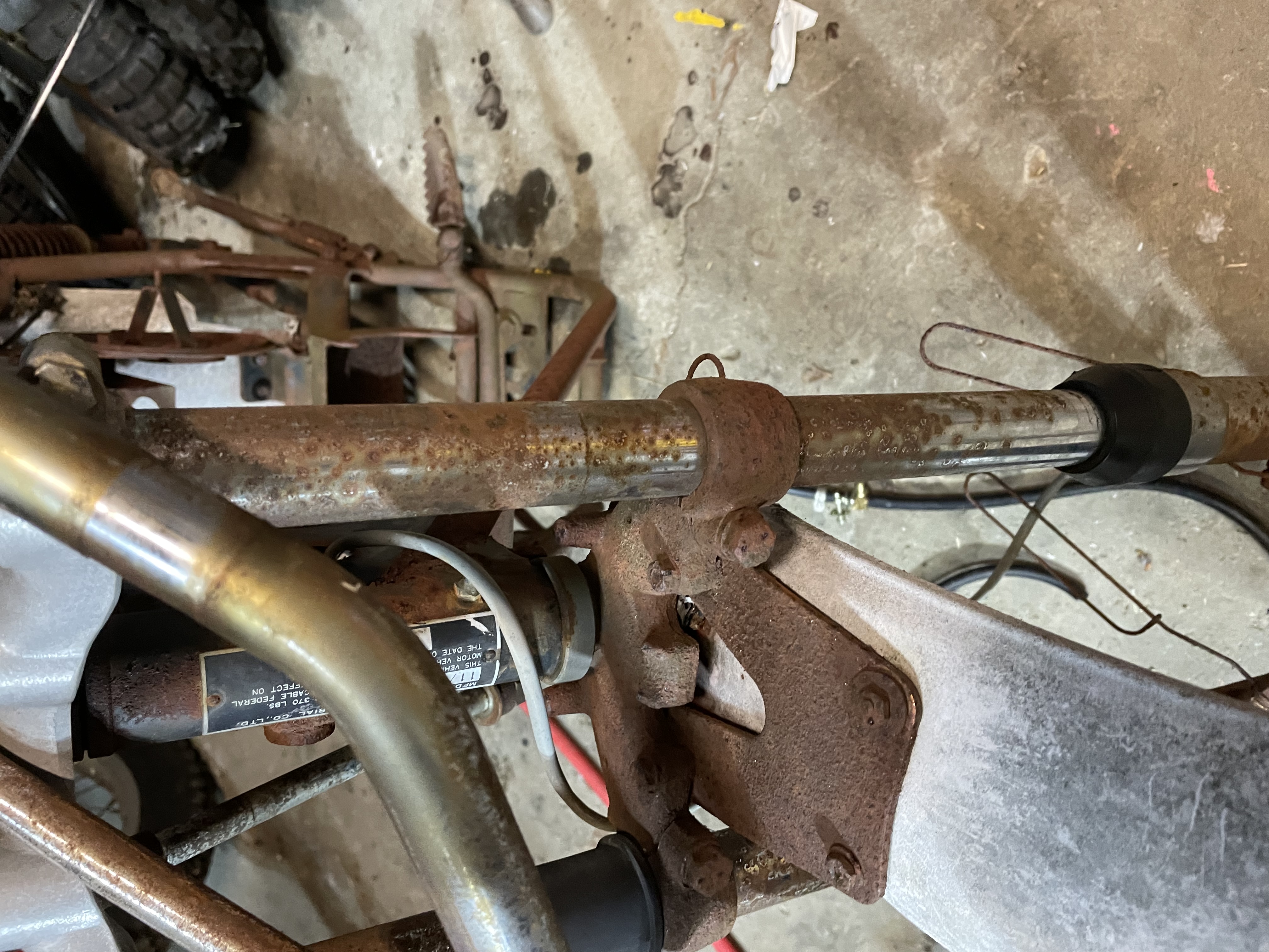

Good Evening
Was able to pick this up this evening
Thoughts on what kind of mess I just got myself into or is this worth getting back into shape ?
1972 Wombat Frame
Have both wheels that came with it

Re: Where to start

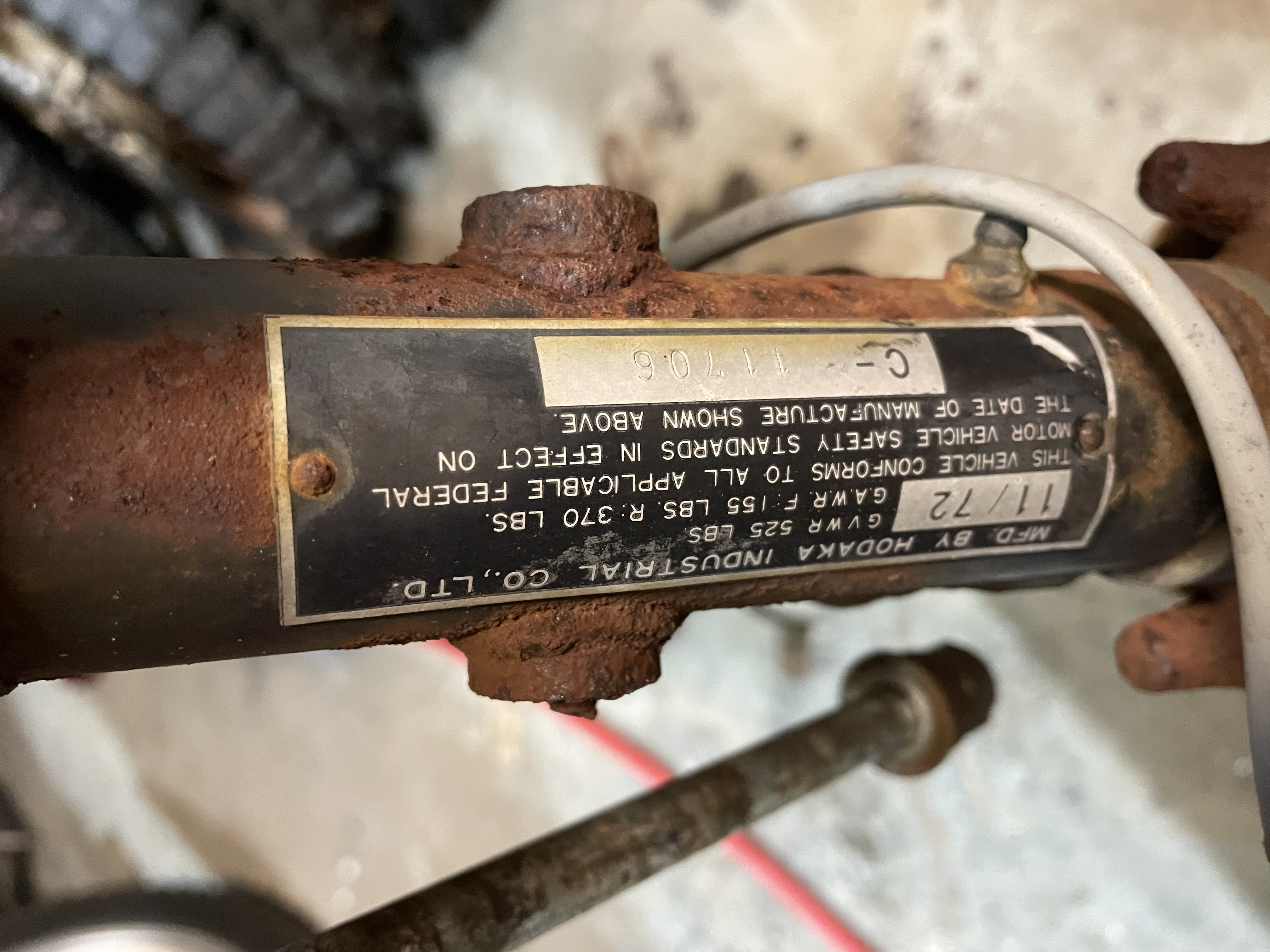

It all starts with a “First step!” If it were me, I’d drill the rivets on the VIN plate & remove. Complete disassembly and then have things sandblasted.
Is there a motor? Pipe? Different tank? What do you have -vs- what do you need?

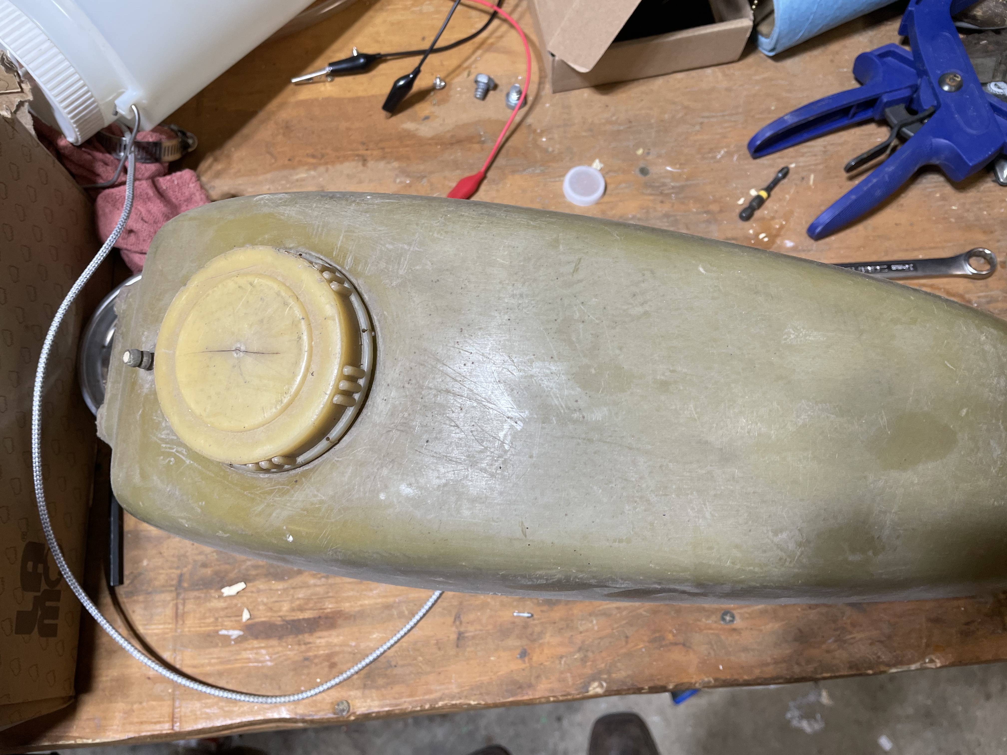

Pretty much just have the frame wheels and gas tank pictured
Is the tank worth putting back on or is it pretty much toast ?

Re: Where to start
Sounds like you have (most of?) a motor too. Time to perform a well-documented disassembly and clean up. Only then will you know what you have and what you'll need. Take a lot of pictures and use ziploc bags etc to keep parts organized. Don't be discouraged by a little (lot of) rust. That is SOP in Hodie-rescue land. Don't throw anything away as you go. You might be surprised at what can be salvaged in part or in whole.

Re: Where to start
Easy way to remove the VIN plate without damaging it is to push the rivets out from inside the frame neck using a right-angle hose pick. Locate the back of the rivet with the pick and wedge a screwdriver or something against the back of the pick and push out the rivet. The rivet can be reused. A set of four picks are cheap at HF, etc.
Re: Where to start
Nice tip, I use a carton knife blade slid in behind the rivit head. Like your method better.

Thanks scribbler for the tip have a set of those and didn’t cross my mind was going to use a small center punch and then drill out but not now will use your method
Scribbler wrote: ↑Sat Jan 15, 2022 2:36 pm Easy way to remove the VIN plate without damaging it is to push the rivets out from inside the frame neck using a right-angle hose pick. Locate the back of the rivet with the pick and wedge a screwdriver or something against the back of the pick and push out the rivet. The rivet can be reused. A set of four picks are cheap at HF, etc.

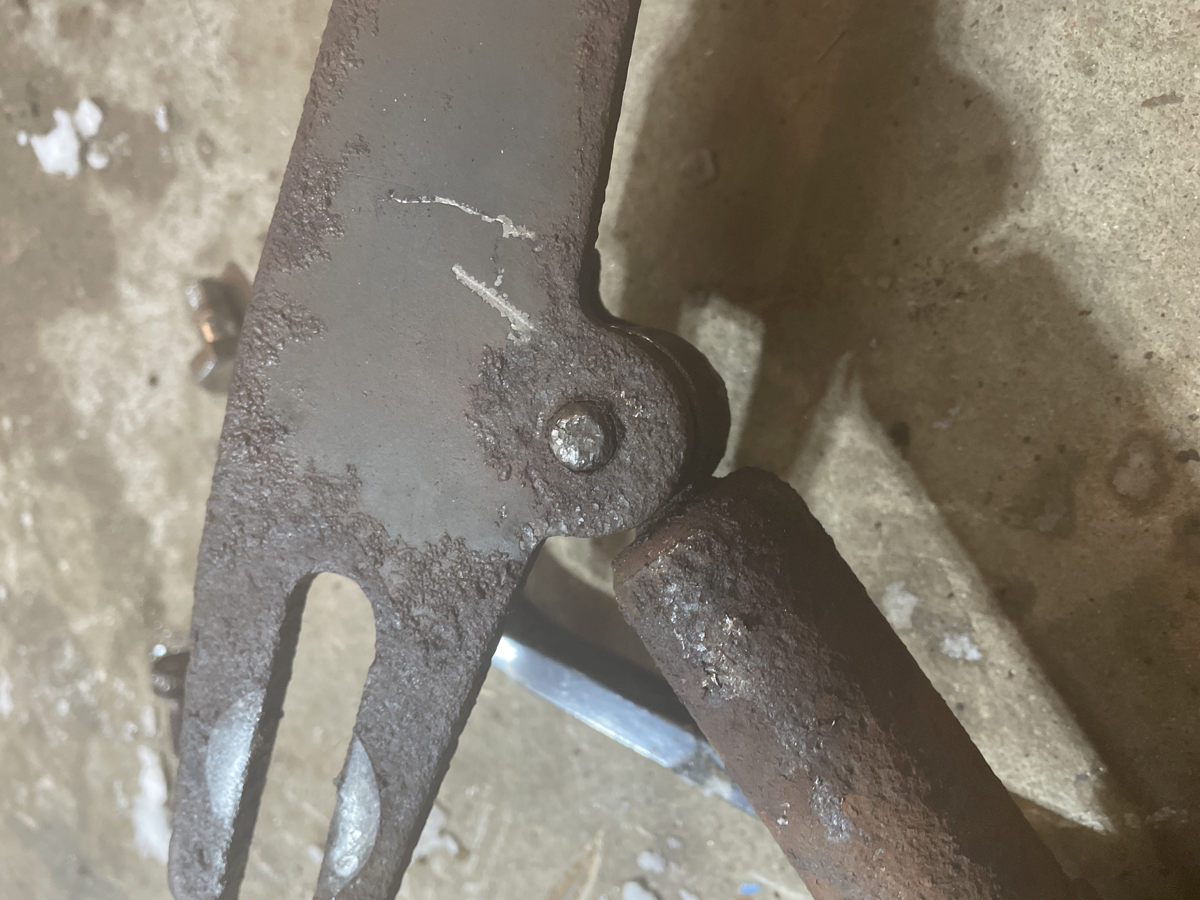

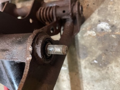

Afternoon

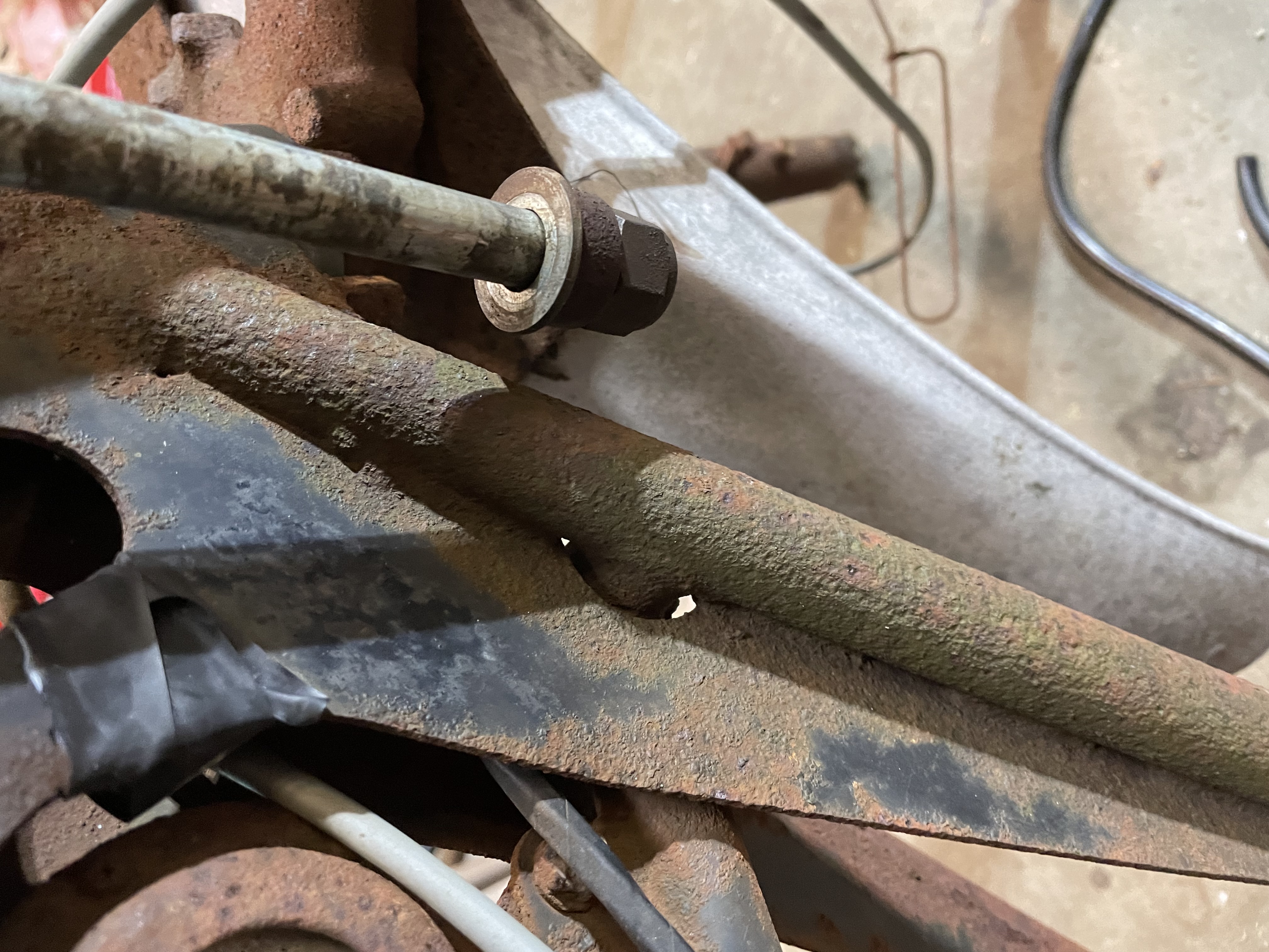

Any tips on getting the following out due to crunch frozen locked up
Swing Arm Bolt tings frozen in there
Rear shock Bolts
Rear brake pedal

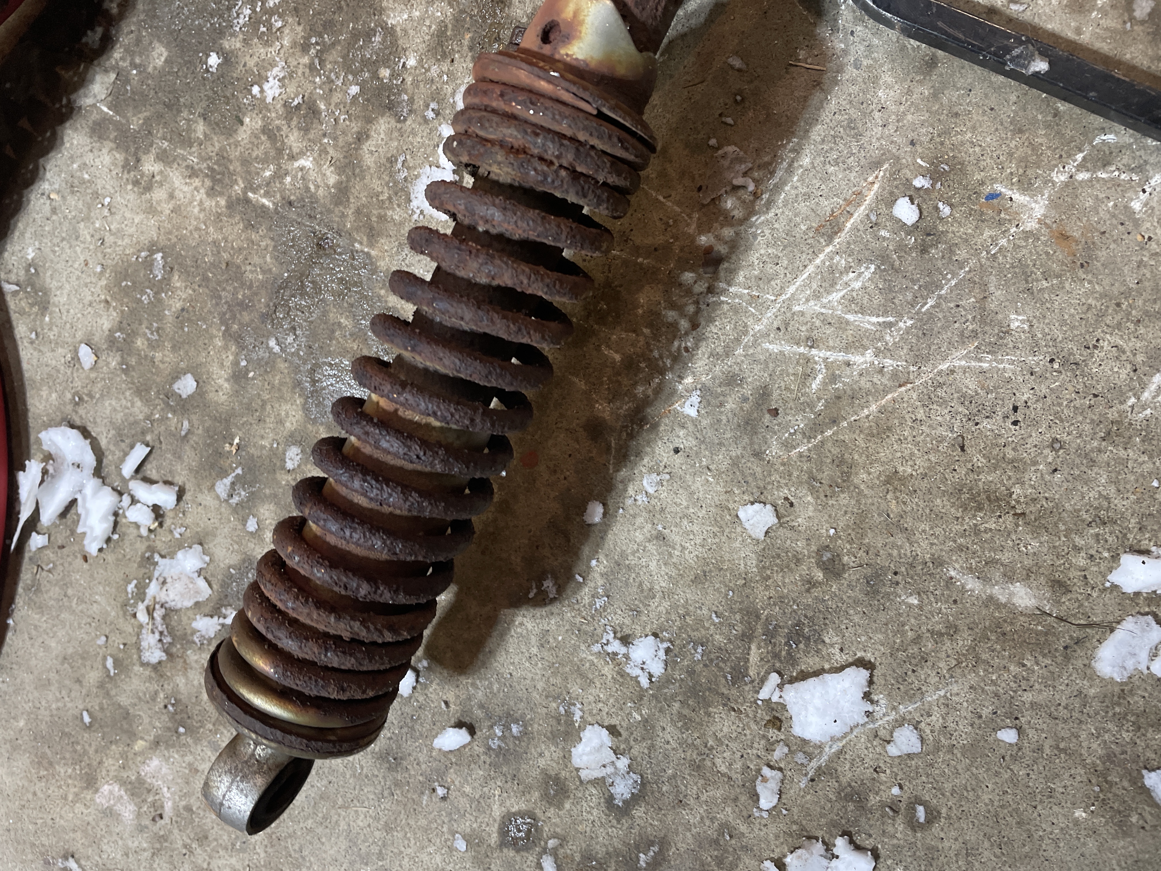

Also any tips on cleaning up the rear shocks or are they toasted?
These is all I have left and off of to get sand blasted

Re: Where to start
Shocks? Easiest option is to purchase replacements. OEM style are available from Terry at Hodaka-Parts.com. There are write-ups on dis-assembly and cleanup if that is something you wish to do.
Shock bolts? Purchase a superior quality penetrating oil. Kroil is my go to... Spray it multiple times over several days. Apply a little heat. They will come loose.
Swing arm bolt? Apply the same penetrating oil multiple times. Fashion a puller (same idea as a piston pin puller) from some PVC spacers and large washers. Then use the nut to pull it loose.

shocks, make sure you take the inside nut off first. c

I did get one off last night the bolt is actually froze to the collar on the shock . It came loose but won’t go past the collar
I have the brake pedal and swing arm soaking in PB Blaster

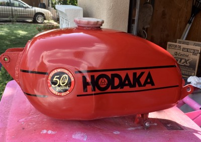

Will do this don’t know how much I appreciate the detail and the guidance you have provided
That tanks turned out really awesome
