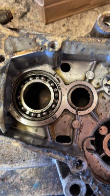

Today I disassembled most of the motor. Still waiting is the right side snap ring which holds in the main shaft bearing sand the oil pump in the clutch cove needs to be removed. The snap ring didn’t want to pop free, and, the oil pump has a stripped screw head I can’t turn to loosen. Doin enough I will defeat these last 2 obstacles! :ugeek: Victor

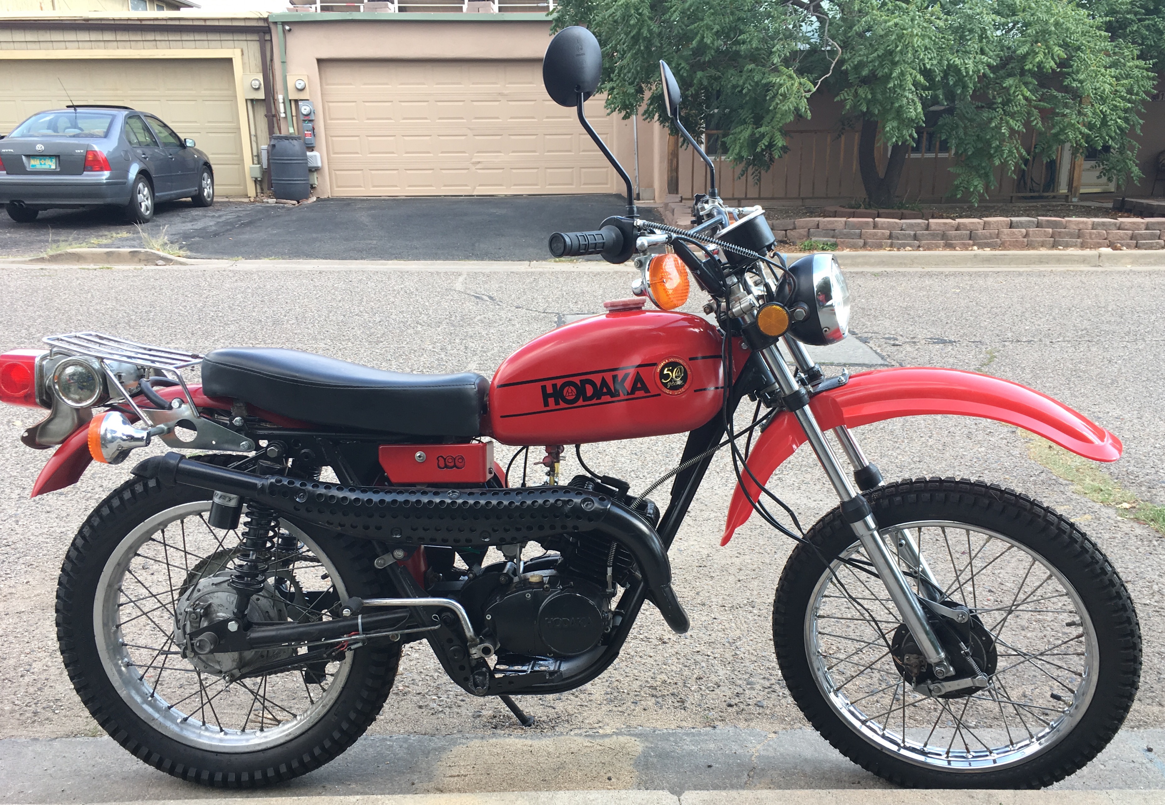

Maxie, you know as well as I do! It comes from our Hodaka additions!!! 9 bikes ago, I told myself I wouldn’t buy another. Then Paul Schwarting gave me 5 frames, 7 boxes of parts and a reeded CW motor in a box! Still building, still buying!
This one is number 16! Yes, it’s true, I haven’t bought all of them! But how can you say NO to free Hodaka stuff?

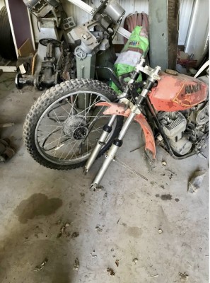

This current Model 03 Wombat cost me $300, 2 tanks of gas and a 12 hour round trip drive! The drive actually took me about 15 hours because I stopped on the way home in Grants to see Rick Buehite! This is what she looked like before I took her completely apart! :ugeek: Victor

I was able to pull the snap ring today! Yeay!!! :ugeek: Victor

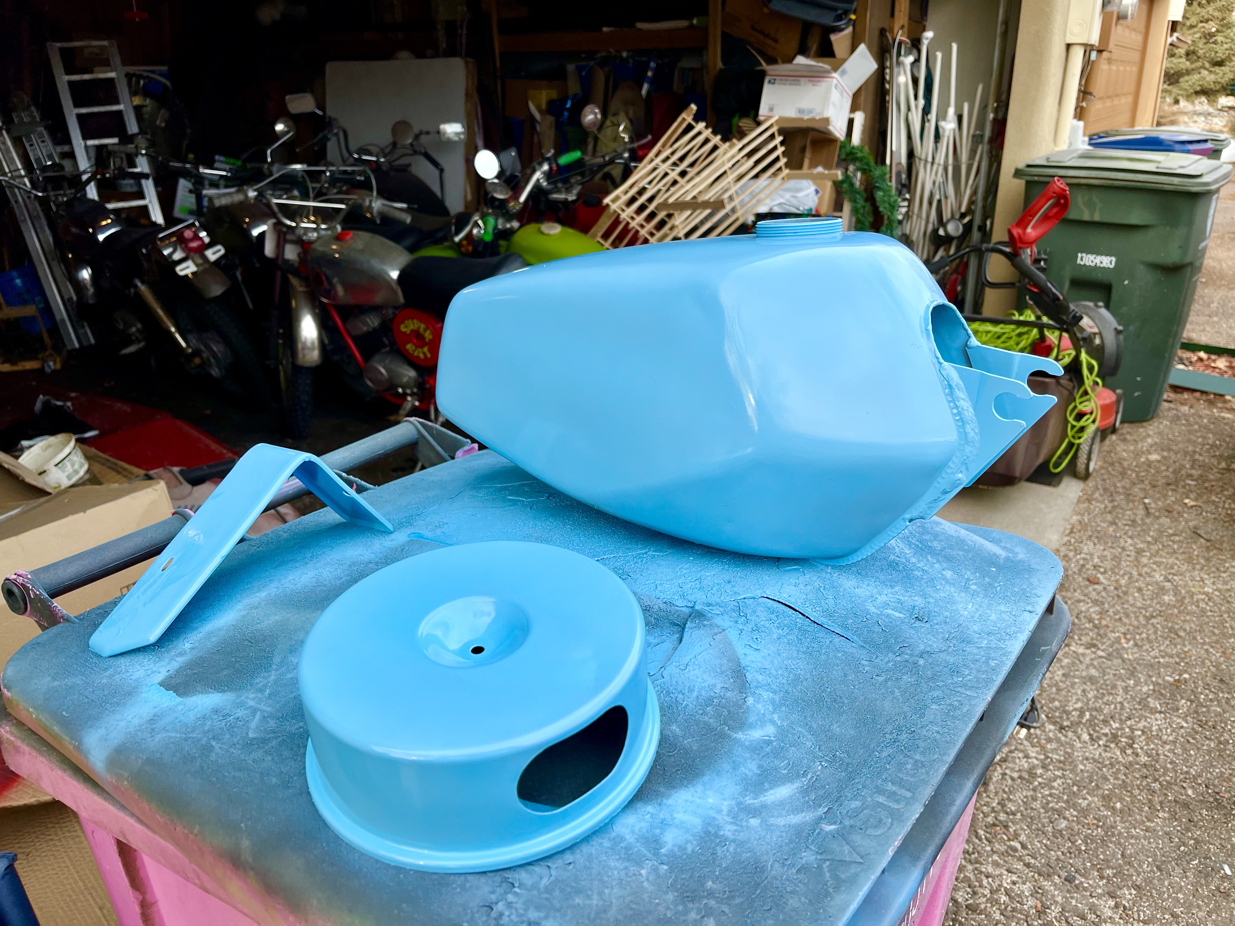

I’ve been able to sneak in to the garage from time and paint frame & frame parts. I also got the rear fender painted white. And today I put the first coat of Baby Blue on the colored pieces! Second coat tomorrow because it’s supposed to be even a few degrees warmer! :ugeek: Victor
